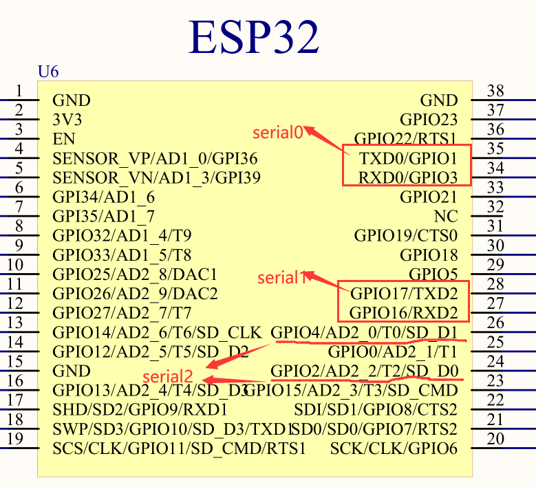

I use four esp32 module to form a small system, three of which send data to the rest one as master through the serial port. The master esp32 uses three serial ports, and after testing, it is found that almost half of the data received through the serial port on the master esp32 will be lost. The data transmission rate of three slave modules is about 1200 bytes per second.
Is it because the three serial ports of master esp32 share a buffer? What is the root cause of this problem? Is there any solutions?

Any chance we can see your code? In theory there should not be a reason why the hardware drops packets, however 1200 baud is very slow and buffers aren't infinite so there may be a reason why software drops stuff.

Do you use RS485 or directly connect the gpio of the four UARTs together?

Directly connect the gpio of the four UARTs together

I think this may be the reason. For example, when A needs to send data to D. At this time B and C are in the IDLE state( output high level). the low level of A output will be pulled by B and C, at intermediate level (perhaps 1.5V) . Can you look at the waveform with an oscilloscope ?

The serial ports used by master esp32 as shown in the attachment picture.
You mean when serial1 and serial2 are not sending data,output high level, will cause serial0 to a intermediate level,and the serial sending would be abnormal?
If all of the 3 serial ports are sending at the same time,output low level,there would be no data loss?

Yes, the serial0 want to pull the TXD line low, but serial1 and serial2 pull the TXD line high. So the TXD line will be in intermediate level (I have checked the level is 1.7V).

I'm not sure if I understand correctly.
Are the 3 serial ports share one txd and rxd bus line? And this is the cause of data loss.
For my scenario, the master esp32 module will receive a lot of data from 3 slave esp32 module and send little data.Even if rxd is in intermediate level,it will not cause all data loss?
Is there any way to solve this problem?
