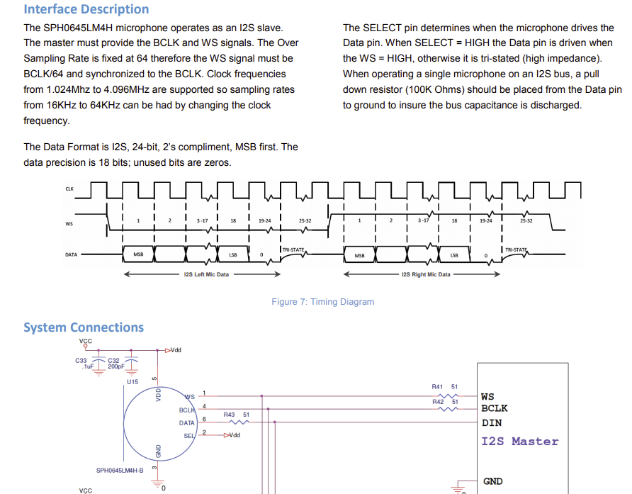

I am trying to get i2s working with a SPH0645LM4H-B digital microphone and am not having much luck.
The data sheet can be found here: https://media.digikey.com/pdf/Data%20Sh ... LM4H-B.pdf

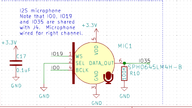

I have a 100K pull-down resistor as is suggested by the data sheet. I do not have any inline resistors since the traces are quite short (and I do not have room on the PCB). When I look at the signals on my oscilloscope they look quite clean without any ringing. While my schematic may not show it in the snapshot below, there is plenty of filtering on the microphone and nothing else is connected to those pins (except for IO0 which also has the reset circuit hooked up to it). The signal on IO0 looks clean though.
The microphone outputs a 24-bit output (MSB first). I have it wired as the right channel with IO0 set for the bclk, IO19 for the word select (WS) and IO35 for the data in. I do not get any data unless I configure it for 32-bits per sample. Note that this device expects 32 clock pulses per sample. If I configure bits_per_sample to 24 or less all I get are zeroes (i.e. I2S_BITS_PER_SAMPLE_24BIT).
I have tried several sampling frequencies but the 32-bit data does not appear to show any pattern when I use a fixed frequency audio source.
I have also tried multiple sampling frequencies, i.e. 16KHz, 44100 and 48000 but the data still appears to be garbage (but I also only see
It looks like I am getting 17 bits of data but I do not see any of the expected pattern. It seems that no matter what I do I just see garbage data.

I think it may be working but it looks like with the Knowles microphone I need to add a high-pass filter to filter out DC.
aaronw
Posts: 14
Joined: Fri Apr 17, 2020 4:33 am
Re: I2S not working properly with Wrover32
Postby aaronw » Sat Apr 18, 2020 7:16 am
After adding a DC blocking filter it is working. It sounds like the microphone I am using goes down to DC or at least has some DC offset that needs to be removed.
