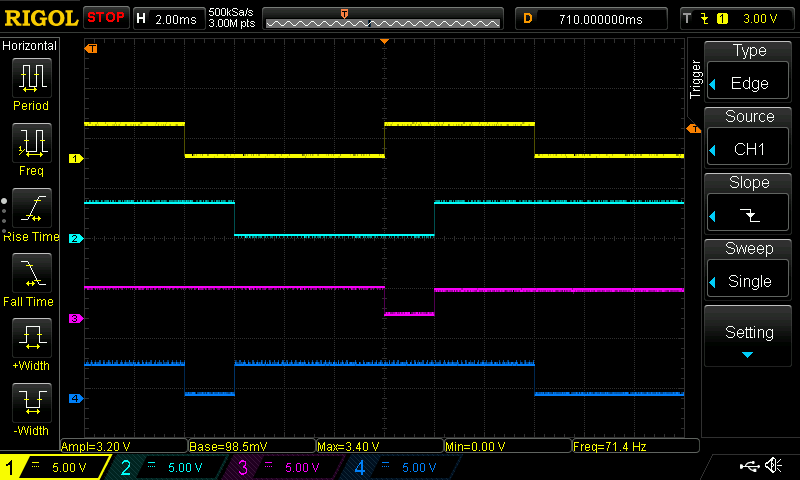

Here are screens from my oscilloscope:
DTR - yellow
RTS - cyan
EN - pink
IO0 - blue
It seems EN is pulled low two times during power-up sequence of FT231X.
Would it help to slow down ramp-up of RTS using capacitor?
DTR - yellow
RTS - cyan
EN - pink
IO0 - blue

Thanks for the scope traces, that is very illustrative.
If you have the power budget, you might consider switching the FT231X VCC to be powered from the same 3.3V source as the ESP32 instead of USB. This way the FT231X should start up at the same time the ESP32 starts up, and it might go into some low power state where DTR# and RTS# are held high (I think, I haven't checked the datasheet for this chip). Then if you're lucky it will not toggle DTR# or RTS# when the USB host connects (this is also based on the assumption all of the unwanted signal transitions are due to startup and not due to the USB host or driver).
It's also possible there's a USB to serial chip where the power-on sequence isn't like this. If DTR & RTS transition low->high at the same time during startup then the auto-reset circuit approach will work and the device shouldn't reset. It just seems this is not happening with the FT231X.
Otherwise if the USB cable is only for firmware update then you can possibly design some other custom circuitry to replace the auto-reset circuit, so EN & GPIO0 are triggered based on a combination of RTS#, DTR#, and the time that USB VCC has been high. (Note that the auto-reset logic in the circuit only exists to accommodate "default" serial pin configurations, if your customers are only doing esptool flashing then this can possibly be removed.)
Maybe but I think probably not, the auto-reset circuit is still going to generate a hard falling edge on the EN pin for the ~2.5ms period where RTS# is pulled low and DTR# is still high, so you'd need to slow the DTR# rising edge. It's unclear if the host computer is initializing this sequence, or if it's something in the FTDI chip startup itself (suspect the latter), but it's hard to avoid.Would it help to slow down ramp-up of RTS using capacitor?

Re: auto-reset circuit vs continuously running application
Hi Angus,
I tried to slow down rising edge of DTR# but it only generated more resets. So I focused on slowing down EN signal directly:
- 1uF capacitance connected to EN line
- EN pull-up switched from 10k to 50k (2x100k in parallel)
- 10k resistor added between EN line and collector of transistor from auto-reset circuit which pulls down EN line - it basically forms resistor divider with EN pull-up resistor but the line still can be pulled low enough
On the scope I still see EN pulled low but probably not for long enough (not sure) because there are no more resets after USB is plugged in. I tried esptool with flash_erase command 10 times and auto-reset worked well each time. Will do more testing in the future.
Do you see any risk in this approach?
