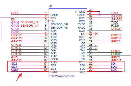

Postby skteh76 » Wed May 06, 2020 7:47 am
Is it possible to use the SPI that connected with the SPI Flash and PSRAM in ESP32-WROVER to connect to external SD card and accessing it in SPI mode?

Postby WiFive » Wed May 06, 2020 4:20 pm
Most code runs from flash so it is almost always busy. You would have to do a lot of tricks to get it working and it might have too many limitations to be useful.

Postby igrr » Thu May 07, 2020 6:32 am
Hi skteh76,
The feature to use the SPI master driver with SPI1 interface had been added very recently and will be part of IDF 4.2 release. You can try it on the master branch. There is some documentation here: https://docs.espressif.com/projects/esp ... n-spi1-bus
However we don't have an example of it being used with SD cards, yet.

Postby skteh76 » Fri May 08, 2020 8:02 am
Hello WiFive and ESP_igrr, thank for the respond.
I think I will think for another way to access the sd card instead of SPI1.
