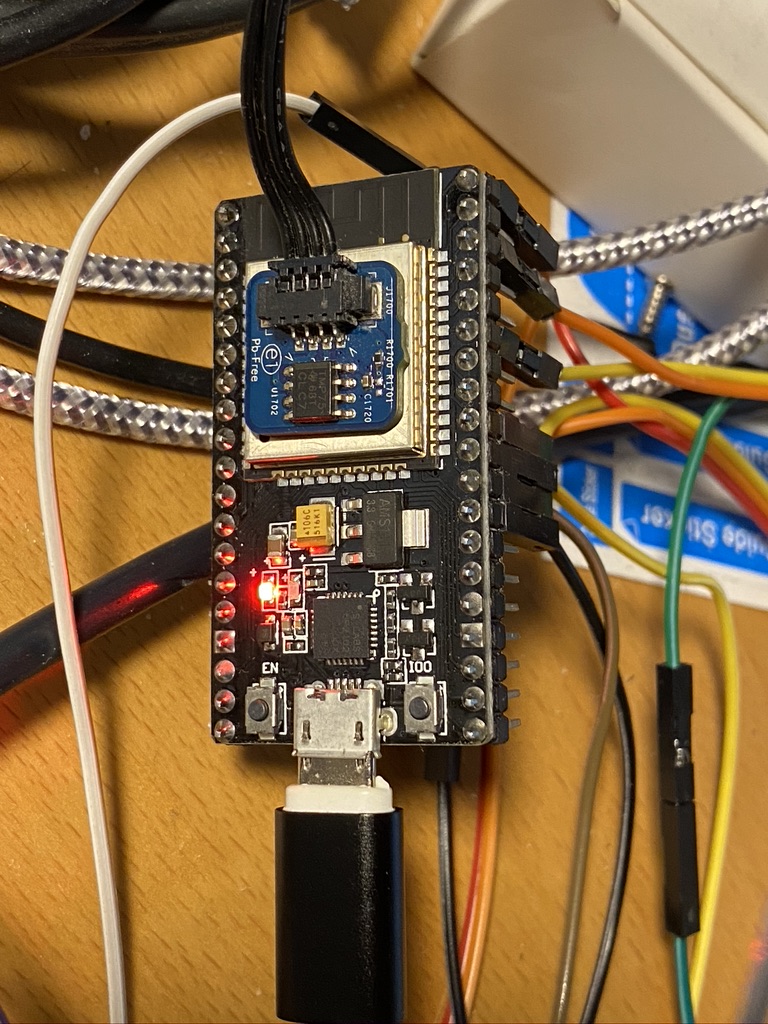

Just to let you guys know that I have managed to get one of those sensors used in older iMac to check temperature of drives, CDROM.
Temperature reading is done via i2c
Read the temperature from an LM75-derived temperature sensor, and display it
in Celcius every 250ms. Any LM75-derived temperature should work.

Generic_LM75 temperature(0x49);

  Serial.begin(115200);
  Wire.begin();
float readI2CTemperature() {
  //Serial.print("Temperature = ");
  //Serial.print(temperature.readTemperatureC());
  return temperature.readTemperatureC();
void loop() {
   Serial.println(readI2CTemperature());
