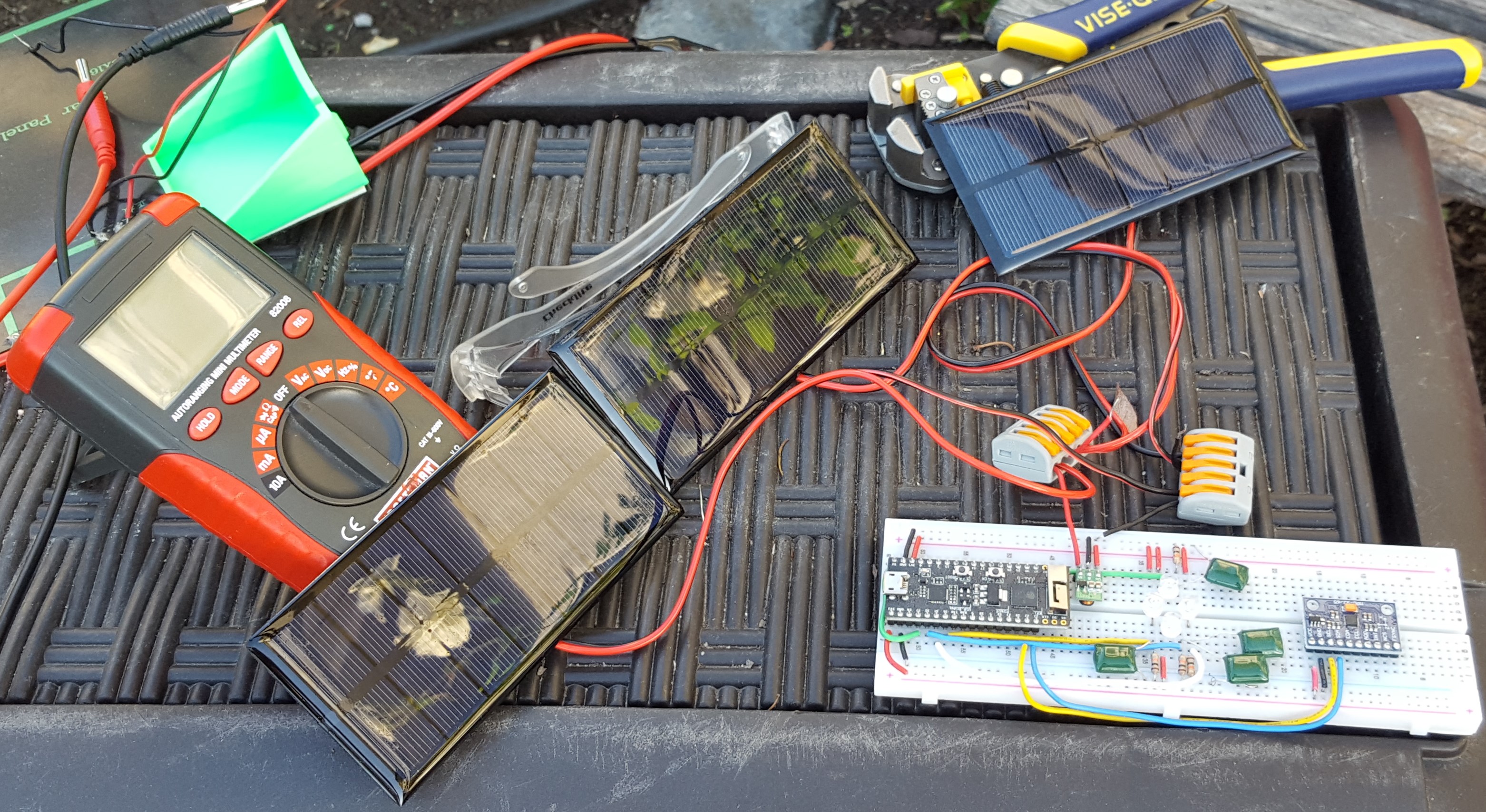

Re: ESP32-PICO-KIT using ESP-Now protocol, power consumption and usage issue with 3.5V, 250mA solar panel

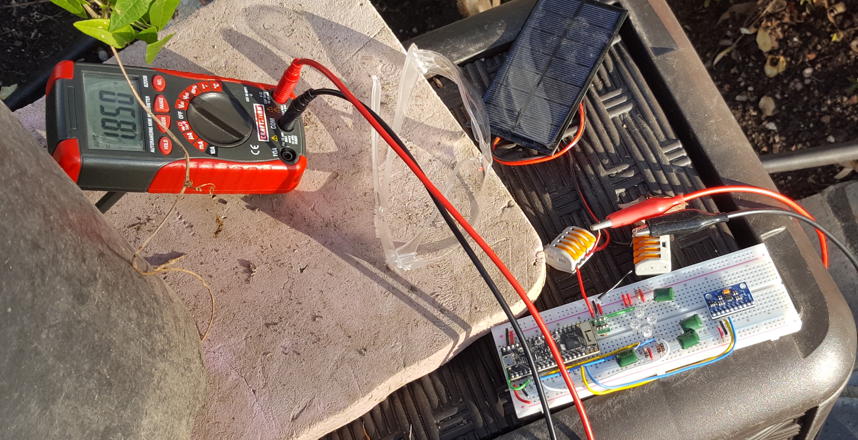

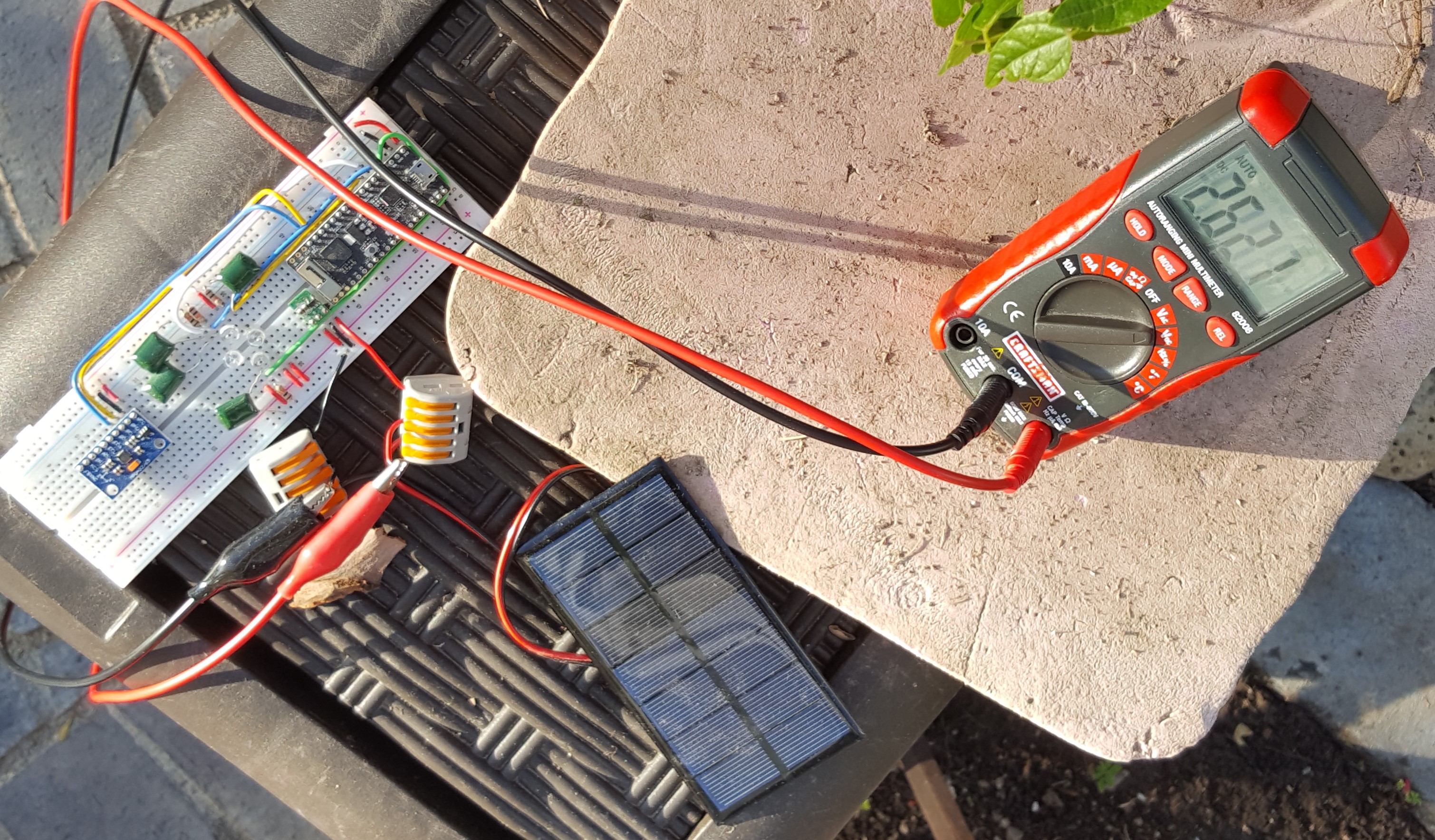

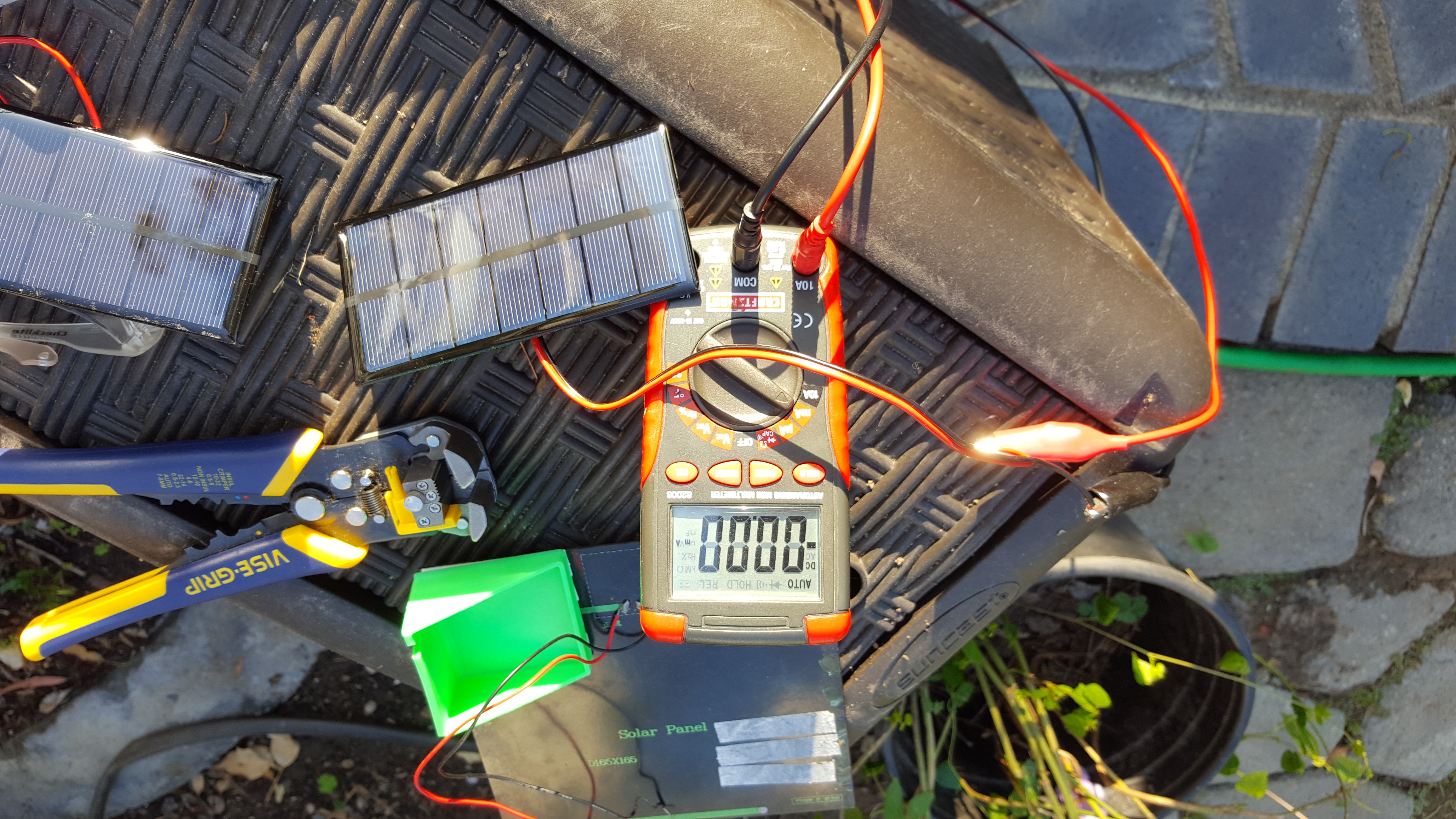

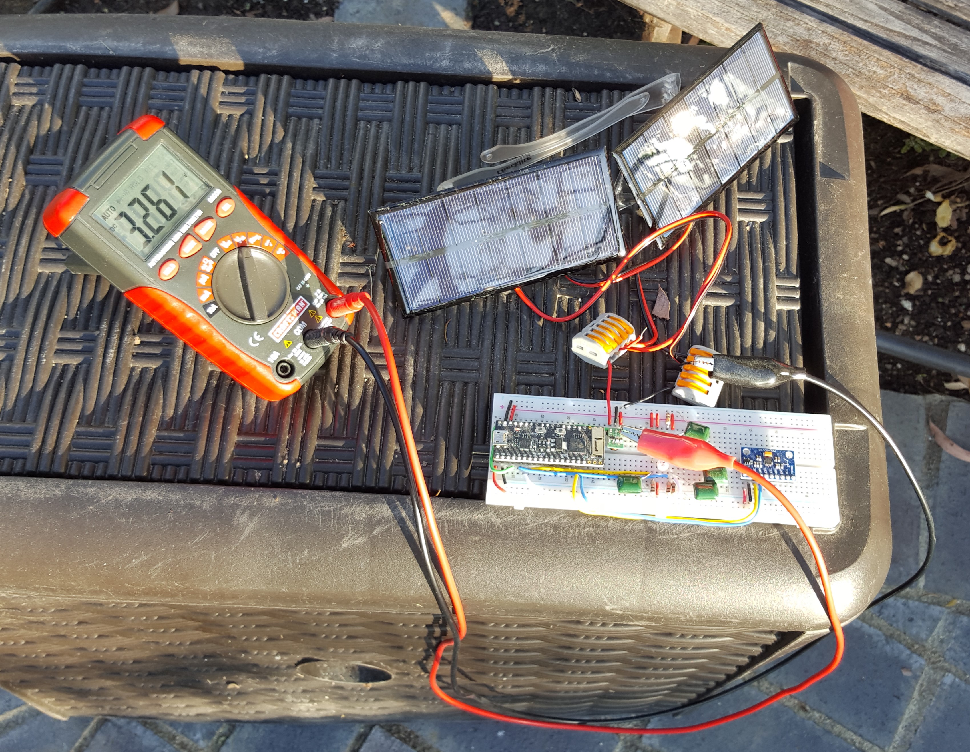

Hmm... I've attached some images of my setup.
I tried to use 2 and then 3 solar panels in parallel (3.5V, 250 mA) with good day light and still the same results.
It did not send the values. I wonder if I should have tried pressing the reset button on the transmitter side.
Was getting all 0 values on the receiver side.
I also tried measuring current inline and also open circuit current but getting 0 mA values. Am I doing something wrong?
I've measured open circuit current before with my other larger panels, but it should be able to read 250 mA easily for these panels.

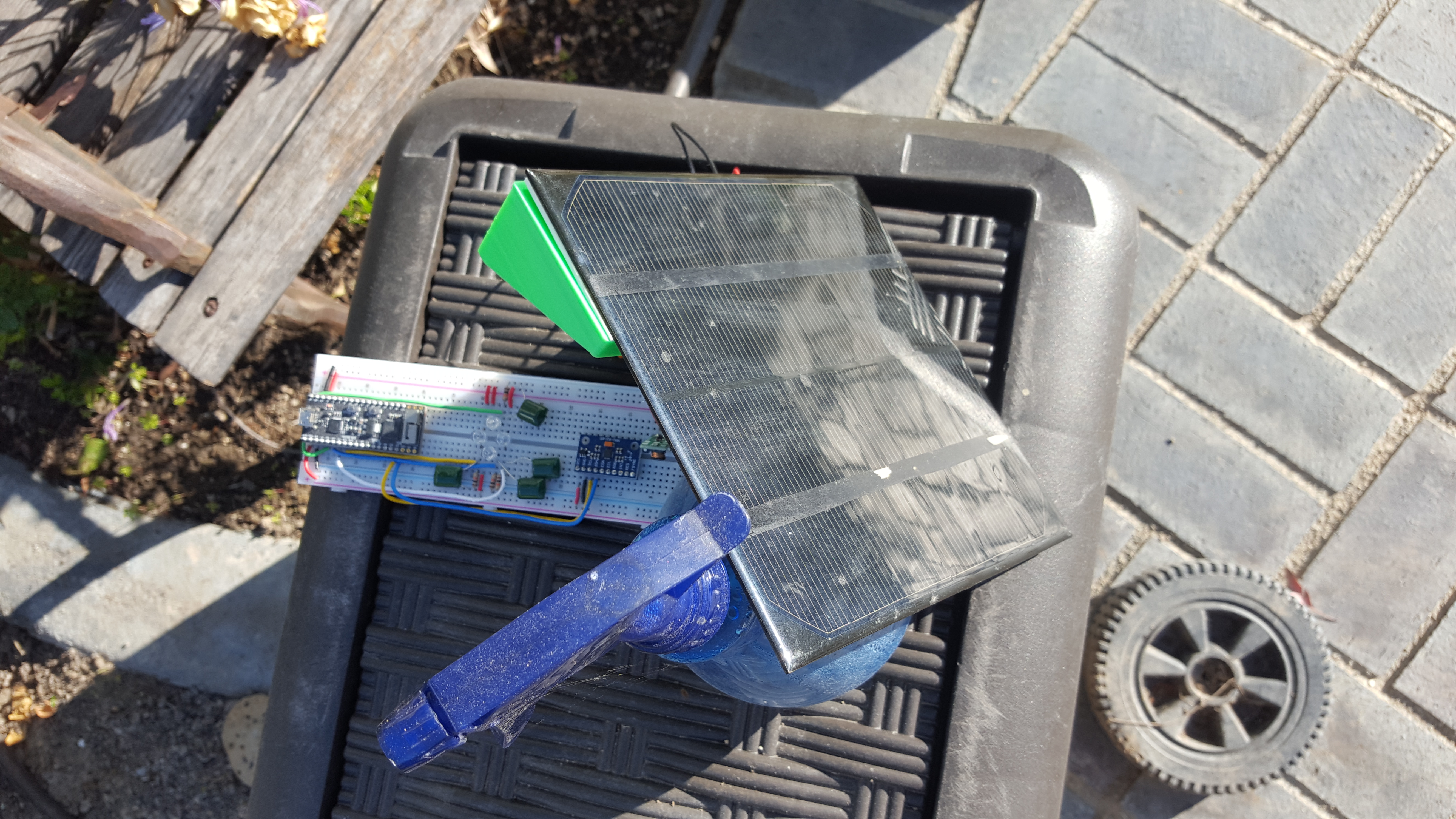

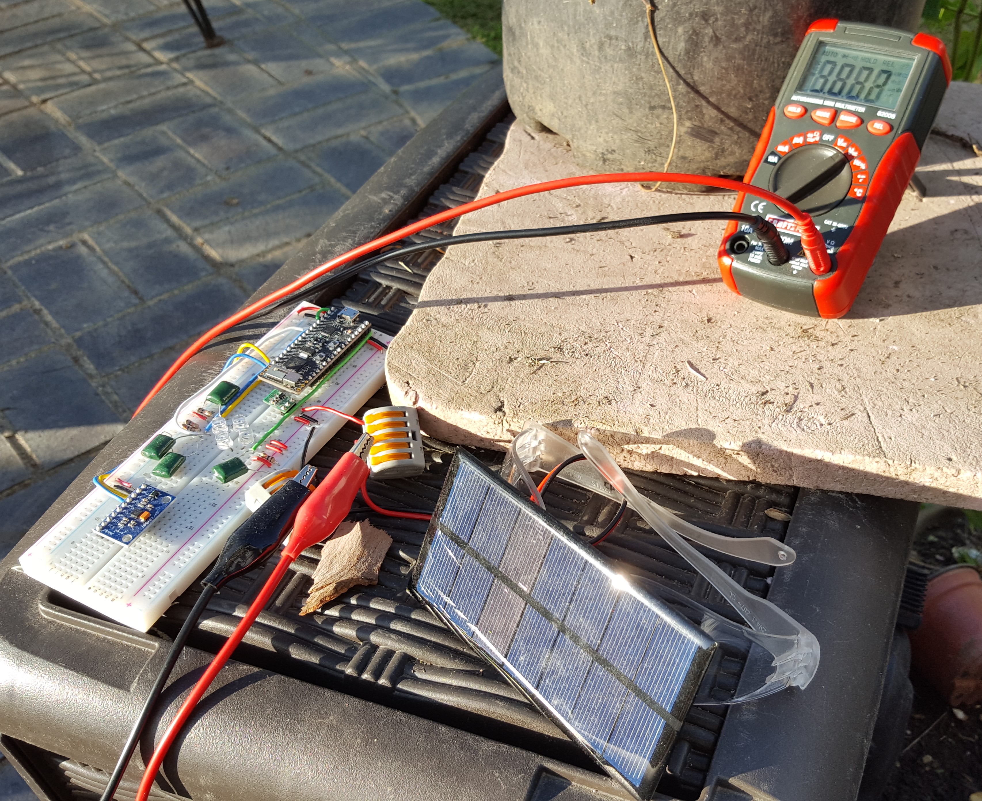

Some more images...

Well none of my 3.5V solar panels worked to power it successfully.
I used this one but the reason I like to avoid using it is it is kind of big for my application.
It has a much larger area footprint.
https://grabcad.com/library/4-5-w-solar ... x-165-mm-1
It powers the ESP32-PICO-KIT successfully.
I will see for how long I will get good results based on sun output.
I have about 1 hour left before sunset.
I am trying to look at super capacitors with
minimum Equivalent Series Resistance (ESR),
https://www.sunpower-uk.com/glossary/wh ... tance-esr/
at least 10F,
and at least 2.7 volt,
plus low cost.
I want to either find a super capacitor above 3.3V so I can step it down with a
LDO voltage regulator
I like this one since it has a it has a low quiescient current and low supply current plus it's 1 amp just like the current LDO voltage regulator on the ESP32-PICO-KIT (the current one is AMS1117 I believe).
https://www.digikey.com/product-detail/ ... ND/7228969
or step it up with a voltage booster (but I think this is more inefficient than stepping down).
This is what I remember reading but I might be wrong.
Still have to figure out best blocking diode or bypass diode to use to prevent supercapacitor for destroying solar panel.

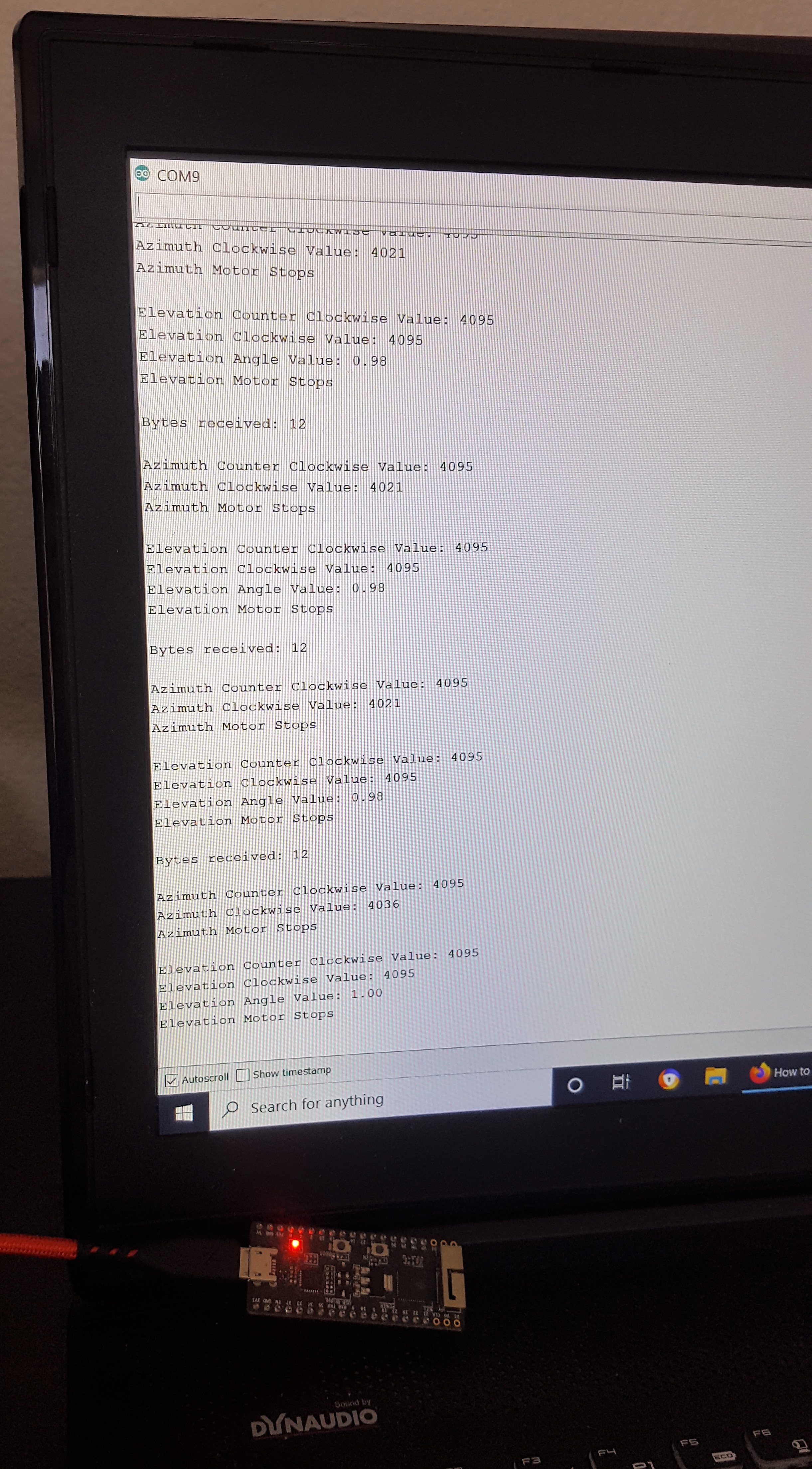

Here are working pictures and data (I am no longer getting 0s and receiving data successfully):

- ESP32-PICO-D4 receiving signals from 6v, 720mA solar powered ESP32-PICO-D4.jpg (2.22 MiB) Viewed 10486 times
- 6v, 720 mA solar panel powering ESP32-PICO-D4 successfully.jpg (3.69 MiB) Viewed 10486 times
