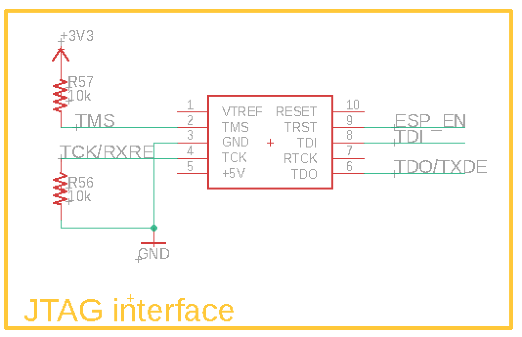

Postby jimhelios » Sun Jun 14, 2020 8:46 pm
I have a board with an ESP32-WROOM-32U and a JTAG circuit, and I have been unable to get OpenOCD to work with the board using a Segger J-link JTAG debugger. When I try, I get this:
Jims-MacBook-Pro-486:~ jim$ openocd -f interface/jlink.cfg -f board/esp32-wrover.cfg
Open On-Chip Debugger v0.10.0-esp32-20200420 (2020-04-20-16:15)

The circuit was designed based on these guidelines:
https://docs.espressif.com/projects/esp ... -jtag.html
Here is the schematic. The connector is a Segger 10 pin needle connector:
Does VTREF need to be connected to V3.3? Any comments would be appreciated thank you.

Postby jimhelios » Sun Jun 14, 2020 11:03 pm
I think I found it. This board uses the Segger 10 pin needle connector and pin 1 (VTREF) was not connected. I added a hookup wire between V3.3 and that pin and got the results I pasted below.
