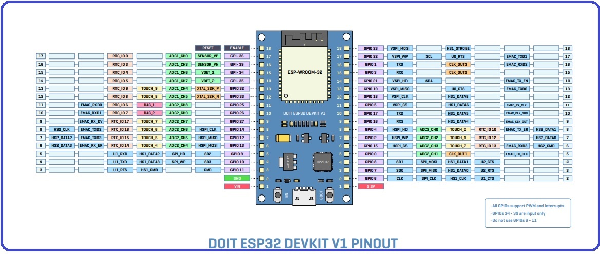

Re: esp32-wroom-32 start on battery power on without requiring boot button
Thanks for your fast reply !My issue was with the fact that I kept a capacitor attached to IO0
BUT ... I don't see a IO0 on my board ... ???
I attach a pic of my board.
- ESP32-DEVKIT-Pin-mapping.jpg (161.37 KiB) Viewed 13855 times

Paul, did you ever get a reply? I have a similar issue, not sure what I need to do to make sure that my board boots every time it gets power.

Do you happen to have any updates on this thread? I am having the same problem. Firmware boots if power is removed for a short period. A long time period requires a reset button press
