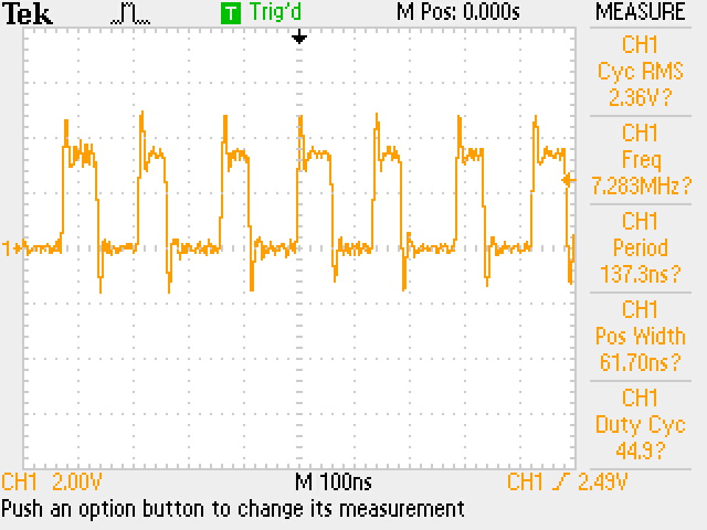

Hi Aidin,
See the captured image from my Scope Tektronix TB1062 (60 MHz / 1 Giga Samples/s).
The correct image on the pins GPIO2 and GPIO4 is below. No problem..
Arduino code:
void setup()
  gpio_config_t io_conf;
  io_conf.mode = GPIO_MODE_OUTPUT;
  io_conf.pin_bit_mask = 0b10100;
  gpio_config(&io_conf);
void loop()
  GPIO.out_w1ts = 0b10100;
  GPIO.out_w1tc = 0b10100;
Scope Image
Re: Unreliable GPIO
Posted: Mon Jun 22, 2020 10:08 am
by Aidin77
Thank you,
But it is not stable, and esp32 lose some data on its output ( it could be checked via software ,LCD or LED matrix ) and if you check the outputs, it is not stable in some cases it ( like a random noise even on Version 1 ).
