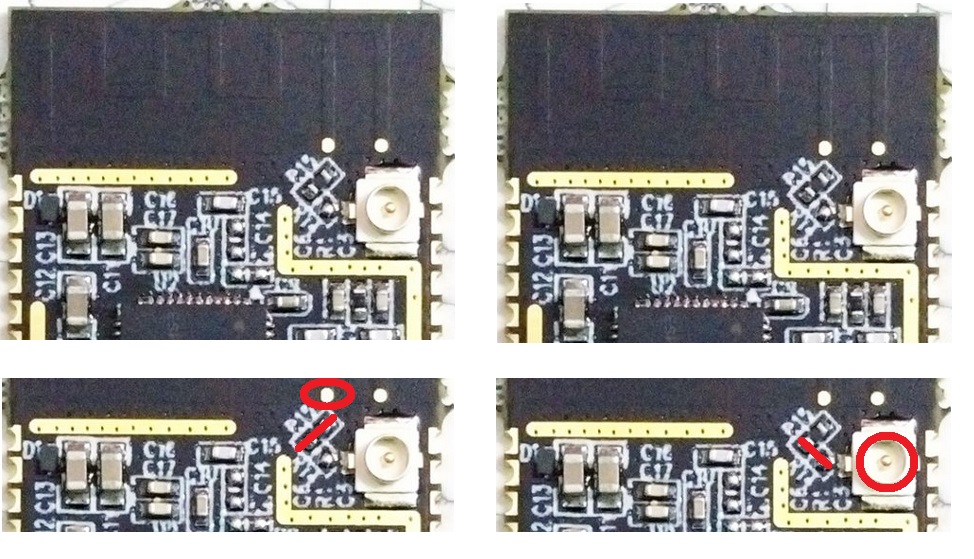

Hi
I want to know how to connect an external antenna with an ESP32-wroom-32 as we have an application of light bulb in which the ESP32 module will go inside the aluminium body of the bulb. This will decrease the range/signal strength of the WiFi and BLE.
So is it possible to solder an external on to ESP32 which can increase its range of WiFi as currently the signals are decreasing.

ESP32-WROOM-32U has a U.FL connector to support external antenna. Other new modules: ESP32-WROVER (IPEX), ESP32-WROVER-IB, also support external IPEX antenna, but more than that, they also have 8 MB PSRAM. More information can be found on Espressif website: https://www.espressif.com/en/products/hardware/modules.

If I need to solder an antenna having a braided wire part and a solid core part on ESP32-wroom-32 then where I have to solder it to enhance the range of WiFi?
As we have lock down this particular module for our application and we are into the production.
So could you provide me a solution for this particular module which is ESP32-wroom-32 in some kind of document so that we will get surety that this will never fail?
Please provide the details at the earliest.

Hi, mehul_dudeja
Please cut off the RF trace after feed point of antenna and weld the external antenna on the feed point of antenna, as is shown in the picture.
Thanks.

I have seen the photo but could you please send some clear photos or some kind of document by Espressif(official) if possible, in which I can see clearly which point needs to be solder to the feed point and which point needs to be solder to the braided wire.

Sorry for the inconvenience caused by the not-clear photo, we have drafted a clearer photo and hope this one helps.

Hi, Alvin
Thanks for sending the photo.
I need to know is it necessary to cutoff the trace/PCB antenna when connecting the external antenna?
Can we keep both the external antenna as well as the trace/PCB antenna?
Do they create some kind of problem when both of them will be working?
