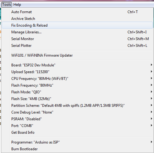

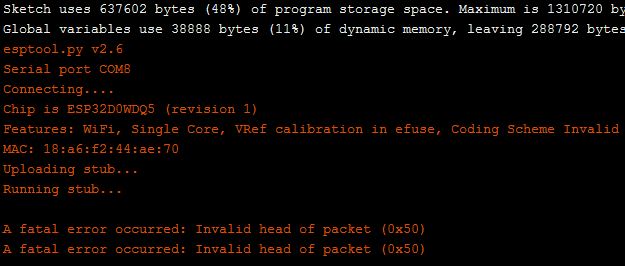

Hi All,
I have bought a Saola dev board (ESP32-S2-Saola-1MI) and I am trying to upload my first code into. I use Arduino IDE and when uploading the IDE fails to connect to the device: A fatal error occurred: Invalid head of packet (0x50) :(
Reading forums it seems everybody have resolved this issue by setting baud rate and by pressing the boot button during upload. See some here:
https://github.com/espressif/arduino-esp32/issues/485
https://github.com/espressif/arduino-esp32/issues/1253
What I've already tried:
- Baud rate setting to 115200
- Pushing the boot button before/during the connection procedure
- Another USB cable
- Another computer
- USB driver OK, COM port can be seen
- flash_download_tool_v3.8.5_1 cannot connect either
Has anybody face this? Do you have any idea what I should try?

It looks like your software is trying to program a 'classic' ESP32 instead of an ESP32-S2. Do you have the -S2 Arduino support installed?
balage
Posts: 6
Joined: Mon Jul 06, 2020 11:21 pm
Re: Error connecting ESP32-S2 in Arduino: invalid head of packet
Postby balage » Sun Aug 02, 2020 11:27 am
Thanks for your reply and sorry for my late response. I haven't got e-mail notification of your reply.
Anyway. The -S2 package was not installed, you are right. The problem was that the IDE does not support installing the package directly, I had to copy the files manually.
Thank again!
