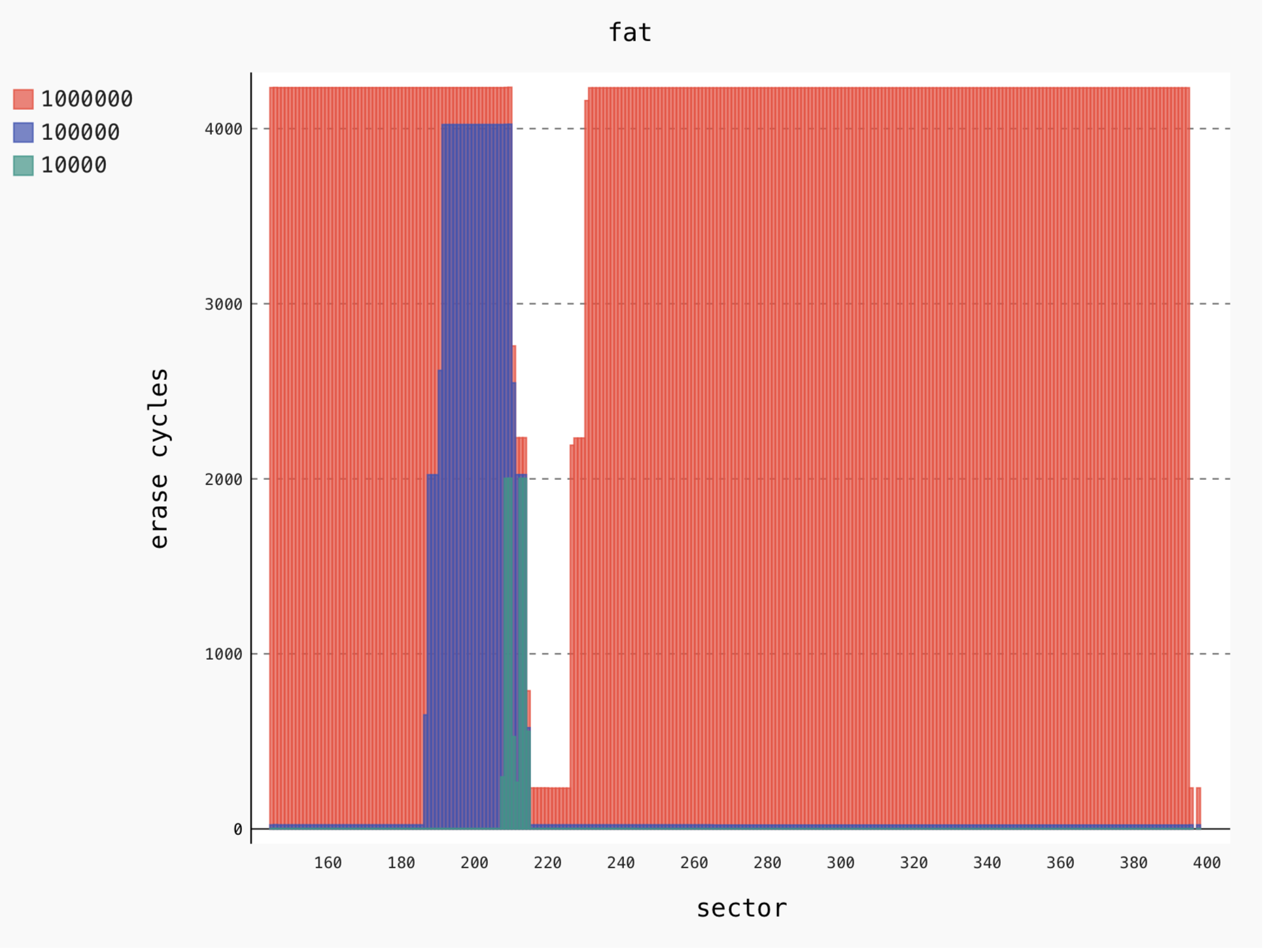

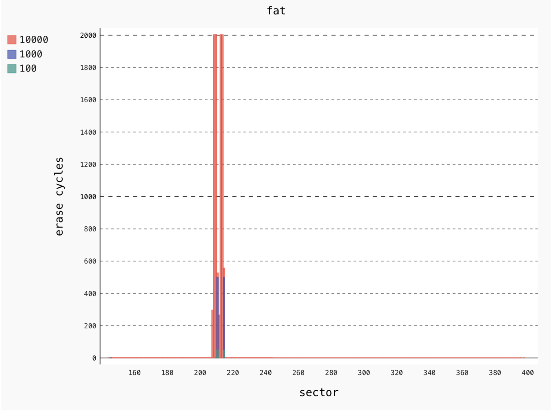

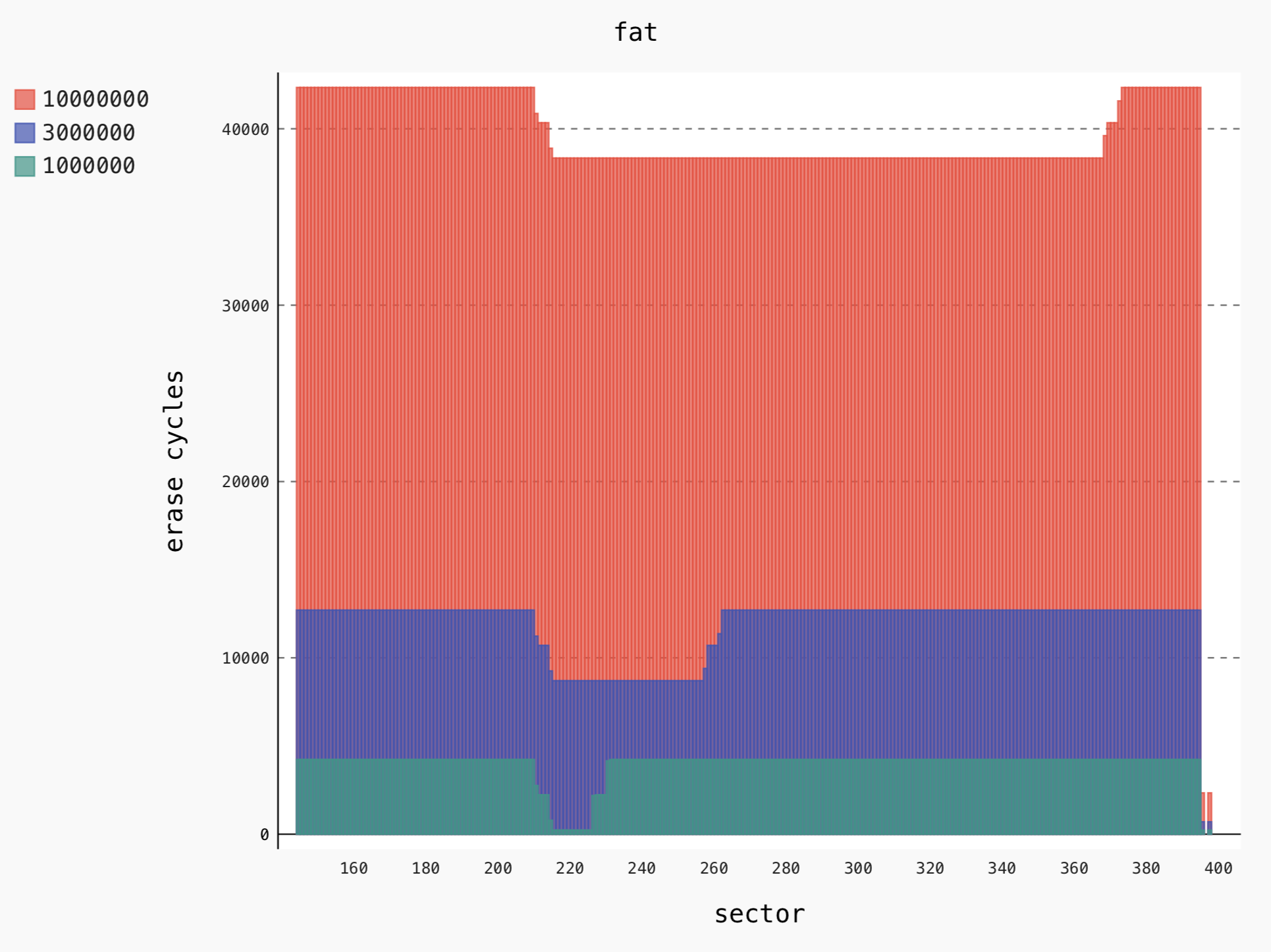

Re: wear leveling support in FATFS
Hi timredfern,
For a small number of write/erase operations with fatfs+wear_levelling you will indeed find that most operations land into the same physical sectors. As the number of operations increases, the writes will start to get distributed over adjacent sectors in Flash. I think with the default configuration used in IDF the threshold is around 2k write operations per sector.
When the total number of write operations approaches the theoretical maximum (max flash endurance of 100k cycles per sector times the number of sectors in the partition), erase cycle distributions for SPIFFS and FAT+WL will be very similar.
Note that if you are doing a small number of write operations each time the application runs, it is important to de-initialize FATFS and wear_levelling libraries before restarting.
For illustration, here are the erase cycle distributions for FAT+WL at a different total number of write operations (100, 1000, 10000, 100000, 1000000, 3000000, 10000000)
