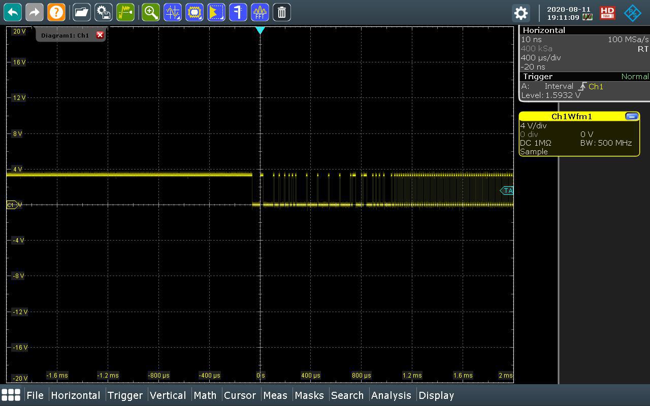

I intend to use a ESP32-U4WDH as a controller for a custom RF module. We have laid out and built the first prototype board.
I can get communication to the CP2102N, but IDF.py does not connect. I see a signal going from the CP2102N to the ESP32 RX0 at the appropriate baud rate of 115200. I see unexplained transitions on the TX0 line. I am seeing a min pulse width of 500 uSec, which translated to about 2k baud. not 9600, not 14,400 not any reasonable baud rate. Incoming is 115.2
I should get JTAG connectivity tomorrow. I took a couple of these same chips and put them on a DevKitC Board without flash on the module and it connected immediately. I am seeing about a 20 mV signal form the clock at 40 MHz,
Any suggestions as to what else to look for would be appreciated.

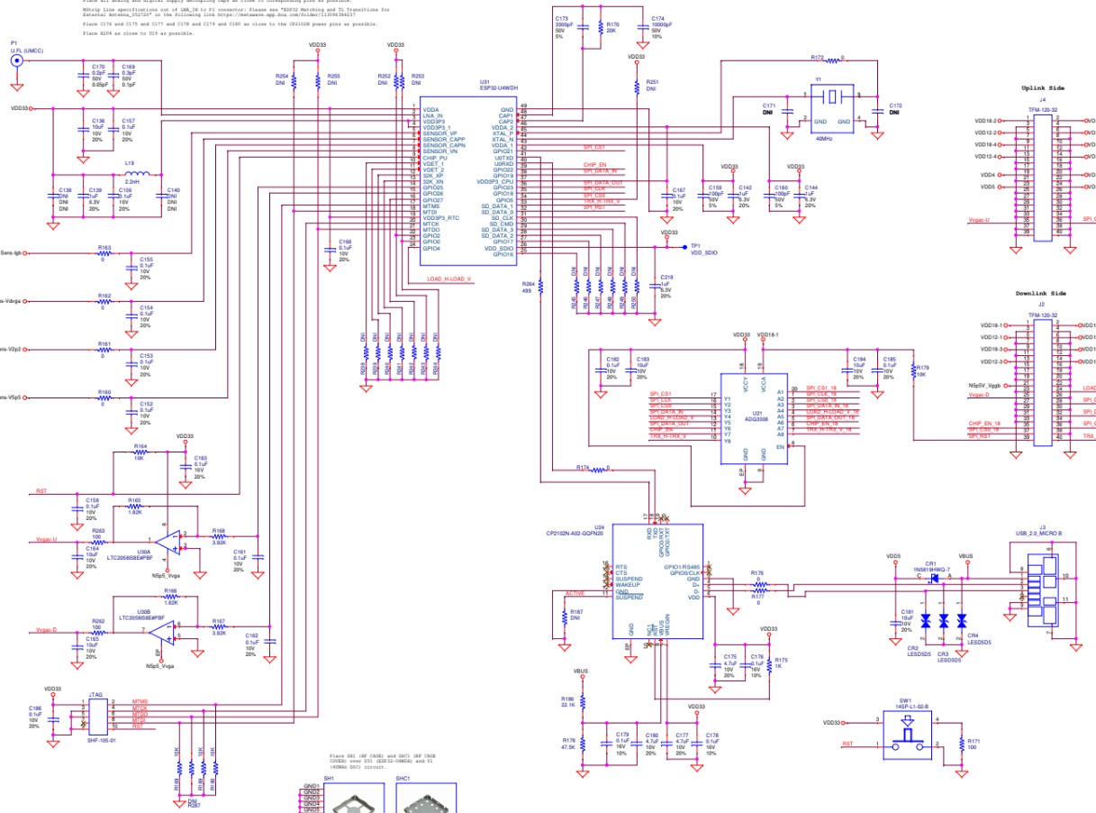

Any chance you can post a schematic? Does manually resetting the chip (by pulling EN low momentarily) solve the issue?

PS_USB Flash is a wireshark export of the first 400 messages or so out of about 8000 generated by a idf.py flash command.
I believe the ESP32 to be device 1.8.2, and the 2102 is device 1.8.0. PS_Txd_from... is a scope shot from the TXD pin on the 2102, which appears to be a good clean signal and pulse width of under 9 nSec.
I am showing a 40 MHz clock signal, at about 600 mV Please let me know if this is insufficient.

- Scope of TXD pin on 2102
- PS_TXD from 2102_115k_2020-08-11T19-11-10.jpg (127.01 KiB) Viewed 7193 times

- Schematic
- ESP32_only2 .jpg (203.86 KiB) Viewed 7193 times

Grounding GPIO0 and a reset does allow me to successfully connect by serial.
My current application, built from collecting pieces of several the examples to give me a starting point.
I am connecting to UART0 for PC communications.
Pin GPIO0 is floating, and at 3.3. Apparently we did not put the serial to reset logic on the first prototype board.
Am I correct in assuming that you reset the board every time you connect via USB Serial? The hard_reset arguments to esptool makes it look probable
