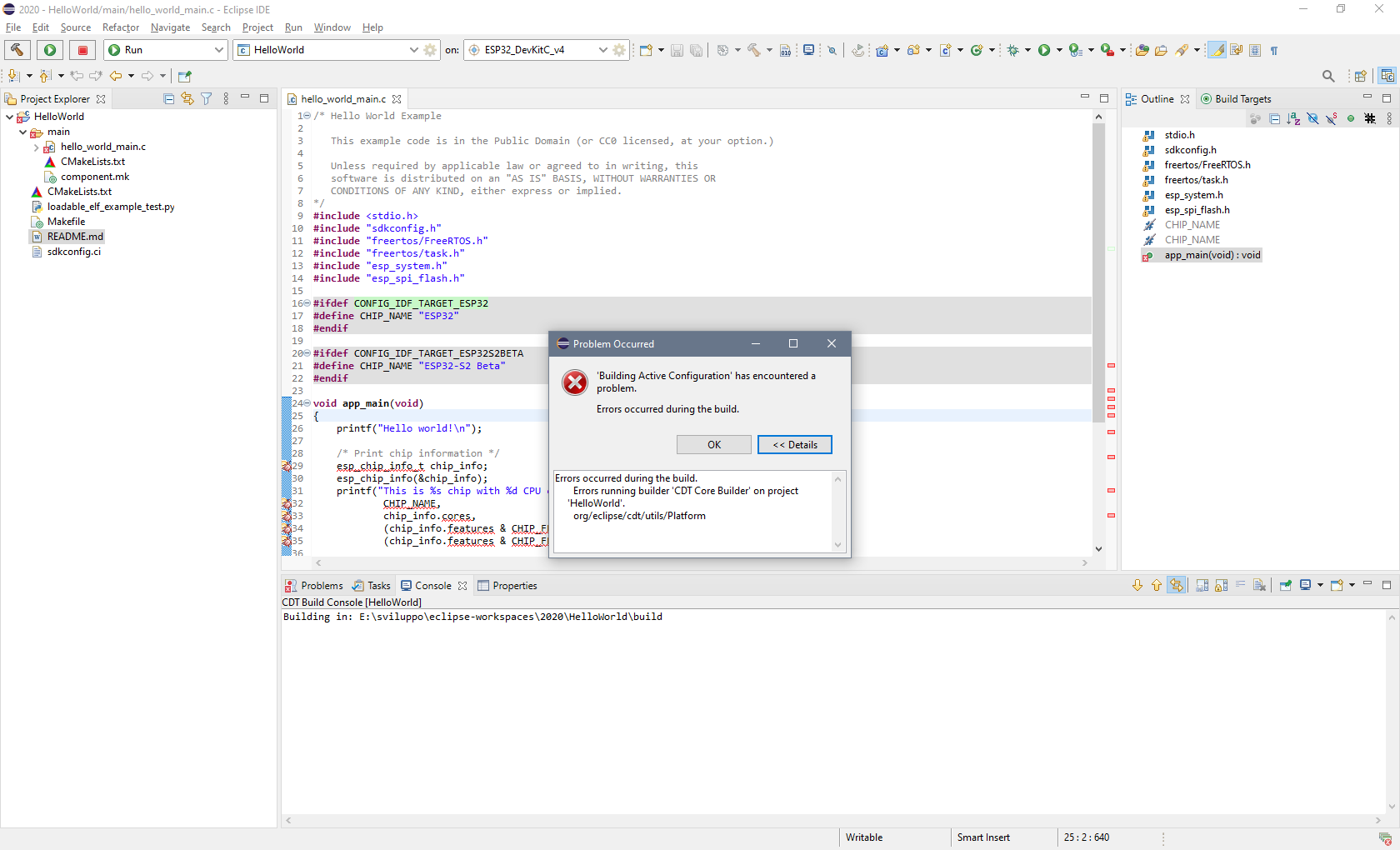

Installed eclipse plugins as per the directions provided in the installation procedure. Was able to install the tools & create a project from the templates. But compilation gives error "CDT Code builder error".

Hi everyone,
Just confirming the problem reported by Pradeep and in the other mentioned thread.
I attach a screenshot below.
As the error indications are bare, it is quite difficult even to figure out where the problem could be.
Thank you in advance for any suggestions.

Re: CDT Code Builder Error while compiling with Eclipse
Update.
It appears to be a bug in the IDF Plugin for Eclipse 2020-09:
https://github.com/espressif/idf-eclips ... issues/127
The suggestion is to use Eclipse 2020-06 until fixed.
ESP-IDF Eclipse Plugin 1.2.3 is released to support Eclipse 2020-09
https://github.com/espressif/idf-eclips ... tag/v1.2.3
Please update to the latest.
