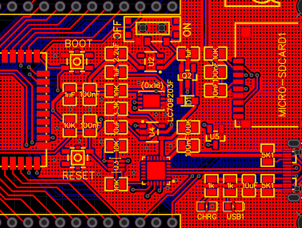

I've been developing an IoT sensor around an ESP32 WROOM-32D and with the latest PCB design I've started to get a brownout detection sometimes when the WiFi is started up. I've got a link to the full OSH project in my git repo bellow but I'll include some pictures below for reference.

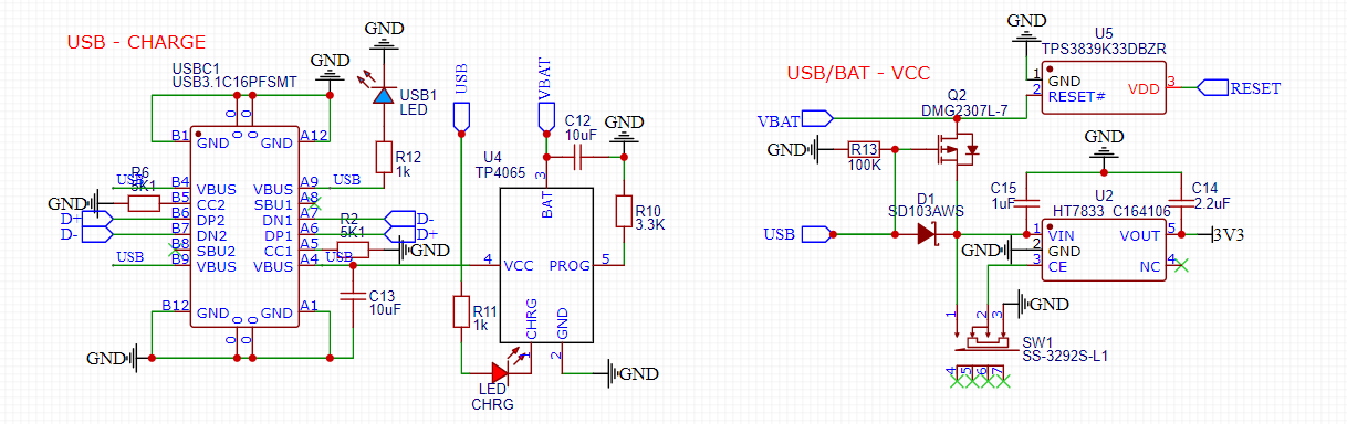

Below I've attached the power section of my schematic and the PCB layout. The thick traces are 20mil and the thin ones are 10mil. And the two capacitors after the switch are my power filters (1uF and 100nF) before feeding into the ESP32.
If anyone has any ideas I'm all ears at the moment, as I'm a little lost on what to try next with the next hardware review.

Couldn't hurt to use bigger caps either side of the HT7833, but most importantly, that little switch is in series with the ESP32 (and is rated for just 50mA @ 12v). This must go.
If there's nothing on the 3V3 rail that needs to remain powered when your device is "off", I'd suggest moving the switch to the HT7833 EN pin (which will also reduce the battery drain while off), otherwise move it to WROOM EN. A voltage supervisor on the latter should correct the 'stuck' startup you're seeing sometimes.

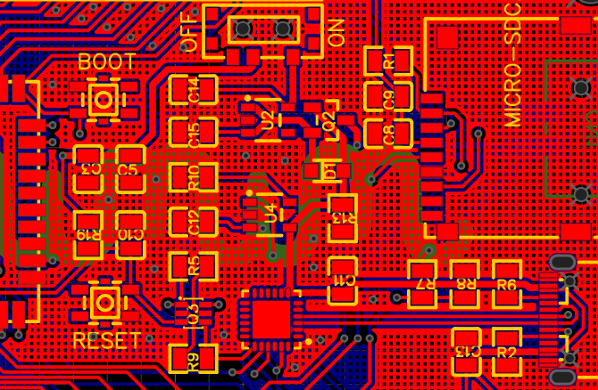

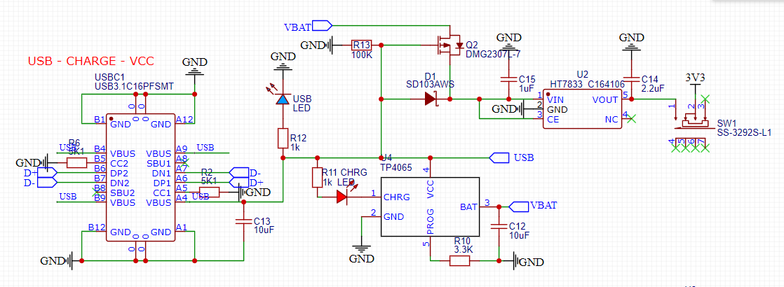

Thanks, that's helped a lot I think. After doing some research (and watching some Andreas Spiess videos) I've gone with the TPS3839K33DBZR (2.94V dropout) and reworked the layout do things are a little more clear. While I'm doing a hardware review I've also added in an i2c fuel gauge for good measure.
For the caps on either side of the LDO, I've followed the datasheet on their recommendation but have also had a look at the XC6220,
AP2112K-3.3TRG1, and TLV75533PDBVR which I'll pick up and test alongside to see if maybe the LDO is also a problem. If you see any glaring mistakes in my schematic or layout, please let me know :)

I think the TPS3839 should be monitoring 3V3, not VBAT.
Also you need to swap VDD/Reset.
