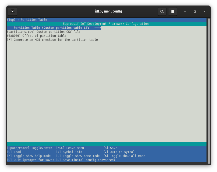

Another similar question on the same lines.....
In the WROOM-32E Module with 4MB flash, is it possible for me to use, say 200k or 300k of memory from the 4MB Flash for my data storage ?
My code is quite small and comes in under 2MB.
Alternately, if I use a 8MB Module, then I can have 4MB for code and 4MB for data ?
Is it just partitioning accordingly that I need to take care of or is there something else that needs to be done for this ?
Thanks
Minatel
Posts: 434
Re: ESP32 maximum use of remaining Flash
Postby Minatel » Thu Jan 07, 2021 12:14 pm
You just need to create a custom partition and define the storage portion that you want.
For example, you can use something like this (partitions.csv):
# Name,   Type, SubType, Offset,  Size, Flags
# Note: if you change the phy_init or app partition offset, make sure to change the offset in Kconfig.projbuild
nvs,      data, nvs,     0x9000,  0x6000,
phy_init, data, phy,     0xf000,  0x1000,
factory,  app,  factory, 0x10000, 0x180000,
storage,  data, spiffs,  ,        2M,
Just be sure that you are not overwriting anything and to set the custom .csv file on the configuration (Partition Table menu).
Screenshot from 2021-01-07 12-09-44.png (39.6 KiB) Viewed 6230 times
To dive deeper in this subject, see the reference documents: Partitions
