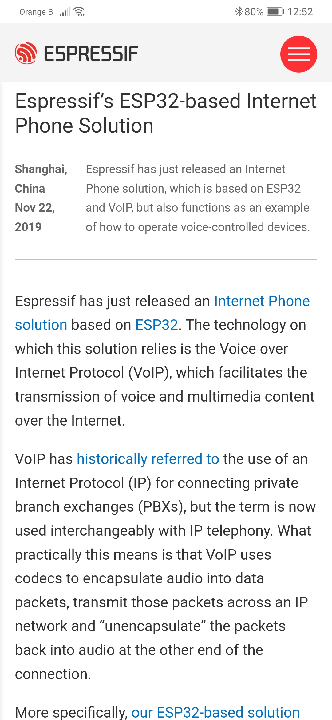

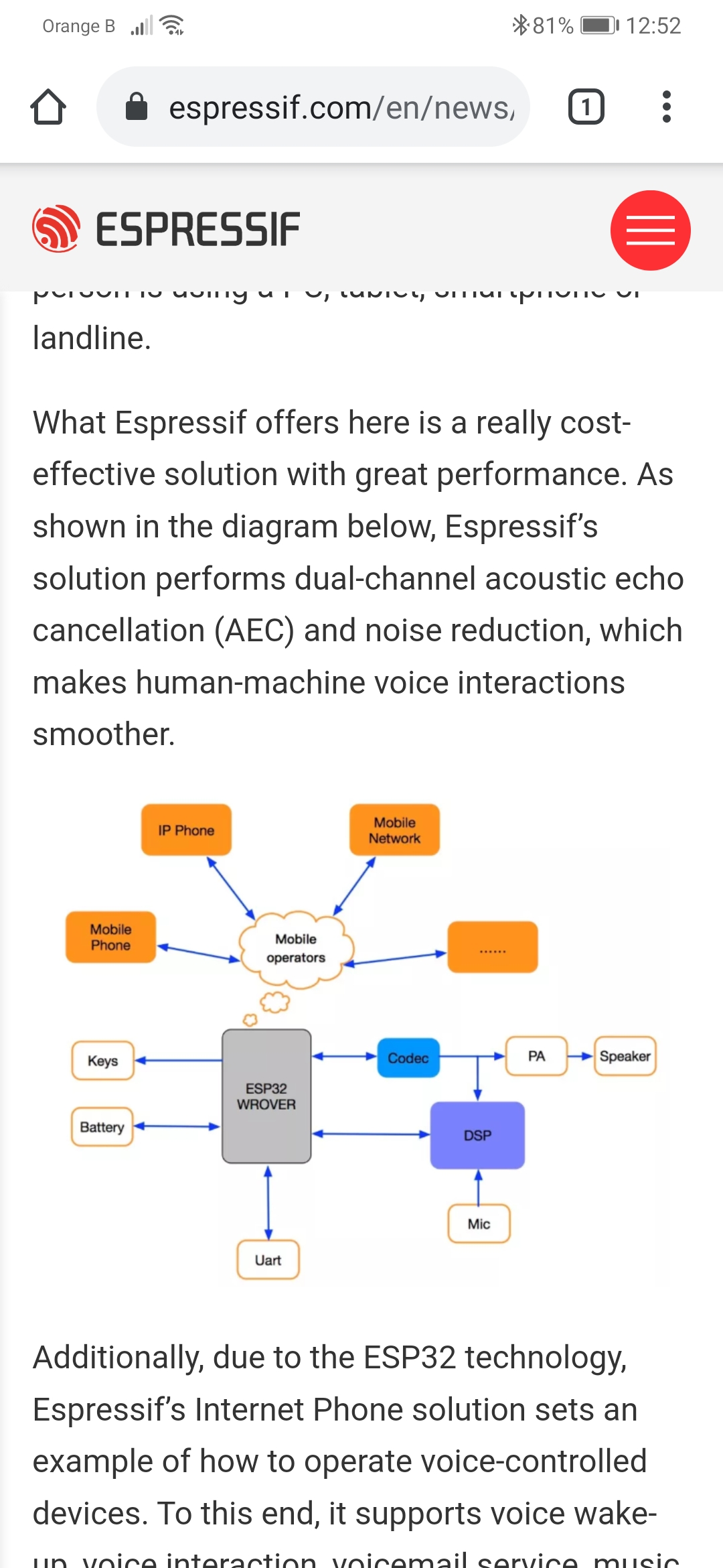

In the espressif document on voip (attached), it is mentioned that it includes a dual channel acoustic echo cancellation (AEC).
When I call with my Android phone, I hear my words in my ear with delay, when I call my Pc, no echo happens.
How/where in the Voip app/esp-adf can I see what is implemented for AEC so I can change parameters or add programming lines to optimise the echo canceller?

In attached document, it says that espressif has an aec solution. Please explain why this solution is not provided/shared?

Can't find any code either. Looks from the hardware schematics of the Espressif audio development boards that the Mic signal and speaker feedback signal were intended to occupy the left and right channels of I2S, and the processing intended to occur within the ESP32 for AEC. However, I have been unable to find any AEC code within ESP-ADF library. Maybe this code has been left up to the open-source community to produce?
