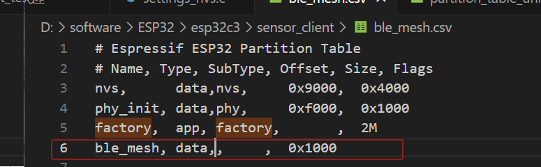

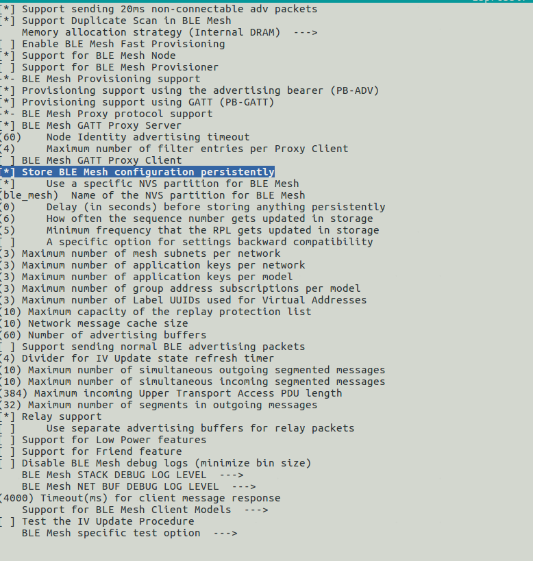

If the option "Use a specific NVS partition for BLE Mesh" is choosn, please make sure the partition.csv file
in the example has contained a specific partition named "ble_mesh".
Thanks.

已经在分区表里面添加了ble_mesh为什么还是不行?
