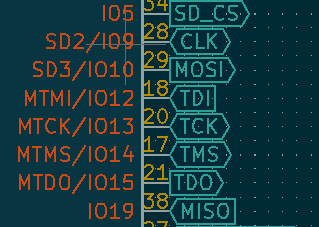

Hello Gentlemen!
I have made a new prototype for a project I am working on and switched from Pico D4 to Pico V3. I've left the pin connections and the connector the same and expected everything to work just fine, however I am not able to upload with espprog, only via serial and the onboard CP2104.

I was suspecting my wiring broke, but the old prototype with pico d4 works as expected with the same connector. I have also buildt two prototypes with the exact same issue.
Any idea what the issue could be?
My pin connections

You possibly need to update your OpenOCD packages... the V3 ESP32 silicon has some small changes to the way JTAG works, and your OpenOCD doesn't seem to take that into account.

Ah thanks sprite! Good to know it's not a hardware issue. I'm using the platformio integration for vscode, which comes with openocd, so I don't really have a way to update openocd. Guess I'll have to take this issue to the platformio community ...

To update and close this, the very responsive guys at PlatformIO have updated open ocd in their repositories, and debugging the Pico V3 works just fine now!
