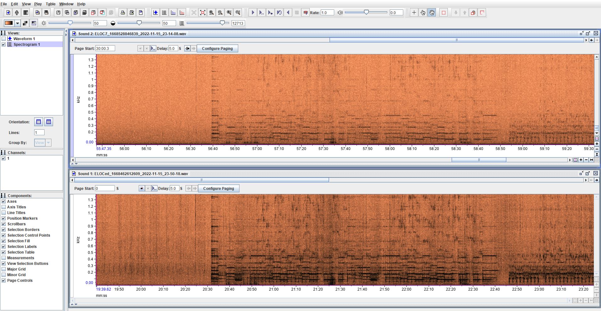

The INMP441 is obsolete and is not produced any more. "Unfortunately" you can still buy the module almost everywhere but this will not be the INMP411. Even they call it INMP411.

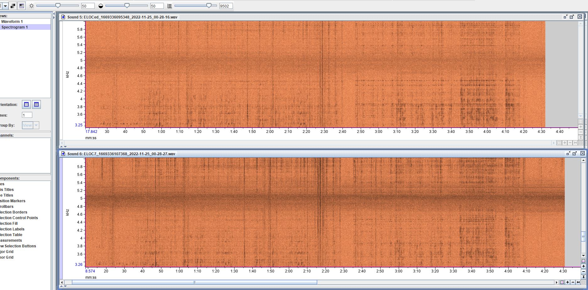

I had a project where i needed to build 30 recorders and ordered 30pcs INMP411 from different distributors. It turns out that they differ very much by sound quality and frequency spectrum.
In the attachment you can see the same recording with two INMP411 from different sellers.
So the INMP411 can only be used for fun project. But not for anything serious due to lack of consistency. You basically have no idea which MEMS is used on the board
- ELOC7 vs ELOCed - different quality same mic.JPG (455.01 KiB) Viewed 3159 times
- ELOC7 vs ELOCed - changed the bad mic to new one - high frequencies.JPG (433.94 KiB) Viewed 3159 times
