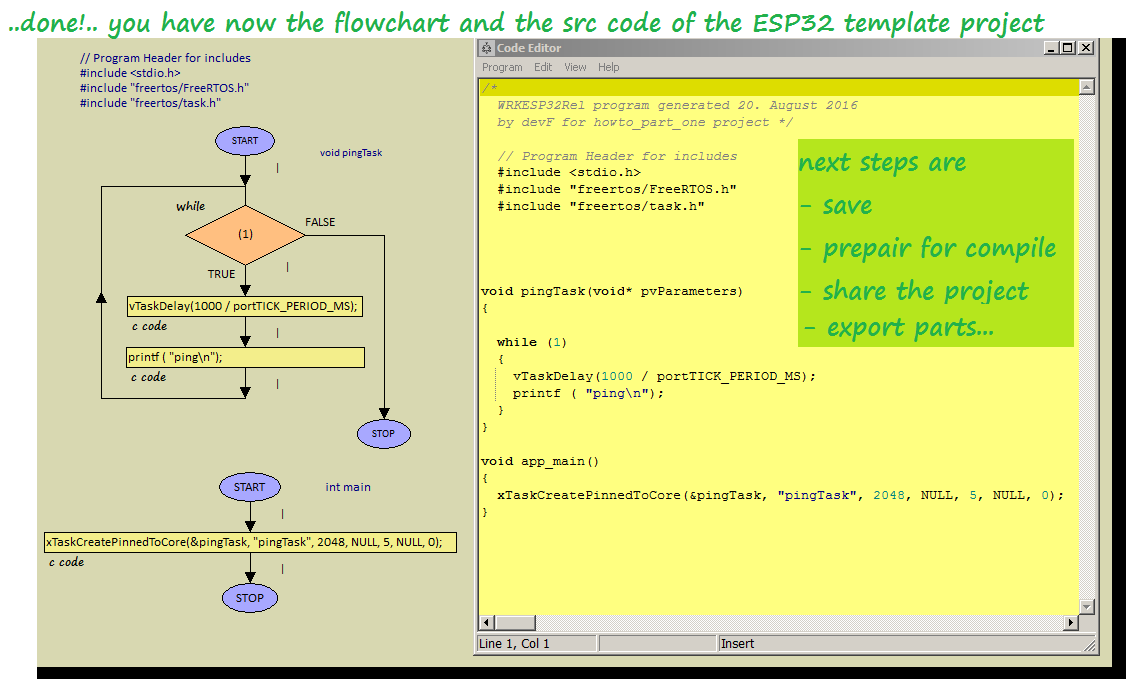

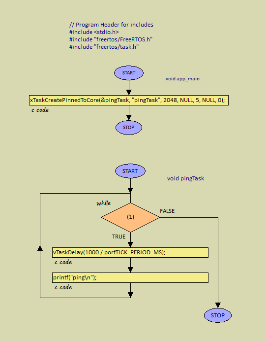

just in time prepaire "howTo" with step by step
this is a part of the "how to" to the esp-idf template project from the actually sdk.
left side the flowchart was designed,, and the code is generated from the flowchart.
this is only a small example from the devF capacity -
we can share the "code" with a XML file as a "SKETCH"
can import parts, export parts.
can create code templates and many other things.
here you see the final :
config & compile a esp-idf template for the esp32 release
devF : esp32 sdk ( 20. Aug 2016 ) template 'config & compile part'
