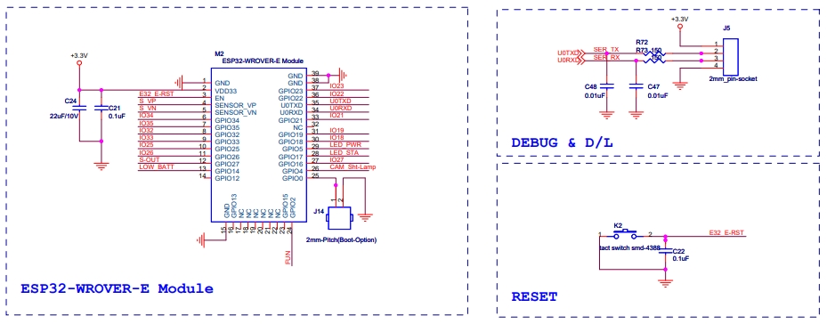

Attached file is part of my schematic.
Could you check it's no problem to Initial firmware download using UART?
P.S. EN pin and GPIO0 pin handling is mandatory for Initial firmware download?
If does, could you let me know how to handle those pins to ESP32 enter firmware download mode after boot?

You are missing a pull up resistor from RST to 3.3v. You just have a cap and a button, nothing will charge the cap.
10k R is typical, reference the esp32 hardware design guide.
You should base your design off existing hardware that is known to work, like the many esp32 dev boards that publish their schematic.
https://www.google.com/url?sa=t&source= ... KScKrVIgRg
If you are going with a 4 pin jtag connector, you need to press the reset and boot buttons manually. The common auto flash circuit that eliminates needing to press the button is used in conjunction with a uart bridge chip that outputs DTR and RTS signals. It looks like you're not using that so you can just use the buttons.

Thanks a lot for information.
I have a power on/off slide switch on board so if reset pin is not mandatory for
firmware download, I prefer remove reset circuit.
I guess this procedure will be work for firmware download, could you check this out?

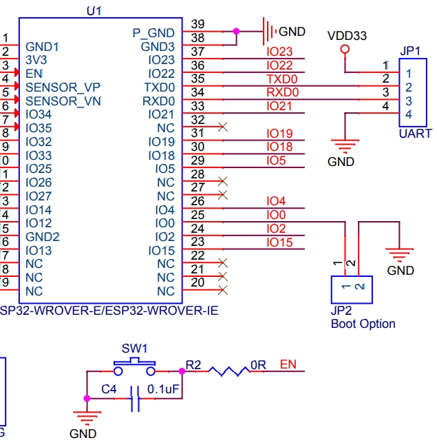

Okay, will add resistor(10k) refer below schematic from esp32-wrover-e_esp32-wrover-ie_datasheet_en.pdf So, could you final check my procedure below would be correct?
Thanks in advance!

That should work, assuming the rest of the GPIOs aren't connected to anything. If they are, be mindful of the other bootstrap pins that are there.

The R and C connected to EN are critical. They set the rise time of the voltage power up.
Can you confirm if you have 10K from 3.3V to EN, and (at least) 0.1uF from EN to GND?

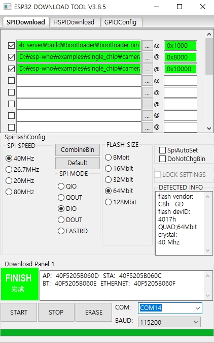

Hello, problem solved.
- I guess problem somewhat caused by limitation of my USB-to-UART dongle,
which connect my custom board and PC.
After I change download tool as "flash_download_tool_v3.8.5" and lower
UART baudrate as 115,200, it started work.
- ESP32-WROVER_E in my custom board turns out that have 8MB Flash inside.
Thanks for help anyway!
