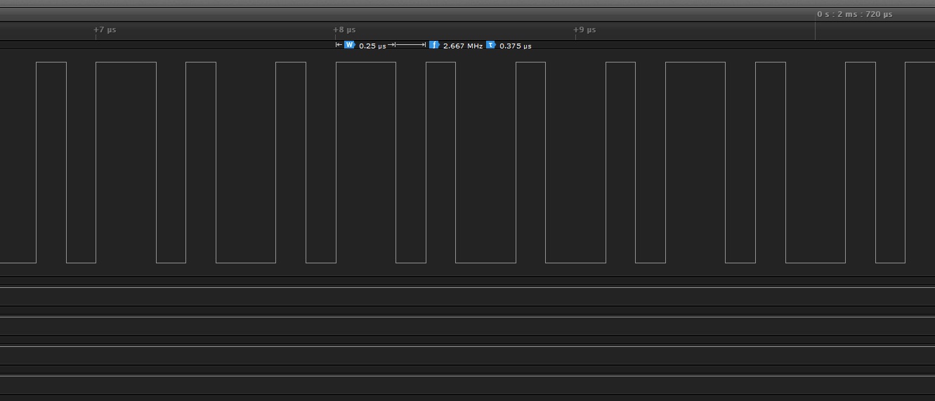

I'm hoping someone can help as this is driving me mad!
I'm trying to generate a square wave clock signal from the ESP32 GPIO0 with a frequency of 13MHz and a 50% duty cycle. From what I've read elsewhere, it seems that a clock up to 40MHz should be possible using LEDC with a timer duty resolution of 1 bit. The best I can get is 4MHz (see below) before other effects seem to happen (like inconsistent duty cycles and unexpected frequencies). For example, when I set the frequency to 13MHz, I get the attached waveform at 1.6/2.66MHz. Even below 4MHZ, I cannot seem to set precise frequencies with a 50% duty cycle.
Would anyone have any ideas? Could it be an issue with the LEDC_HIGH_SPEED_MODE perhaps?
Thanks,

The base clock for LEDC is 80MHz. You'll see weirdness as there's no way you can divide 80MHz cleanly into 13MHz. With that being said, I'd still expect a frequency of 13.3MHz and a duty cycle of 48% if you set ledc_timer.freq_hz to 13000000. Is that what you get, or do you get something else?

thanks for the reply. If I make the setting 13Mhz, I get the attached waveform:
Any ideas?

Interesting... if I put a frequency of 13MHz there, I do get 13MHz but with a bit of jitter; there's probably a fractional divider involved. What ESP-IDF version are you using? Fwiw, I'm using master, and this bit of code:

I'm actually using Arduino rather than IDF at the moment. It's got me thinking if perhaps that could be part of the problem?

Possibly... the ledc calls you use are part of ESP-IDF (you can use most ESP-IDF calls in an Arduino project) but Arduino may be on a lower version of ESP-IDF; could be that there's a bug in the ledc driver for that version.
