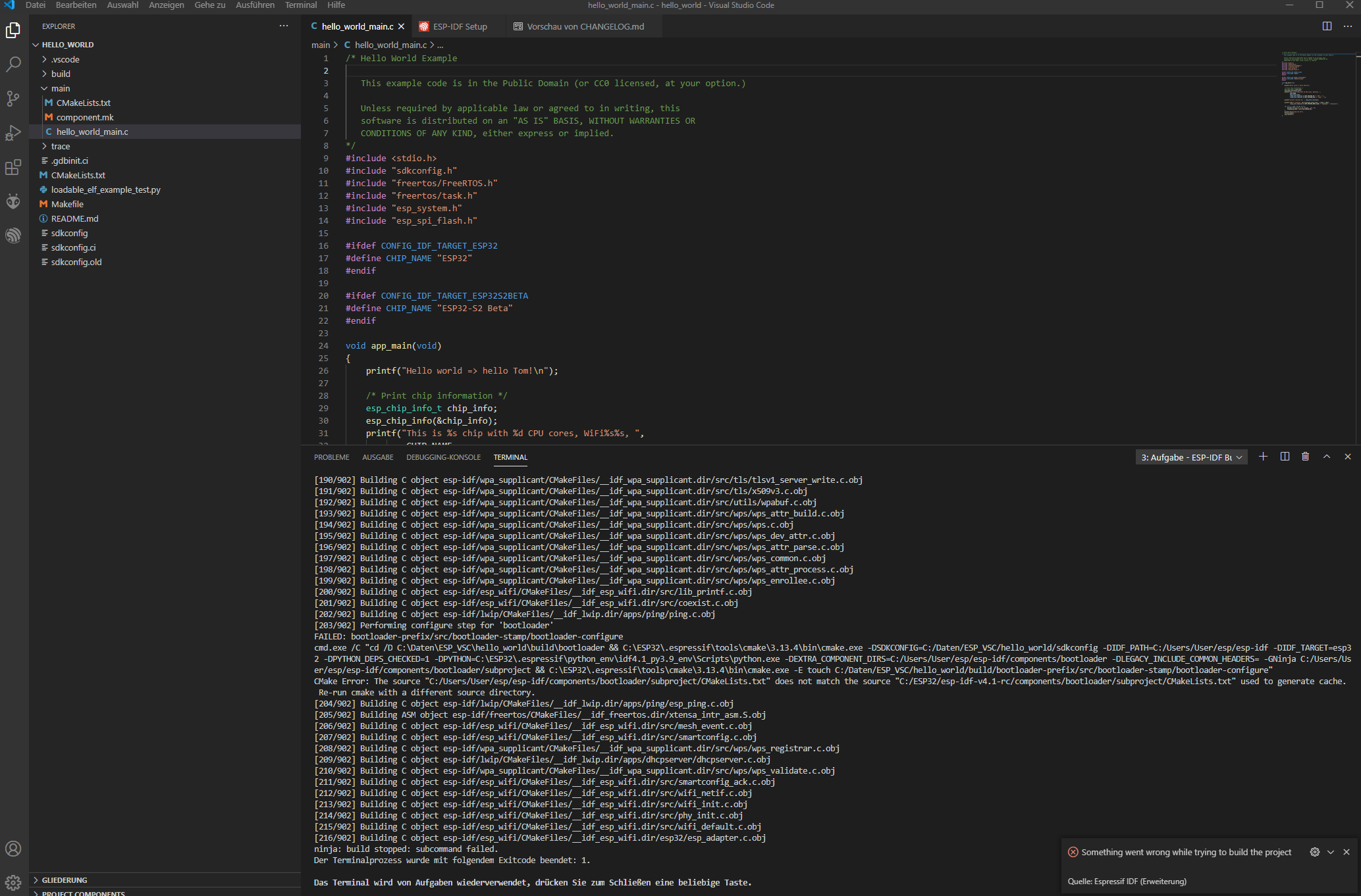

When I build the "hello_world" the VSC hangs up with
ESP-IDF Custom Terminal
$ cmake
********"******************************o-idf\partition_table && C:\ESP32\.espressif\tools\cmake\3.13.4\bin\cmake.exe -E echo "Partition table binary generated. Contents:" && C:\ESP32\.espressif
# Espressif ESP32 Partition Table
# Name, Type, SubType, Offset, Size, Flags
nvs,data,nvs,0x9000,24K,
phy_init,data,phy,0xf000,4K,
factory,app,factory,0x10000,1M,
onfigure step for 'bootloader'
FAILED: bootloader-prefix/src/bootloader-stamp/bootloader-configure
cmd.exe /C "cd /D C:\Daten\ESP_VSC\hello_world\build\bootloader && C:\ESP32\.espressif\tools\cmake\3.13.4\bin\cmake.exe -DSDKCONFIG=C:/Daten/ESP_VSC/hello_world/sdkconfig -DIDF_PATH=C:/ESP32/esp-idf-v4.1-rc -DIDF_TARGET=esp32 -DPYTHON_DEPS_CHECKED=1 -DPYTHON=C:\ESP32\.espressif\python_env\idf4.1_py3.8_env\Scripts\python.exe -DEXTRA_COMPONENT_DIRS=C:/ESP32/esp-idf-v4.1-rc/components/bootloader -DLEGACY_INCLUDE_COMMON_HEADERS= -GNinja C:/ESP32/esp-idf-v4.1-rc/components/bootloader/subproject && C:\ESP32\.espressif\tools\cmake\3.13.4\bin\cmake.exe -E touch C:/Daten/ESP_VSC/hello_world/build/bootloader-prefix/src/bootloader-stamp/bootloader-configure"
CMake Error: The source "C:/ESP32/esp-idf-v4.1-rc/components/bootloader/subproject/CMakeLists.txt" does not match the source "C:/Users/User/esp/esp-idf/components/bootloader/subproject/CMakeLists.txt" used to generate cache.  Re-run cmake with a different source directory.

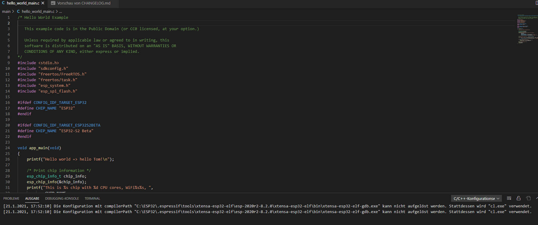

I know your Site. But I don't coming forward. I install via express or via advanced, with ESP-IDF from download( I'm afraid, I've 50x downloads of the same) or with ESP-IDF from HDD - every time the same result. See picture1. This is german and says that the VSC can't resolve the Path to the xtensa-esp32-elf-gdb.exe. I think, the VCD needs that to compile. When I try to build then I've the result in the picture2.
This is the content of settings.json
    "idf.espIdfPathWin": "C:\\Users\\User\\esp\\esp-idf",
    "idf.pythonBinPathWin": "C:\\ESP32\\.espressif\\python_env\\idf4.1_py3.9_env\\Scripts\\python.exe",
    "idf.customExtraPaths": "C:\\ESP32\\.espressif\\tools\\xtensa-esp32-elf\\esp-2020r2-8.2.0\\xtensa-esp32-elf\\bin;C:\\ESP32\\.espressif\\tools\\xtensa-esp32s2-elf\\esp-2020r2-8.2.0\\xtensa-esp32s2-elf\\bin;C:\\ESP32\\.espressif\\tools\\esp32ulp-elf\\2.28.51-esp-20191205\\esp32ulp-elf-binutils\\bin;C:\\ESP32\\.espressif\\tools\\esp32s2ulp-elf\\2.28.51-esp-20191205\\esp32s2ulp-elf-binutils\\bin;C:\\ESP32\\.espressif\\tools\\cmake\\3.13.4\\bin;C:\\ESP32\\.espressif\\tools\\openocd-esp32\\v0.10.0-esp32-20191114\\openocd-esp32\\bin;C:\\ESP32\\.espressif\\tools\\ninja\\1.9.0;C:\\ESP32\\.espressif\\tools\\idf-exe\\1.0.1;C:\\ESP32\\.espressif\\tools\\ccache\\3.7",
    "idf.customExtraVars": "{\"OPENOCD_SCRIPTS\":\"C:\\\\ESP32\\\\.espressif\\\\tools\\\\openocd-esp32\\\\v0.10.0-esp32-20191114/openocd-esp32/share/openocd/scripts\",\"IDF_CCACHE_ENABLE\":\"1\"}",
    "terminal.integrated.enableBell": true

bignacio
Posts: 255
Joined: Wed May 02, 2018 12:12 pm
Re: Espressif IDE don't work in VSCode
Postby bignacio » Wed Mar 03, 2021 9:51 am
@BergLoewe the error you have is because you have a cache copy of previous build which used a different ESP-IDF directory based on your build output.
Please delete the build folder from this project (or use the extension full clean command) and try to build again.
