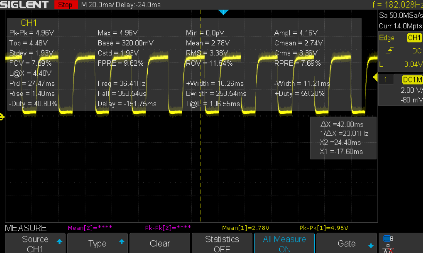

I need create a PWM signal using a hardware timer. I would have used RMT or something more native to esp32 but I am using an i2c gpio expander. I wrote the code which was straight forward but am getting unreliable results (eg. pulse width being much to short or the io sticking high or low).
To rule out the i2c and my code, I started back with the timer example. I changed TIMER_INTERVAL1_SEC to 0.009 (9ms)
#define TIMER_INTERVAL1_SEC   (0.009)   // sample test interval for the second timer
And toggled io26 on the esp32:

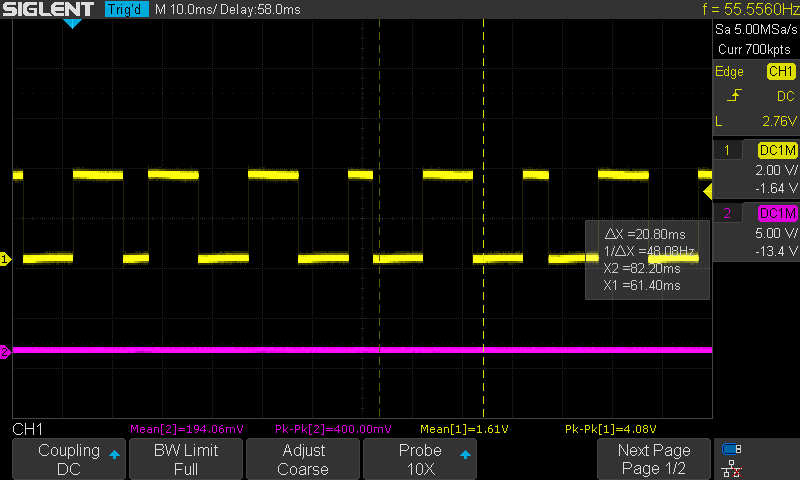

Scope looks like this:

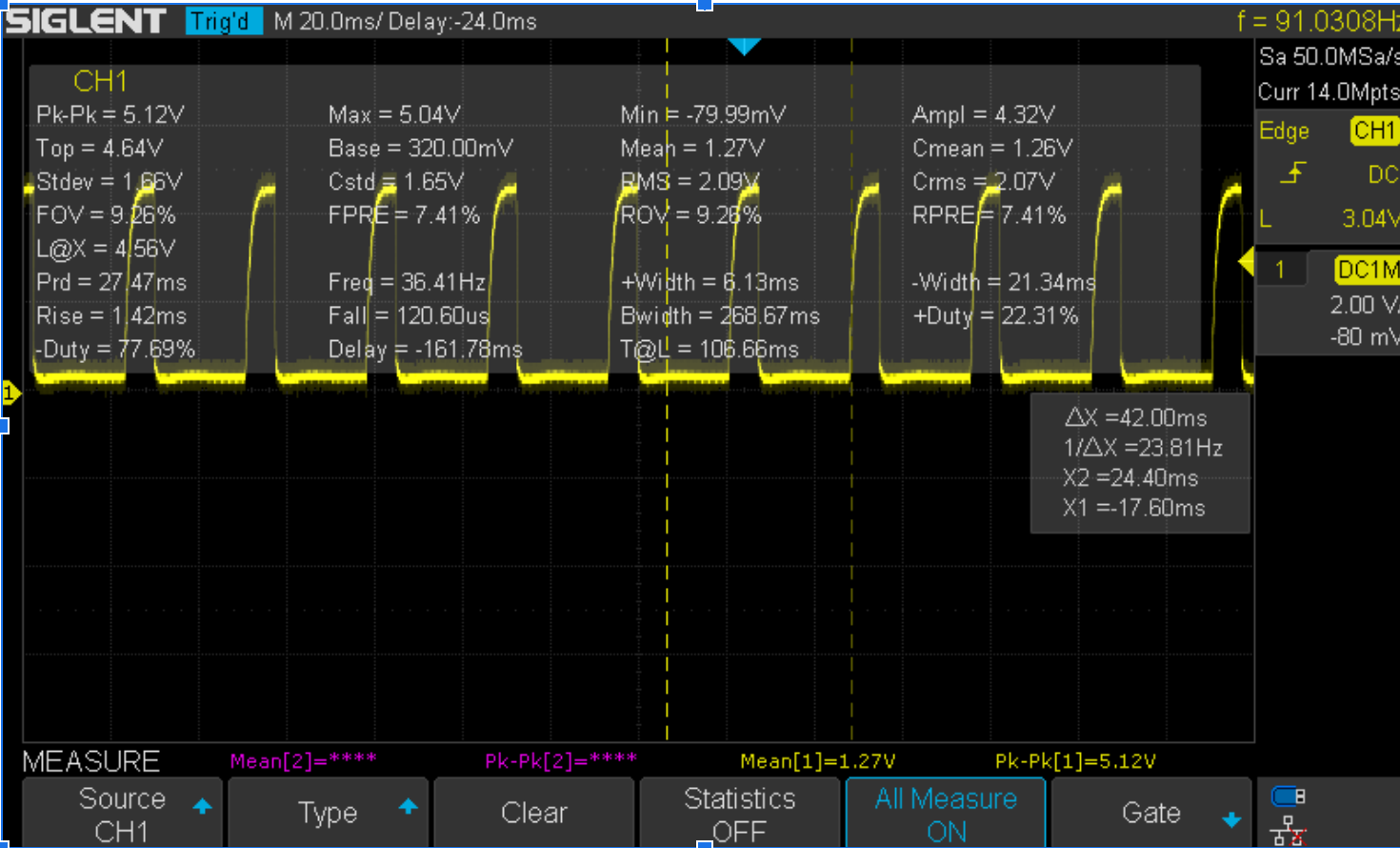

And this is what I am trying to create (pwm at 36.41hz with sub ms resolution):
I tried adjusting the divider and setting the io value in the ISR instead of using a queue but saw the same results. Why am I not able to get reliable output when using the timer to set gpio especially at smaller time scales?
