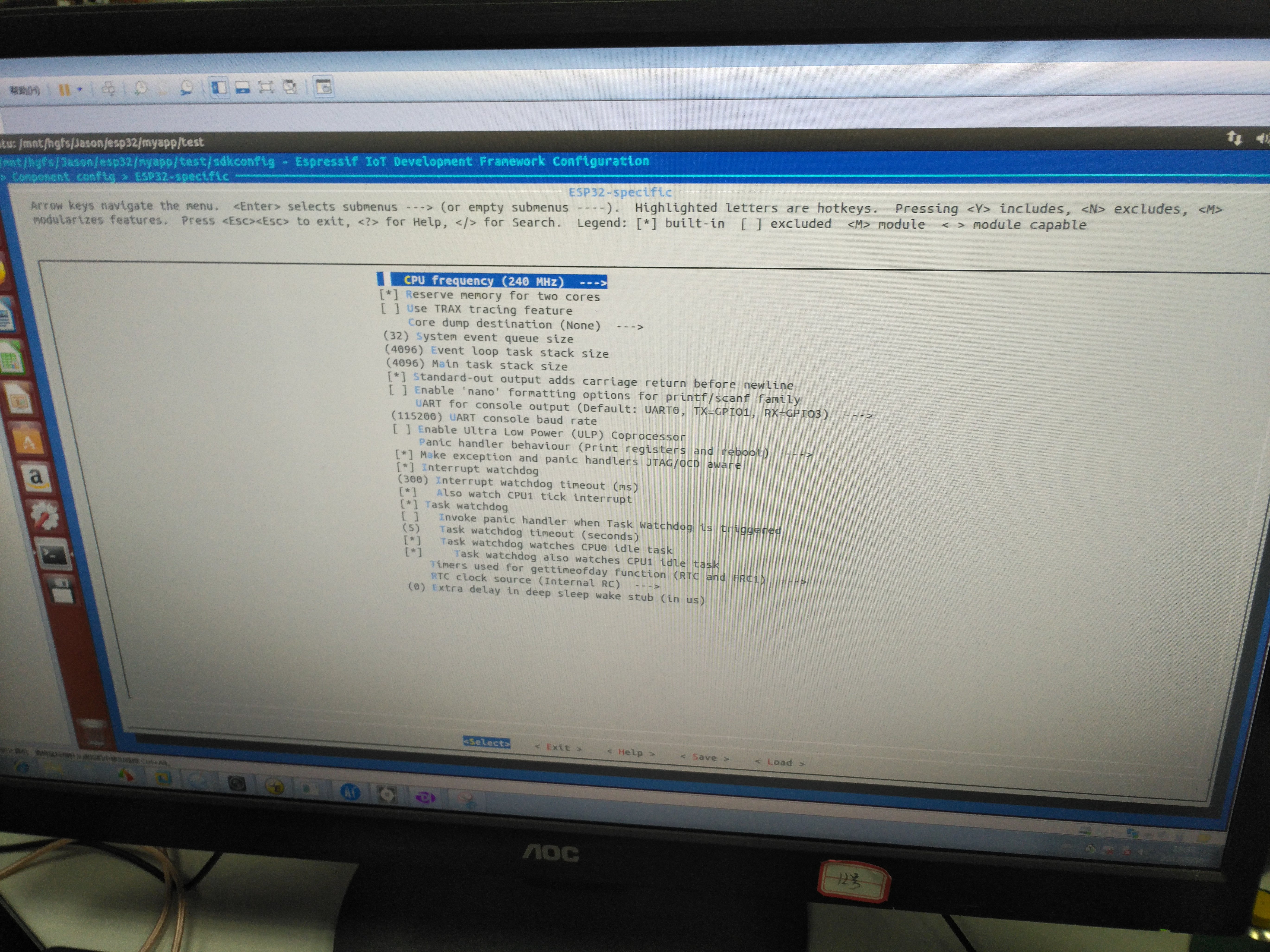

Now i post the picture,i want to ask where "Main XTAL frequency",could you please find it to me.We use the
IDF rc 2.0.
Thank you a lot :D .
The picture is in the attachments.

The chip does support 24MHz, and the software can be made to support 24MHz as well. However this isn't yet implemented because there wasn't sufficient demand for this. Your interest is noted and I will check about prioritizing this feature for the next release.
Choice between 26 and 40 MHz in menuconfig was implemented after 2.0 release. So in v2.0-rc1, v2.0-rc2, and v2.0 this feature is not available. You can get it if you use recent git version of ESP-IDF. Alternatively, if you wait a couple of weeks, it will be released in v2.1.
Is there a specific reason why you need to use a pre-release version?

The explicit choice of XTAL frequency has been added to menuconfig recently, and if you use latest git version of ESP-IDF, the option should be there.
26 MHz should work with older versions with autodetect. Can you print out the contents of RTC_CNTL_STORE4_REG and RTC_CNTL_STORE5_REG and post them here? That may give a clue why 26MHz xtal doesn't work.
