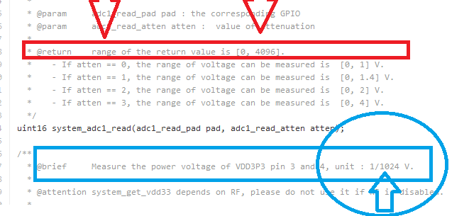

is there any info on ADC I/O support? I mean channels, type of chanel, internal, external reference, speed?
ESPGURU
Joined: Fri Nov 27, 2015 12:26 am
8 channel ADC ...
Postby ESPGURU » Thu Dec 03, 2015 2:20 am
think we have 13 BIT, 8 channel, can measure 0..4 V in 0..4096 by setting atten 0,1,2,3
http://www.esp32.com/viewtopic.php?f=5&t=19&p=79&#p79
espguru
8-)
do not wait - make it!

Isn't a range of 0-4095 12 bits?

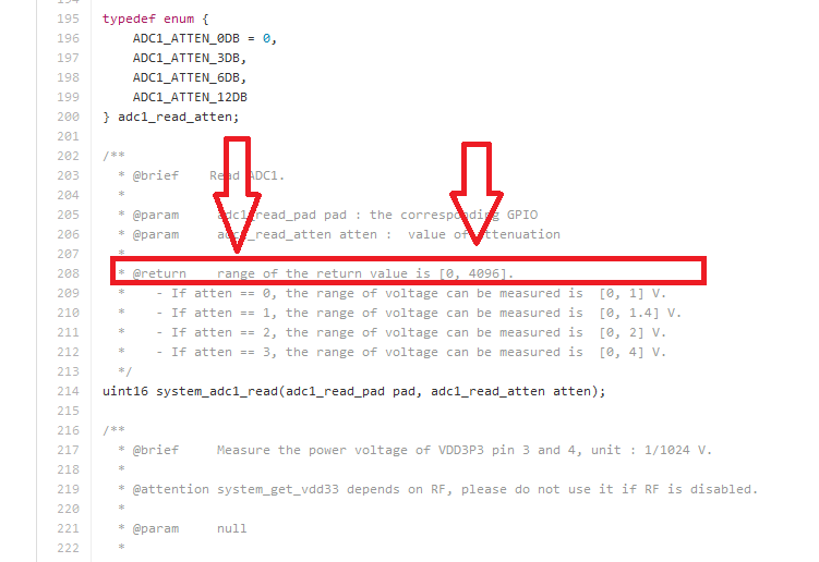

btw..
"..GURU" information is ok, have the same info from code..
but the info "range" 0, 4096 is wrong and i started practical with firmware and test like you see in video.
btw, we have up to 16 channel
:mrgreen:
hope now is clear

Actually, this isn't clear to me at all. When talking about the 'N-bits' of an ADC, it's commonly understood that you have a range of values from 0-(N^2-1) for a total of N^2 divisions (assuming non- 2s complement encoding). 13 bits would equal a range of 0 - 8191. If the range is truly 0-4096 then that doesn't make sense (from a hardware/implementation perspective), and at best it would be called '12-bit plus 1' or something.

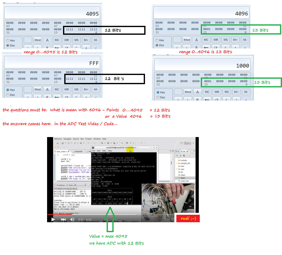

Postby rudi ;-) » Sat Jan 09, 2016 2:02 am
It's really simple. 12 bits = 0 -> 4095 and those are actually 4096 steps, because 0 is a value as well.
:mrgreen:
( fun! )
we have then 4096 steps? :mrgreen:
example: 1v in
atten= 0
1V / 4096 = 0,000244140625 V
we have then max value 4095 = ( ( 1V / 4096 ) * 4095 ) = 0,999755859375V
if we have 4095 steps :mrgreen:
1V / 4095 = 2,442002442002442e-4 V
we have then max value 4095 = ( (1V / 4095 ) * 4095 ) = 1V
btw
if we have value : 0
then
( ( 1 V / 4096 ) * 0 ) = 0
( ( 1 V / 4095 ) * 0 ) = 0
have a look : same here:
:mrgreen:
(/fun)
i allways calc
Value ?
Value : 4095
then 1 step = 1V / 4095
btw
value 1023 same ( blue circle )
we have no 1 / 1024
we have max 1 / 1023

.. 13 bits would equal a range of 0 - 8191. If the range is truly 0-4096 then that doesn't make sense (from a hardware/implementation perspective), and at best it would be called '12-bit plus 1' or something.
Reza
you are right.
the 13 bit is value range 0..8191
but we have range 0..4095.
so we have 12 bit adc.
'12-bit plus 1' there is no chance to get this in real :mrgreen:
nice talk, this fun!
think there is a description mistake in the code / understand mistake.
we have 1 / 1024 but we have not really to calculate the step 0
because value 0 = 0 V
our calc base is max value.
this is 12 bit, 4095
so i think ( hope )
1 / 4095 is the right
or
1 / 1023
and so on.
