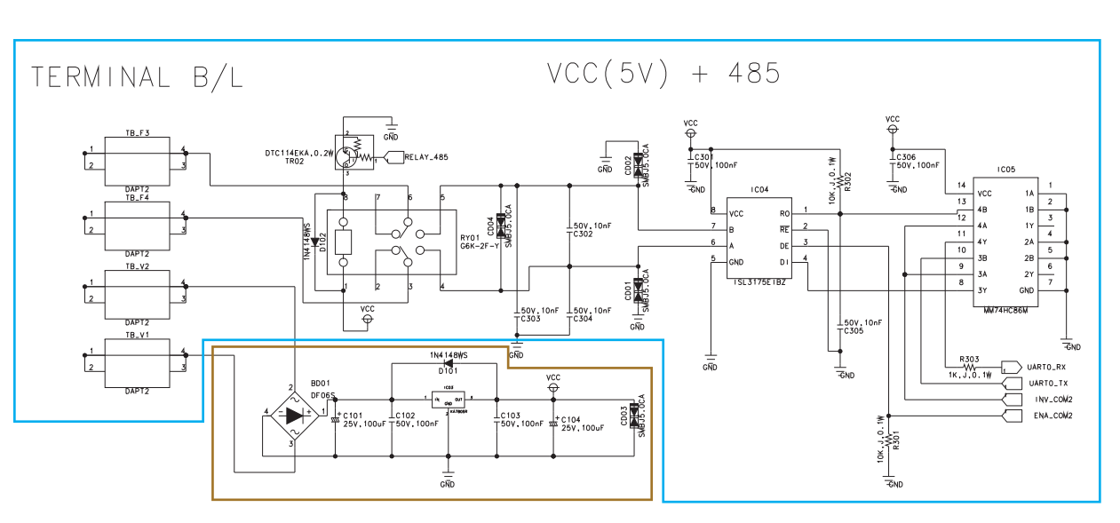

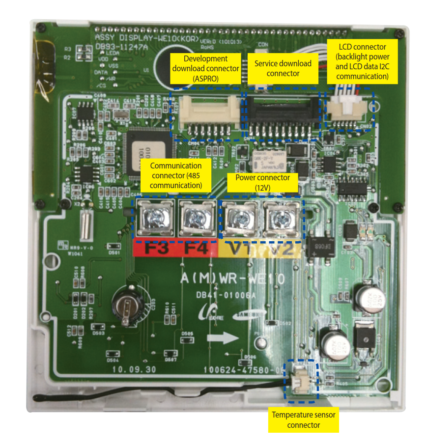

Hi
Back to your Question.
firstly you should check what power supply the lines are, so g**g*e bring many things to the MWR-WE10
Handbooks divers language
Service Manual with Errorcodes, PCB, Wiring Diagram, Shematics..
you see on PCB S.34 the protocoll type 485 on F3, F4
on the PCB S.35, you can see the 485 TTL to the F3, F4
From the PCB ( VCC 5V 485 ) should F3,F4 Modbus be 5V.
All what you have to do is
-first check this V5 right?
-use 5V TTL Modbus Converter to ESP32
- sniff the Data with it
( How to make MODBUS work with ESP32 - Arduino - RS485 - Part 1)
use Logic Analyzer for 10 USD for the protokoll on USB / PC and you can listen to the commands and make your own data sniff protokoll which you then use for the communciation between ESP32 and Modbus 485 F3, F4 over 5V-3.3V Level Shifter ..
Hope this helps.
Try by self -you learn more at this point
and happy coding
