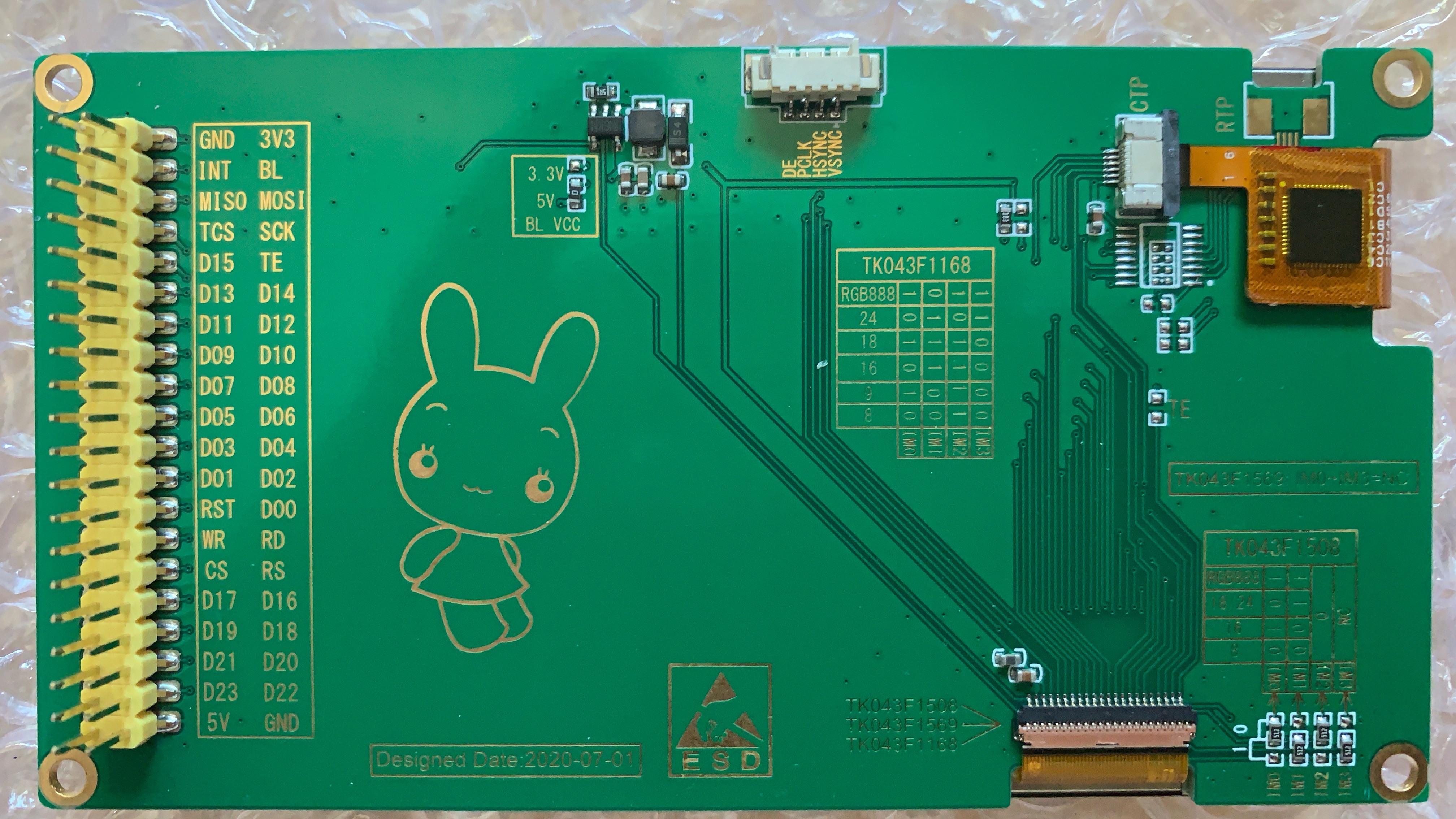

I recently purchased 2x displays with adapters to use with the ESP32 DevKit V4 (WROVER-IE) and the Espressif LCDKit v1.1
Based on advice from EspressIf (TK043F1508 ) and from users (link below) I ordered what I thought was the correct module.
https://github.com/espressif/esp-iot-so ... -674226075
I purchased the display modules from the following link:
https://buy.tbfocus.com/item.php?id=560 ... 2775208514
Upon receiving the modules I find that the pins are (slightly different) but more important that the controller has changed from NT35510 or RM68120 to LG4572
Q1. Any chance to get a driver adapted to support the LG4572 when used together with the DevKit and LCDKit mentioned above?
Q2. If so, which existing driver represent the starting point for adapting to the LG4572
Q3. If it is not possible to make the LG4572 work with the DevKit and LSDKit, can somebody explain the fundamental hardware incompatibility to me, hopefully I can learn from this?
Thanks
