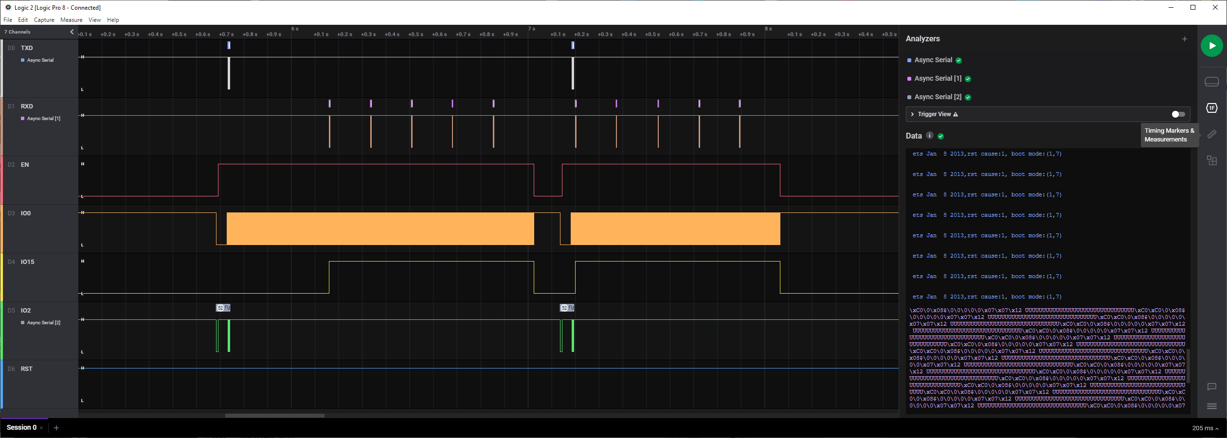

Hi! I'm sorry but I'm really stuck to get the ESP8266 Download tool (v3.8.5) to sync with my hardware.
I have a Microchip PIC32MM0256GPM064 micro controller with USB port, which I at this point works as a virtual comport, including possibility control baudrate and RTS/DTR to enable auto download with ESP8266 flash tools.
GPIO0 is low when EN goes high and the chip reports "ets Jan 8 2013,rst cause:1, boot mode:(1,7)" @74880bps
The flash tool is repeatedly sending "\xC0\0\x08$\0\0\0\0\0\x07\x07\x12 UUUUUUUUUUUUUUUUUUUUUUUUUUUUUUUU\xC0" @115200
But there is no response from ESP8266.
Are there any other condition to be met that i missed? Flow control? Any other important pin-states?
Please see attached screenshot from my logic analyzer.
