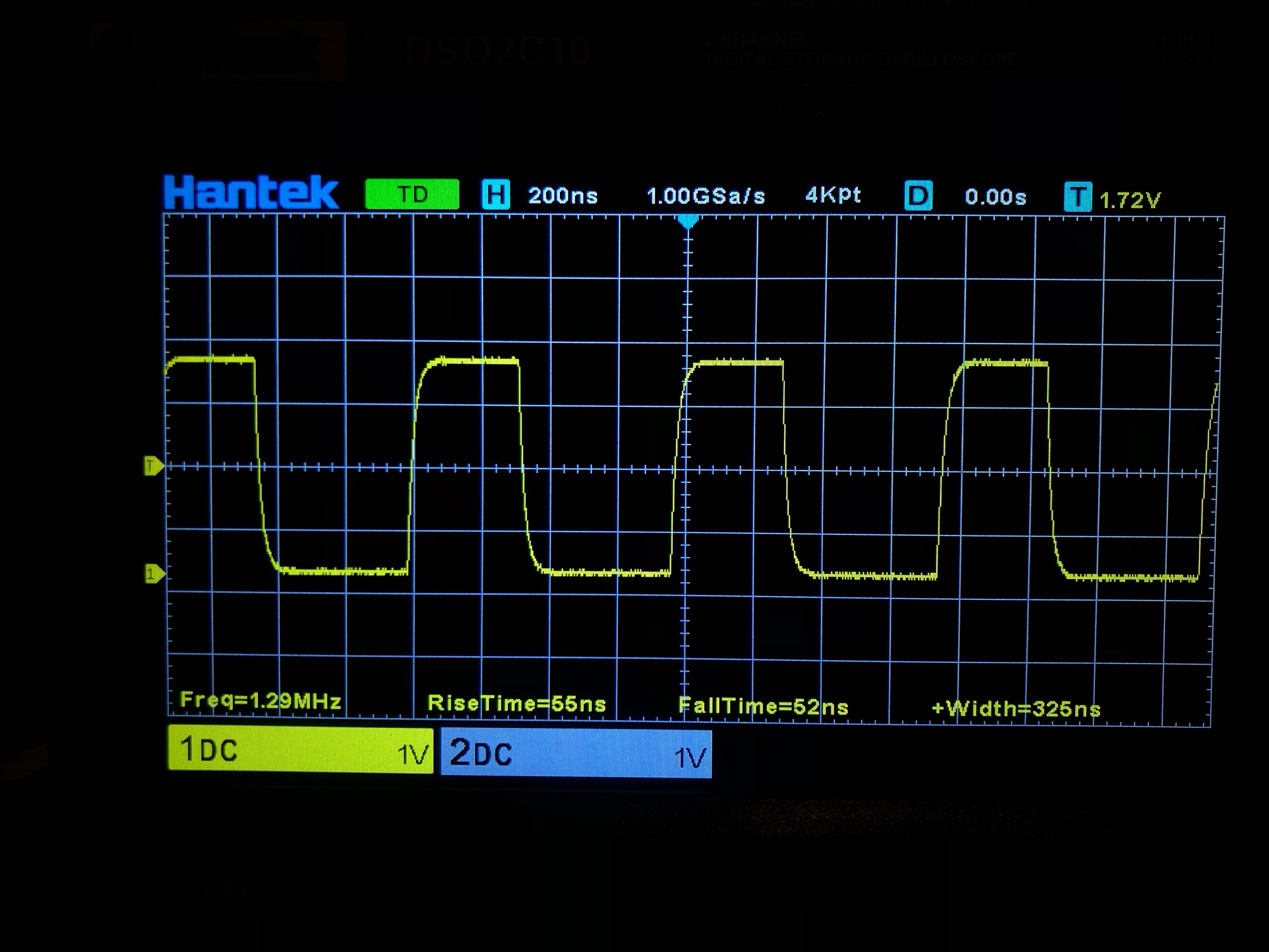

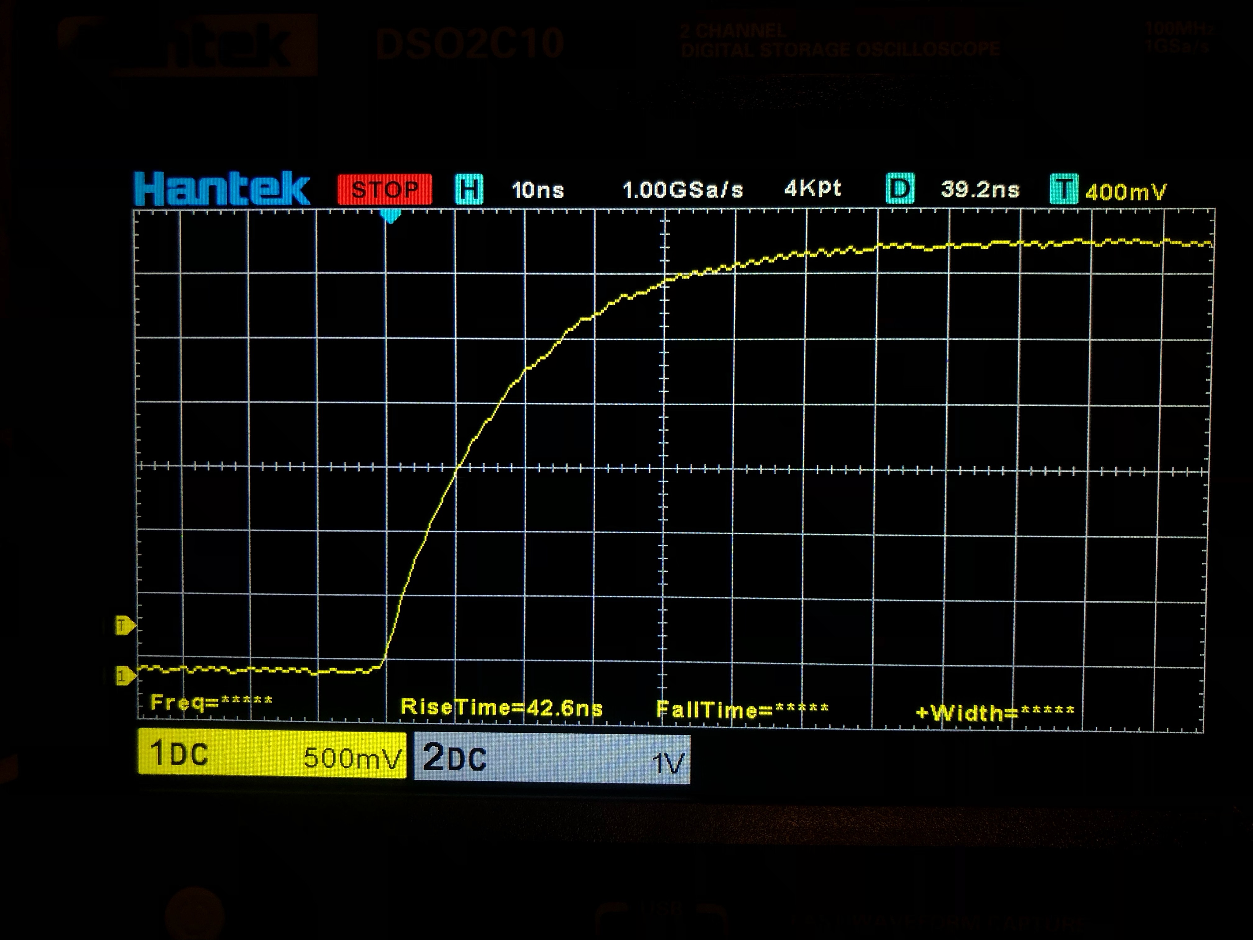

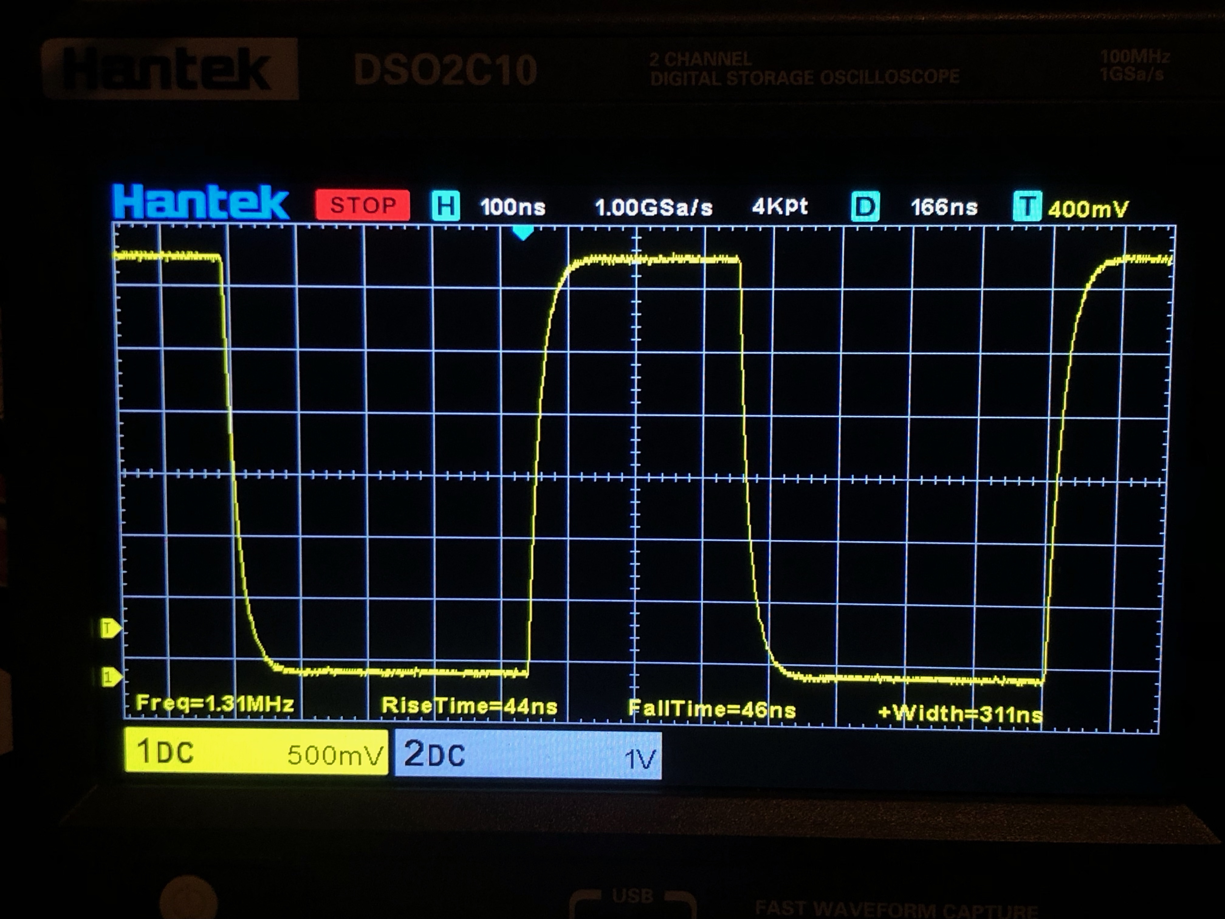

I am new to this and this is my first post, but using a simple test of digitalWrite-ing a pin between HIGH and LOW I am seeing rise/fall times of roughly 45-50ns on the scope. I also measured using ledcWrite and got the same results.
Photos:
Posts: 10596
Re: ESP32 GPIO slew rate/risetime
Postby Sprite » Thu Feb 01, 2024 4:09 am
Note that those rise and fall times are affected by your probe capacitance as well (although your measurements do give some baseline; as in the 'raw' unconnected rise/fall times are always going to be faster than this)

I apologize, how then esp32 works at 80 megahertz with external flash/ram ?
for this you need to have edges not worse than1-2 nanoseconds.
As far as I see you measure edges with oscilloscope with bandwidth less than 100 megahertz ?
In that case you are showing the edges of the oscilloscope/probe itself (

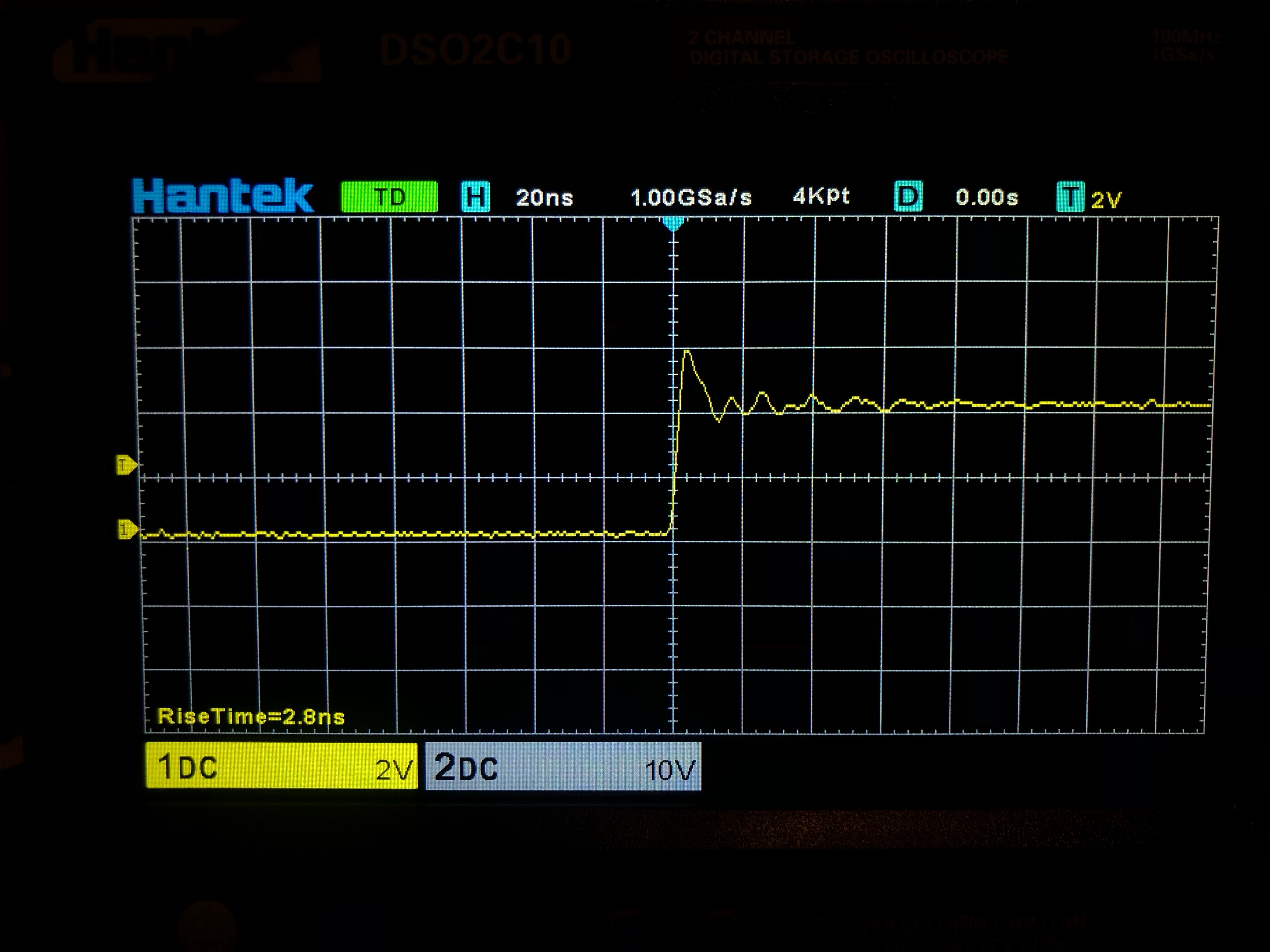

I've taken another measurement after calibrating my scope and changing to 10x attenuation and am now getting a steady reading of ~3ns on the rise -- which seems more in line with what should be happening.
Δt=CΔV*I = 20 pF * 3 * 20 mA -> 3 ns (from: https://electronics.stackexchange.com/q ... s-on-esp32)
Am I off base with thinking this is reasonable, or is the probe still interfering? I am new to electronics, so any explanation is appreciated.
Thanks

I mean, your scope probe will always have some capacitance. As the rise time effectively is determined by how fast the mosfets in the GPIO can pump energy into the combined capacitances of the GPIO pad and whatever is attached to it (like your scope probe plus the scope it's connected to), attachingyour scope probe is almost by definition going to result in a larger rise time. (How much depends on the impedance seen by something attached to the scope probe, whose effects as you noticed will be less if you switch the probe into x10 mode)
