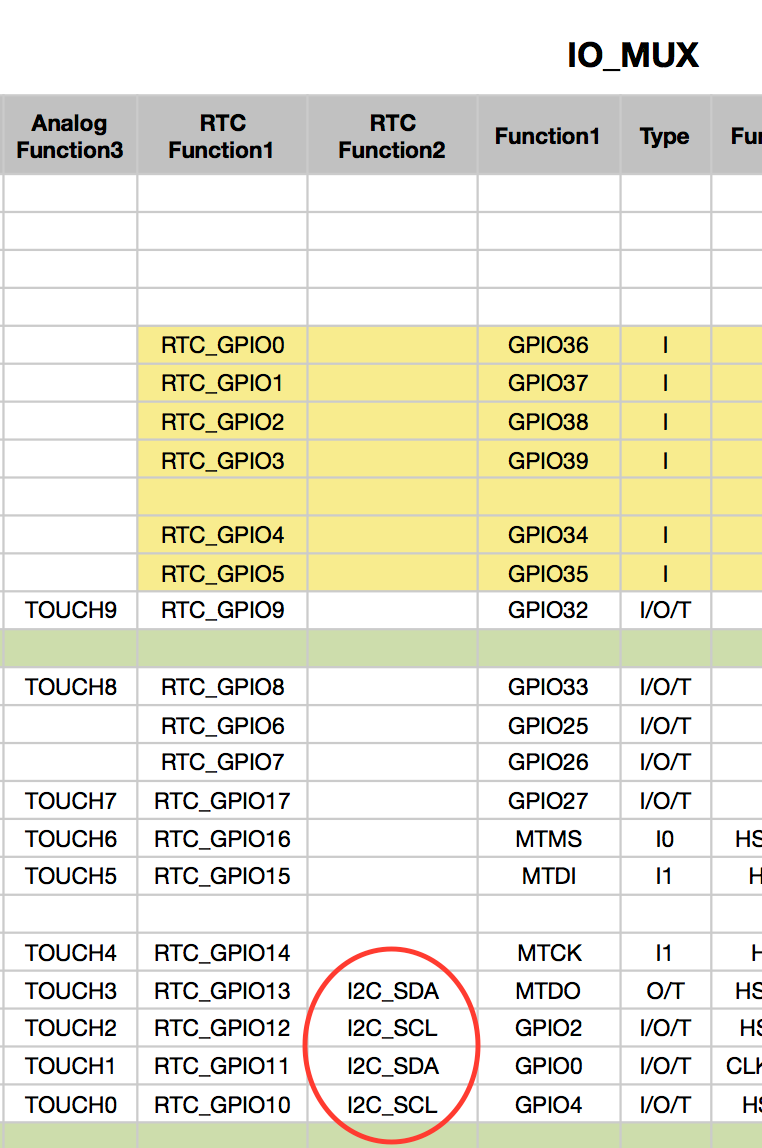

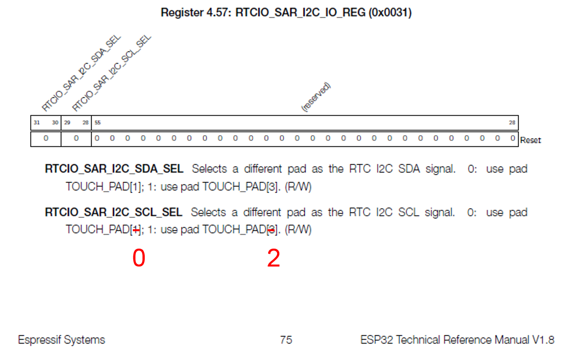

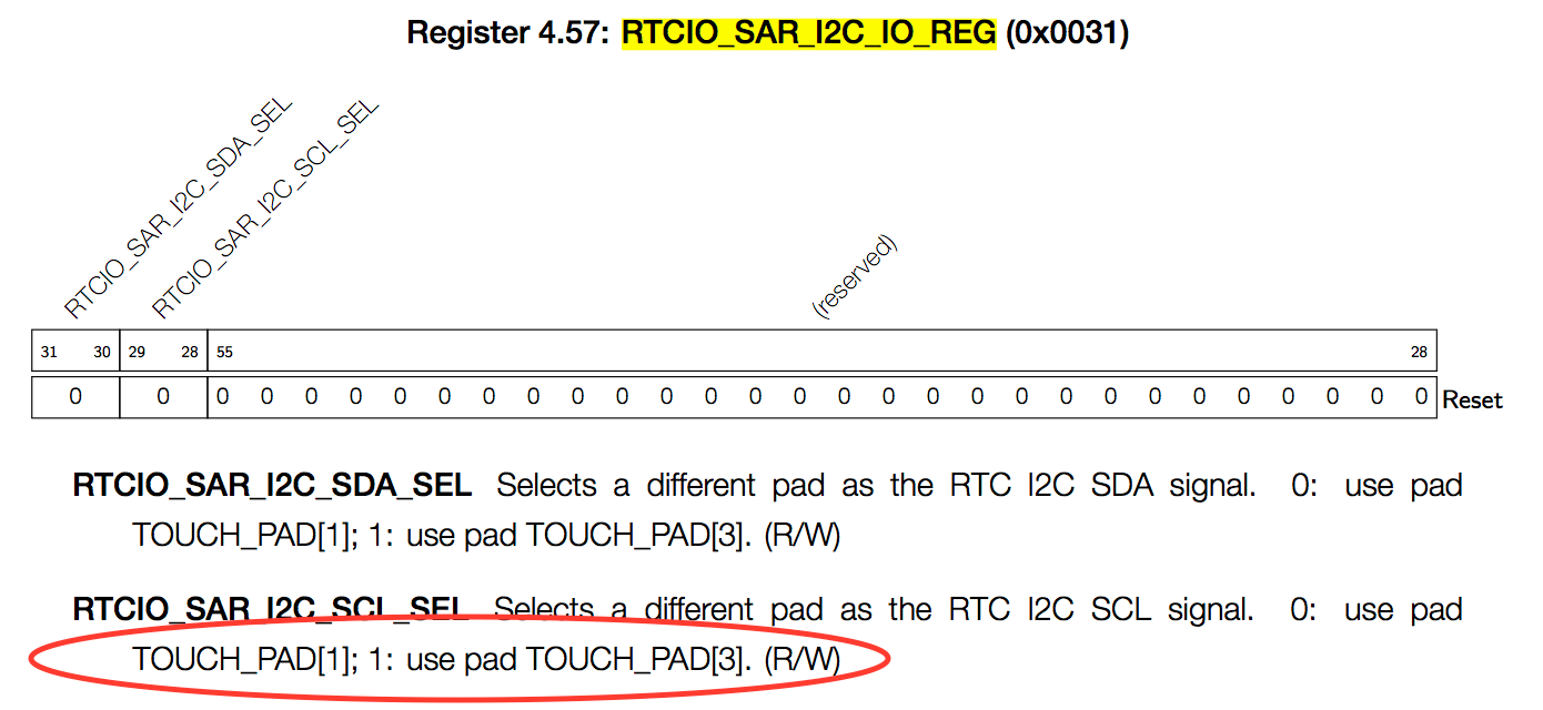

Is my assumption correct that the written down pinout of the RTC I2C Controller pins is correct in the datasheet V1.5 and that it is a copy and past error in the register description in the Technical References Manual V1.8 only?

@q2222ch,
Well spotted!
Here is correction I confirmed with Espressif's documentation team:
rtcio_sar_i2c_io_reg correction.png (209.4 KiB) Viewed 5932 times
