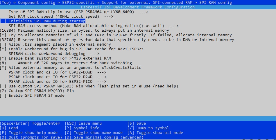

Hi All,
i have added psram to my esp32 board with piggyback approach.
i successfully enable the psram support in the menuconfig but i not able to enable:
[ ] Initialize SPI RAM during startup. in menuconfig.
Below are the boot result when the option was disabled:

D (1038) FLASH_HAL: extra_dummy: 1
V (1041) memspi: raw_chip_id: 164020
V (1045) memspi: chip_id: 204016
V (1048) memspi: raw_chip_id: 164020
V (1052) memspi: chip_id: 204016
D (1055) spi_flash: trying chip: issi
D (1059) spi_flash: trying chip: gd
D (1063) spi_flash: trying chip: mxic
D (1067) spi_flash: trying chip: winbond
D (1070) spi_flash: trying chip: generic
I (1074) spi_flash: detected chip: generic
I (1079) spi_flash: flash io: dio
W (1083) spi_flash: Detected size(4096k) larger than the size in the binary image header(2048k). Using the size in the binary image header.
D (1096) cpu_start: calling init function: 0x400d5e54
D (1102) cpu_start: calling init function: 0x400d0be0
V (1107) intr_alloc: esp_intr_alloc_intrstatus (cpu 0): checking args
V (1113) intr_alloc: esp_intr_alloc_intrstatus (cpu 0): Args okay. Resulting flags 0xC0E
D (1122) intr_alloc: Connected src 17 to int 2 (cpu 0)
D (1127) efuse: coding scheme 0
D (1130) efuse: In EFUSE_BLK0__DATA3_REG is used 1 bits starting with 15 bit
D (1137) efuse: coding scheme 0
D (1140) efuse: In EFUSE_BLK0__DATA5_REG is used 1 bits starting with 20 bit
V (1147) intr_alloc: esp_intr_alloc_intrstatus (cpu 0): checking args
V (1154) intr_alloc: esp_intr_alloc_intrstatus (cpu 0): Args okay. Resulting flags 0x40E
D (1162) intr_alloc: Connected src 24 to int 3 (cpu 0)
I (1167) cpu_start: Starting scheduler on PRO CPU.
D (0) efuse: coding scheme 0
D (0) efuse: In EFUSE_BLK0__DATA3_REG is used 1 bits starting with 15 bit
D (10) efuse: In EFUSE_BLK0__DATA5_REG is used 1 bits starting with 20 bit
V (10) intr_alloc: esp_intr_alloc_intrstatus (cpu 1): checking args
V (20) intr_alloc: esp_intr_alloc_intrstatus (cpu 1): Args okay. Resulting flags 0x40E
D (30) intr_alloc: Connected src 25 to int 2 (cpu 1)
I (30) cpu_start: Starting scheduler on APP CPU.
D (1257) heap_init: New heap initialised at 0x3ffe0440
D (1257) heap_init: New heap initialised at 0x3ffe4350
I (1267) spiram: Reserving pool of 32K of internal memory for DMA/internal allocations
D (1277) spiram: Allocating block of size 32768 bytes
V (1277) intr_alloc: esp_intr_alloc_intrstatus (cpu 0): checking args
V (1277) intr_alloc: esp_intr_alloc_intrstatus (cpu 0): Args okay. Resulting flags 0xE
D (1277) intr_alloc: Connected src 16 to int 9 (cpu 0)
I (1297) gpio: GPIO[2]| InputEn: 0| OutputEn: 0| OpenDrain: 0| Pullup: 1| Pulldown: 0| Intr:0
heap size: 417635
free heap: 257480
malloc cap 8bit: 288095
malloc free psram: 0
psram size: 0
Test code to check the RAM size:
printf("heap size: %d\n", info.total_free_bytes + info.total_allocated_bytes);
printf("free heap: %d\n", esp_get_free_heap_size());
printf("malloc cap 8bit: %d\n", heap_caps_get_free_size(MALLOC_CAP_8BIT));
printf("malloc free psram: %d\n", heap_caps_get_free_size(MALLOC_CAP_SPIRAM));
multi_heap_info_t info1;
heap_caps_get_info(&info1, MALLOC_CAP_SPIRAM);
printf("psram size: %d\n", info1.total_free_bytes + info1.total_allocated_bytes);
however when calling heap_caps_get_free_size(MALLOC_CAP_SPIRAM) the value are 0;
When enabled the Initialize SPI RAM during startup :
D (223) efuse: coding scheme 0
esp-idf/components/freertos/queue.c:1441 (xQueueSemaphoreTake)- assert failed!
Re-enable cpu cache.
abort() was called at PC 0x40089490 on core 0
Backtrace:0x4008827e:0x3ffe39c0 0x400889fd:0x3ffe39e0 0x4008d6c2:0x3ffe3a00 0x40089490:0x3ffe3a70 0x4008d5c5:0x3ffe3ab0 0x400e8e1f:0x3ffe3ad0 0x4008d57f:0x3ffe3b00 0x400d8117:0x3ffe3b50 0x400d8005:0x3ffe3bb0 0x400d7fc1:0x3ffe3bd0 0x4008367c:0x3ffe3c00 0x400d5369:0x3ffe3c30 0x4008124c:0x3ffe3c50 0x40079231:0x3ffe3c80 |<-CORRUPTED
ELF file SHA256: b0658467dc0a9b5f
Rebooting...
1. i not sure if the psram are correctly detected, am i on the correct path? what is missing? how do i get the psram to work?
2. currently on GPIO 16 and 17, can i use gpio 6 and gpio11 instead of gpio 16 and 17?
3. can i use vspi port instead of the piggyback port? i have vspi port unused. need change custom port in menuconfig?
edit:
update: i have try to use wrover devkit modules with the same result.
