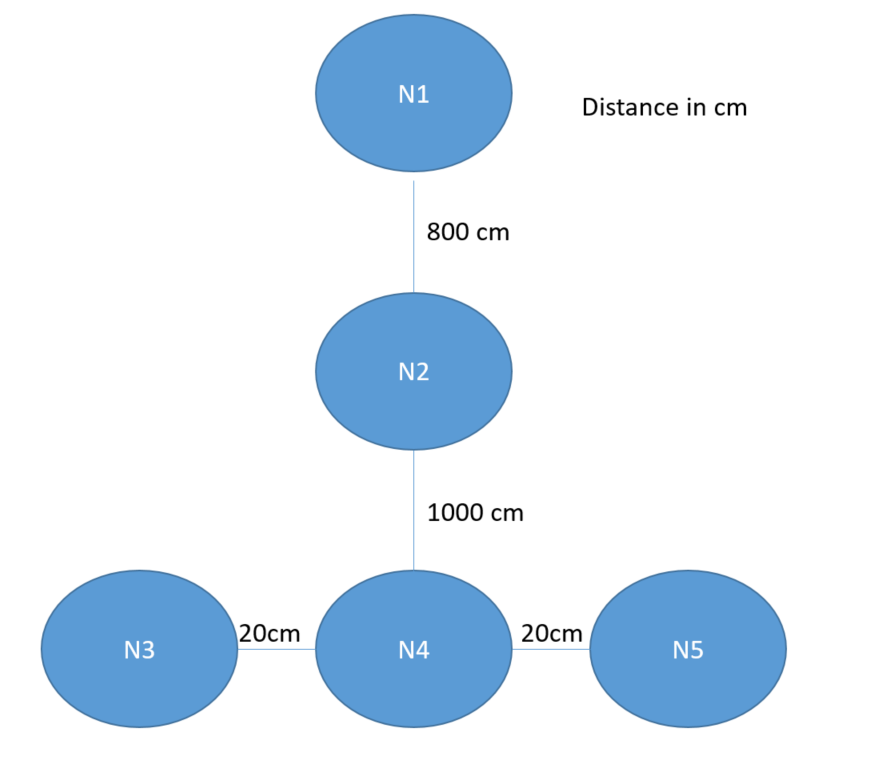

I'm working with several ESP32 connected in a wifi mesh.
Now I have 5 nodes ( N1,N2,N3,N4,N5) connected in this way:
Root(N1)
L2 ( N2,N3,N4 )
L3 ( N5)
Regarding position and distance:
I thought that N3, N4 will be connected to N5.
I found that is it possible to set variables in order to tell nodes to change the parent if RSSI is greater or lower than a reference.
Here is the link: https://github.com/espressif/esp-idf/bl ... internal.h
I think I have to set:
typedef struct {
    int duration_ms;   /* parent weak RSSI monitor duration, if the RSSI continues to be weak during this duration_ms,
                          device will search for a new parent. */
    int cnx_rssi;      /* RSSI threshold for keeping a good connection with parent.
                          If set a value greater than -120 dBm, a timer will be armed to monitor parent RSSI at a period time of duration_ms. */
    int select_rssi;   /* RSSI threshold for parent selection. It should be a value greater than switch_rssi. */
    int switch_rssi;   /* Disassociate with current parent and switch to a new parent when the RSSI is greater than this set threshold. */
    int backoff_rssi;  /* RSSI threshold for connecting to the root */
} mesh_switch_parent_t;
select_rssi and switch_rssi, correct ?
Do I also have to set:
typedef struct {
    int high;
    int medium;
    int low;
} mesh_rssi_threshold_t;
How are this variables related?
Hope my question is clear enough
Thanks
