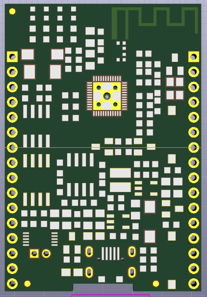

Postby rudi ;-) » Wed Jun 21, 2017 6:53 pm
hi guys
brand new -
ESP32-PRO new IoT board with 4MB external RAM, 4MB external Flash, external crypto engine, LiPo charger
look at olimex blogs for more details.
this is Open Hardware and Software and you find the shematic on github
this ESP32-Pro is a combine with PIC32,
PIC32MX270F256DT.pdf
(2.89 MiB) Downloaded 1127 times
comes with USB-OTG, USB-Device and more.
also there is crypto chip from MC ATECC508A for P2P, M2M and other secure IoT projects.

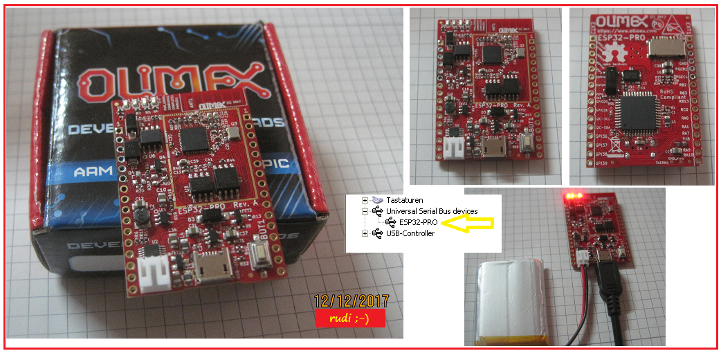

Postby rudi ;-) » Tue Dec 12, 2017 4:50 pm
hi guys
next week is X-Mas -- and we celebrate few days earlier -
got it ;)
on weekend more details - just in time unpacking and few testings.
