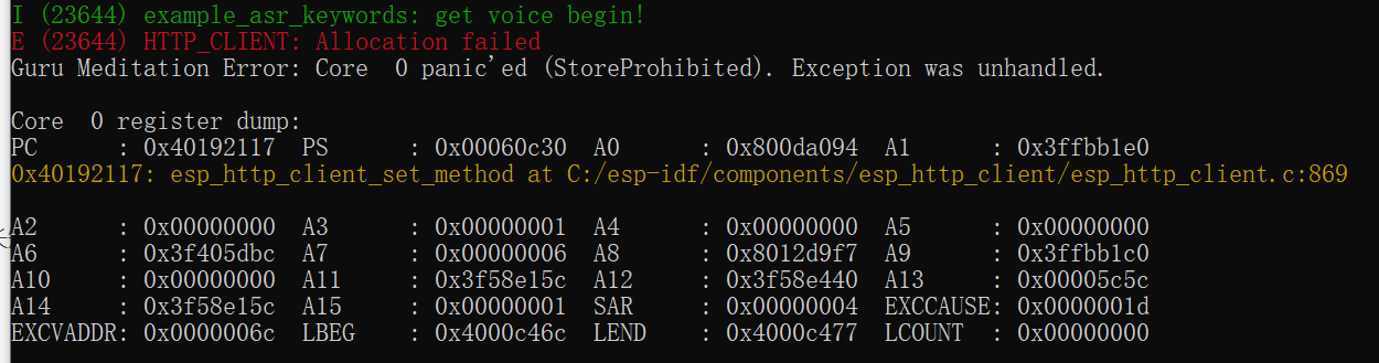

使用ESP32-LyraTD-MSC做文字转语音,
再上传语音buffer时,总是宕机。困扰一天也不能解决。
1.分配内存
int num = 3;
int sz = 8 * num * 1024 * sizeof(char);
int sz1 = 8 * (num+1) * 1024 * sizeof(char);
char *buff = (char *)malloc(sz);
if (NULL == buff) {
ESP_LOGE(TAG, "Memory allocation failed!");
memset(buff, 0, sz);
int max_len = 1 * 1024;
char *data = (char *)malloc(max_len);
memset(data, 0, max_len);
2.在语音唤醒后,启动录音
while (1)
if (enable_wn) {
raw_stream_read(raw_read, (char *)buffer, size * sizeof(short));
if (wakenet->detect(model_wn_data, (int16_t *)buffer) == WAKE_UP) {
ESP_LOGI(TAG, "wake up");
enable_wn = false;
else
ESP_LOGI(TAG, "get voice begin!");
esp_http_client_config_t config = {
.url = baidu_asr_url,
.event_handler = _http_event_handler,
.buffer_size = sz1,
.buffer_size_tx = sz1,
esp_http_client_handle_t client = esp_http_client_init(&config);
esp_http_client_set_method(client, HTTP_METHOD_POST);
esp_http_client_set_post_field(client, (const char *)buff, sz);
esp_http_client_set_header(client, "Content-Type", "audio/pcm;rate=16000");
memset(temp, 0, 128);
snprintf(temp, 128, "%d", sz);
esp_http_client_set_header(client, "Content-Length", temp);
while (1) {
err = esp_http_client_perform(client);
if (err != ESP_ERR_HTTP_EAGAIN) {
break;
if (err == ESP_OK) {
ESP_LOGI(TAG, "HTTPS Status = %d, content_length = %d",
esp_http_client_get_status_code(client),
esp_http_client_get_content_length(client));
} else {
ESP_LOGE(TAG, "Error perform http request %s", esp_err_to_name(err));
esp_http_client_cleanup(client);
enable_wn = true;

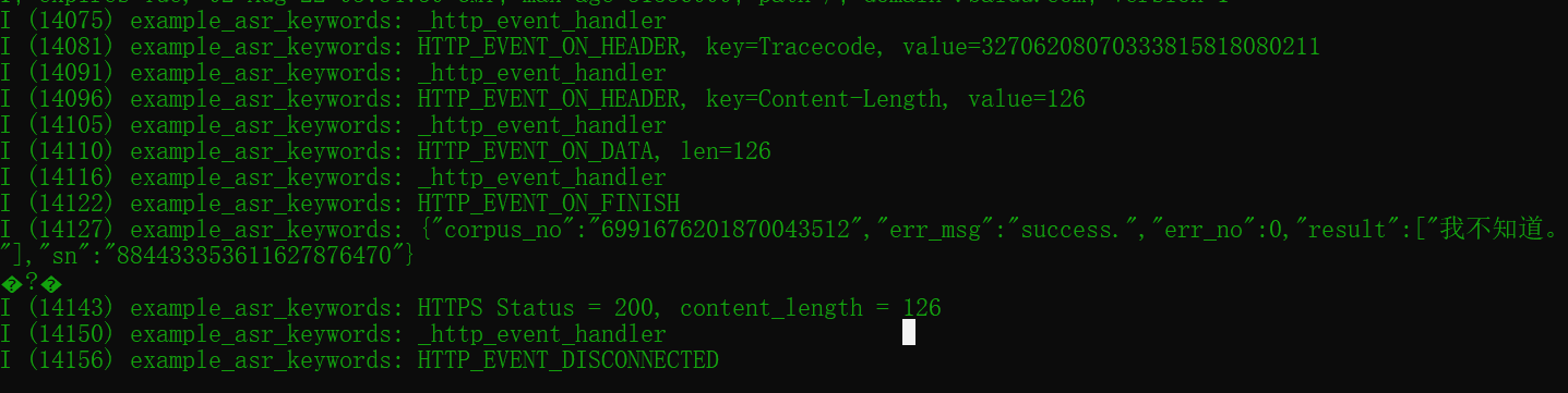

3.困惑:
变量num 决定了要录音的时间长短,数值为3可以运行,结果如附件3
改为6无法运行,内存分配首先失败了,结果如附件2
4.问题:
如何做一个大的buffer的Post请求?官方如何解决上传语音数据,文字转语音的问题。(网上的有的教程基于早期版本,代码已经无法运行了)

经过千辛万苦努力,终于可以了。
.buffer_size = 2048,
.buffer_size_tx = 2048,
这里参数之前填错了。
