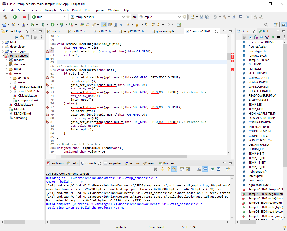

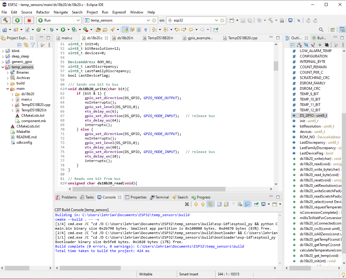

I am writing some code for a OneWire device and have it working fine in C. However I would like to change it to be a class in C++ and I have it compiling fine but Eclipse is showing errors that I can't make go away. Here is the IDE showing the function in a C file:
And here is the IDE showing the exact same code except it is now in a C++ method:
The error it shows when I hover over the first marker in the begin method is:
Problem description: Invalid arguments ' Candidates are: void gpio_pad_select_gpio(unsigned char) '
The error is shows when I hover of the second marker in the write method is:
Problem description: Invalid arguments ' Candidates are: int gpio_set_direction (enum {C:\Users\lehrian\Documents\esp-idf\components\hal\include\hal\gpio_types.h:7814}, enum {C:\Users\lehrian\Documents\esp-idf\components\hal\include\hal\gpio_types.h: 20385}) '
The rest of the error markers show very similar error descriptions. I had to cast
(gpio_num_t)this->DS_GPIO
because the function is expecting an enum not an int and the cpp compiler, which is more picky about method signatures, threw an error. Once I cast it the code compiled just fine but Eclipse continues to complain about it. Any ideas why Eclipse would be complaining about the code in the C++ file but be completely fine with the same code in a C file?

UPDATE: It seems that the inclusion of
#include <freertos/FreeRTOS.h>
Is what is causing the issue. If I comment this include out the markers in Eclipse go away, but, because my code depends on this include, my code will not compile.

So I figured out a work around. It seems that if I move the import of gpio.h above FreeRTOS.h the error markers in Eclipse go away.
#include <driver/gpio.h>
#include "TestClass.h"
TestClass::TestClass(uint8_t pin){
	this->gpio=pin;
void TestClass::testMethod(){
	gpio_pad_select_gpio((unsigned char)this->gpio);
