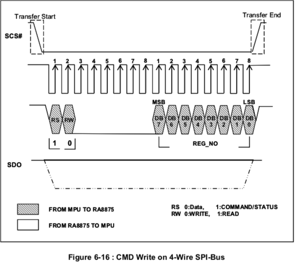

I'm want esp32 to communicate to RA8875 (TFT display controller) via SPI 4 wires.
RA8875 datasheet shows SPI CPOL = high and CPHA = 1
I can initialise and add device to bus, here's the log
I (355) DisplayTFT: ... Initializing bus.
I (355) DisplayTFT: ... Adding device bus.
When I try to use
Code: Untitled.c Select all
ret = spi_device_transmit(spi, &t);
got this
E (455) spi_master: check_trans_valid(661): invalid dev handle
I (455) DisplayTFT: LCD_CmdWrite ESP_ERR_INVALID_ARG
Here's the code
Screen Shot 2021-08-20 at 16.36.00.png (75.43 KiB) Viewed 3447 times

If I were you and wanted to control such display in some reasonable way, I would, rather than crafting my own, focus on using some ready made graphics library such as LVGL. It is ported for ESP32 and supports your RA8875 controller.
fasani
Posts: 197
Joined: Wed Jan 30, 2019 12:00 pm
Location: Barcelona
Contact:
Re: SPI Master
Postby fasani » Sun Aug 22, 2021 8:06 pm
I second Victoria recommendation here. I would also like to mention, that many SPI peripherals, need a reset before starting communication.
I checked the ra8875 in LVGL and has one, a part of a memory clear, maybe that's something you need to do additionally before sending your SPI commands.
