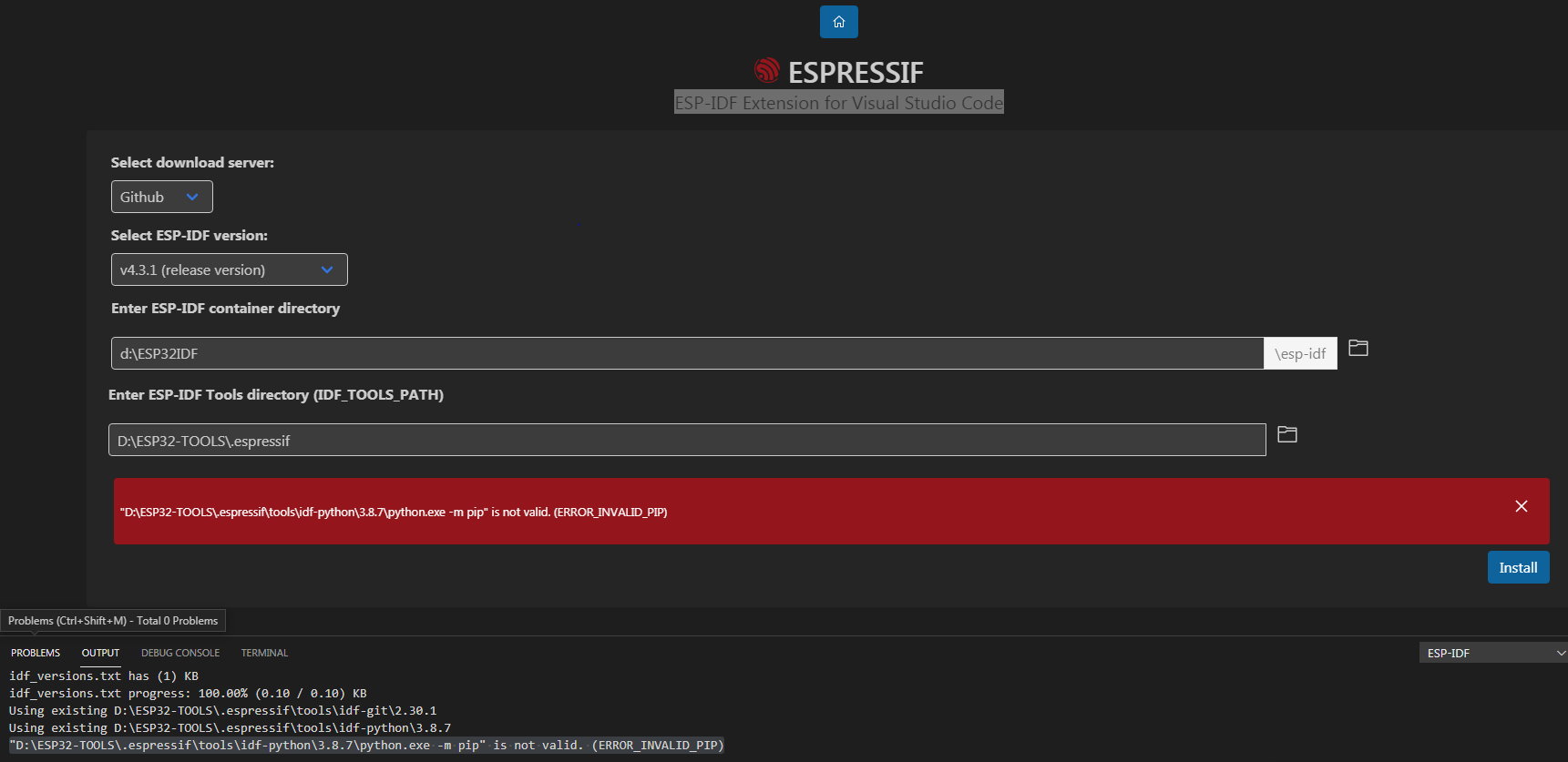

hi,
i am newbie to the ESP32 and VS Code,
i got installation problem :
"D:\ESP32-TOOLS\.espressif\tools\idf-python\3.8.7\python.exe -m pip" is not valid. (ERROR_INVALID_PIP)
have tried several times, but with the same result...
can anyone give some suggestions what to do?
thank you.....

Hi! Just install pip(https://pip.pypa.io/en/stable/installation/). It solve problem.

Delete idf-git and the idf-python folder from the *:\Espressif\tools directory and try again。
Thanks,you're right! :D

i used this link for downloading or pasting same file as anyname.py in same folder.
https://bootstrap.pypa.io/get-pip.py
then executed the same code in the cmd promt
C:\Espressif\tools\idf-python\3.11.2\python.exe getpip2.py
