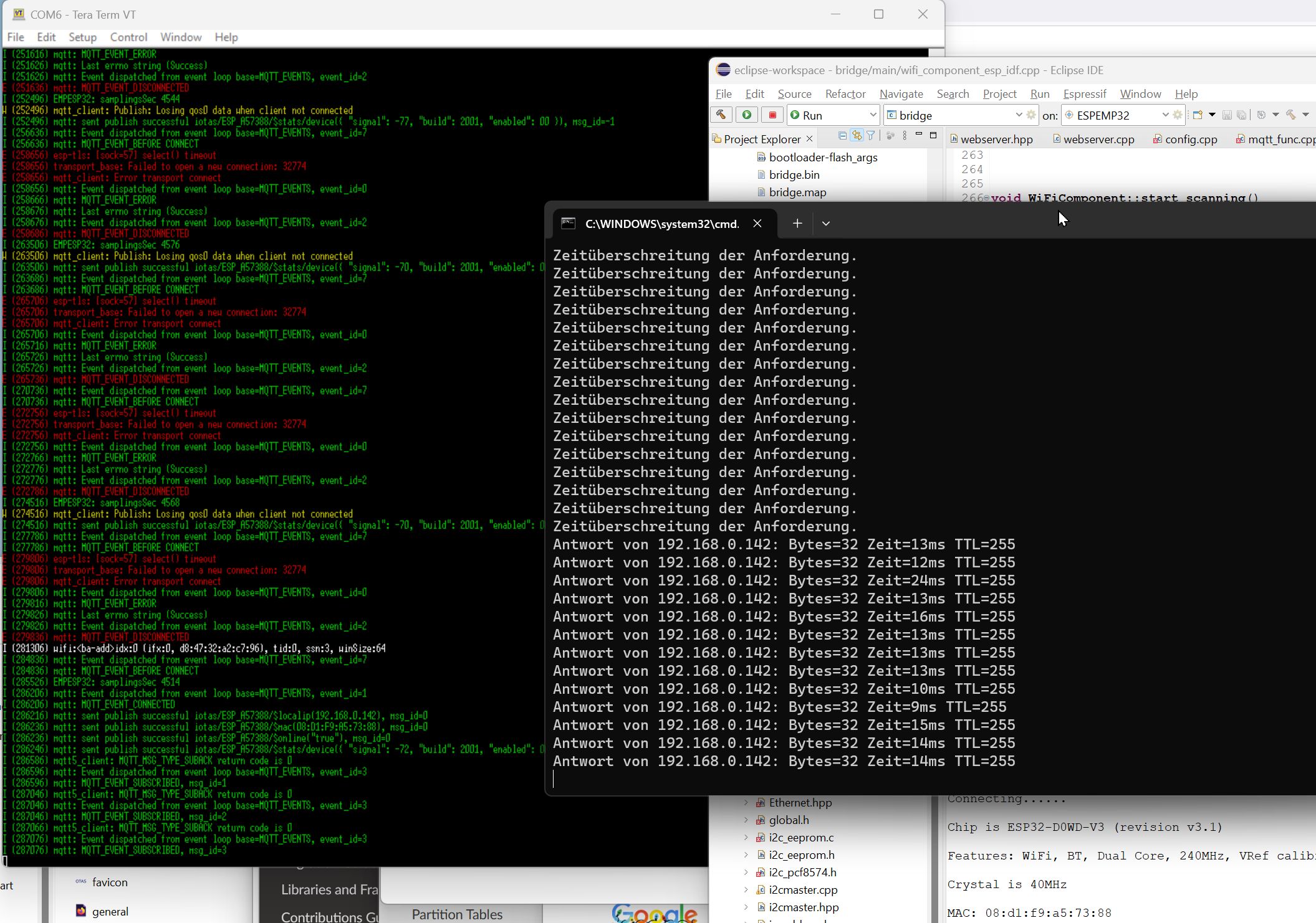

Hi ESP-Lovers!
I have a Wifi issue that seems to be related with the QOS negotation.
Although wifi is being reported as connected (including wifi_sta_connect_status_() == WiFiSTAConnectStatus::CONNECTED so the gotIp Event has been tracked) I am unable to use TCP communication UNTIL the wifi:<ba-add> ..... has been emitted.

Edit: I forgot to mention:
ESP32-D0WD-V3 (revision v3.11)
esp-idf-v5.1.2
Attached screenshot showing that tcp-stack is NOT available until the <ba-add> info/warning appears.
That means sometimes it takes several minutes :-(
<ba-add> vs connectivity
ViennaTom
Posts: 5
Joined: Tue Dec 19, 2023 9:19 pm
Re: What is the meaning of this warning "wifi: <ba-add>idx ..."?
Postby ViennaTom » Mon Jan 01, 2024 2:33 pm
The issue was resolved.
I did not realize, that the ESP connected to another router within my MESH like network from time to time.
I included the bssid in the AP-config and now it works as expected.
