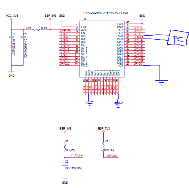

Hoewer i'm having troubles flashing my ESP32-S2-SOLO module with ESP32 Arduino 2.0.1 RC1.
This is the current schematic:
I have the following error (The invalid head of packet is not constant):
C:\Users\wontg\AppData\Local\Arduino15\packages\esp32\tools\esptool_py\3.1.0/esptool.exe --chip esp32s2 --port COM10 --baud 115200 --before default_reset --after hard_reset write_flash -z --flash_mode dio --flash_freq 80m --flash_size 4MB 0xe000 C:\Users\wontg\AppData\Local\Arduino15\packages\esp32\hardware\esp32\2.0.1-RC1/tools/partitions/boot_app0.bin 0x1000 C:\Users\wontg\AppData\Local\Temp\arduino_build_114974/test_esp32s2.ino.bootloader.bin 0x10000 C:\Users\wontg\AppData\Local\Temp\arduino_build_114974/test_esp32s2.ino.bin 0x8000 C:\Users\wontg\AppData\Local\Temp\arduino_build_114974/test_esp32s2.ino.partitions.bin
esptool.py v3.1
Serial port COM10
A fatal error occurred: Failed to connect to ESP32-S2: Invalid head of packet (0x12)
Here is the serial output when reseting with GPIO0 to GND:

I have some great news, the UART0 flash still doesn't work but I tried the USB programming with GPIO 19 / GPIO 20 and it worked the first time :D !
