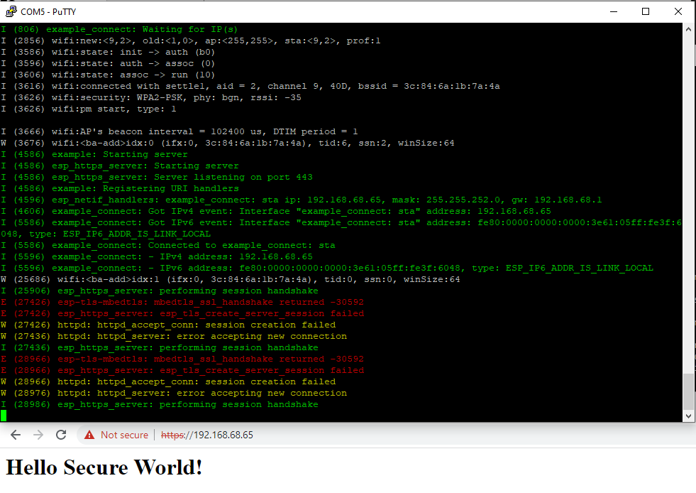

examples\protocols\https_server\simple 不工作
gavinl
Posts: 24
Joined: Fri Oct 22, 2021 5:53 pm
Postby gavinl » Tue Oct 26, 2021 1:46 pm
请帮忙, 浏览器显示: Header fields are too long for server to interpret

I (4583) example: Starting server
I (4583) esp_https_server: Starting server
I (4583) esp_https_server: Server listening on port 443
I (4583) example: Registering URI handlers
I (4593) esp_netif_handlers: example_connect: sta ip: 192.168.68.65, mask: 255.2 55.252.0, gw: 192.168.68.1
I (4603) example_connect: Got IPv4 event: Interface "example_connect: sta" addre ss: 192.168.68.65
I (5583) example_connect: Got IPv6 event: Interface "example_connect: sta" address: fe80:0000:0000:0000:3e61:05ff:fe3f:6048, type: ESP_IP6_ADDR_IS_LINK_LOCAL
I (5583) example_connect: Connected to example_connect: sta
I (5593) example_connect: - IPv4 address: 192.168.68.65
I (5593) example_connect: - IPv6 address: fe80:0000:0000:0000:3e61:05ff:fe3f:6048, type: ESP_IP6_ADDR_IS_LINK_LOCAL
W (12733) wifi:<ba-add>idx:1 (ifx:0, 3c:84:6a:1b:7a:4a), tid:0, ssn:0, winSize:64
I (12843) esp_https_server: performing session handshake
E (14533) esp-tls-mbedtls: mbedtls_ssl_handshake returned -0x7780
E (14533) esp_https_server: esp_tls_create_server_session failed
W (14543) httpd: httpd_accept_conn: session creation failed
W (14543) httpd: httpd_server: error accepting new connection
I (14553) esp_https_server: performing session handshake
E (16283) esp-tls-mbedtls: mbedtls_ssl_handshake returned -0x7780
E (16283) esp_https_server: esp_tls_create_server_session failed
W (16283) httpd: httpd_accept_conn: session creation failed
W (16293) httpd: httpd_server: error accepting new connection
I (22873) esp_https_server: performing session handshake
E (24583) esp-tls-mbedtls: mbedtls_ssl_handshake returned -0x7780
E (24583) esp_https_server: esp_tls_create_server_session failed
W (24583) httpd: httpd_accept_conn: session creation failed
W (24593) httpd: httpd_server: error accepting new connection
I (24603) esp_https_server: performing session handshake
E (26333) esp-tls-mbedtls: mbedtls_ssl_handshake returned -0x7780
E (26333) esp_https_server: esp_tls_create_server_session failed
W (26343) httpd: httpd_accept_conn: session creation failed
W (26343) httpd: httpd_server: error accepting new connection
I (26353) esp_https_server: performing session handshake
W (28933) httpd_parse: parse_block: request URI/header too long
W (28933) httpd_txrx: httpd_resp_send_err: 431 Request Header Fields Too Large - Header fields are too long for server to interpret
I (29013) esp_https_server: performing session handshake
E (30723) esp-tls-mbedtls: mbedtls_ssl_handshake returned -0x7780
E (30723) esp_https_server: esp_tls_create_server_session failed
W (30723) httpd: httpd_accept_conn: session creation failed
W (30723) httpd: httpd_server: error accepting new connection
I (30733) esp_https_server: performing session handshake
W (33343) httpd_parse: parse_block: request URI/header too long
W (33343) httpd_txrx: httpd_resp_send_err: 431 Request Header Fields Too Large - Header fields are too long for server to interpret
I (64033) esp_https_server: performing session handshake
E (65743) esp-tls-mbedtls: mbedtls_ssl_handshake returned -0x7780
E (65743) esp_https_server: esp_tls_create_server_session failed
W (65753) httpd: httpd_accept_conn: session creation failed
W (65753) httpd: httpd_server: error accepting new connection
I (65763) esp_https_server: performing session handshake
E (67463) esp-tls-mbedtls: mbedtls_ssl_handshake returned -0x7780
E (67463) esp_https_server: esp_tls_create_server_session failed
W (67473) httpd: httpd_accept_conn: session creation failed
W (67473) httpd: httpd_server: error accepting new connection
I (91483) esp_https_server: performing session handshake
E (93193) esp-tls-mbedtls: mbedtls_ssl_handshake returned -0x7780
E (93203) esp_https_server: esp_tls_create_server_session failed
W (93203) httpd: httpd_accept_conn: session creation failed
W (93203) httpd: httpd_server: error accepting new connection
I (93213) esp_https_server: performing session handshake
E (94953) esp-tls-mbedtls: mbedtls_ssl_handshake returned -0x7780
E (94953) esp_https_server: esp_tls_create_server_session failed
W (94953) httpd: httpd_accept_conn: session creation failed
W (94963) httpd: httpd_server: error accepting new connection
I (94973) esp_https_server: performing session handshake
E (96733) esp-tls-mbedtls: mbedtls_ssl_handshake returned -0x7280
E (96733) esp_https_server: esp_tls_create_server_session failed
W (96743) httpd: httpd_accept_conn: session creation failed
W (96743) httpd: httpd_server: error accepting new connection
I (125893) esp_https_server: performing session handshake
W (129233) httpd_parse: parse_block: request URI/header too long
W (129233) httpd_txrx: httpd_resp_send_err: 431 Request Header Fields Too Large - Header fields are too long for server to interpret
I (129333) esp_https_server: performing session handshake
E (131083) esp-tls-mbedtls: mbedtls_ssl_handshake returned -0x7780
E (131083) esp_https_server: esp_tls_create_server_session failed
W (131083) httpd: httpd_accept_conn: session creation failed
W (131093) httpd: httpd_server: error accepting new connection
I (131093) esp_https_server: performing session handshake
W (133983) httpd_parse: parse_block: request URI/header too long
W (133983) httpd_txrx: httpd_resp_send_err: 431 Request Header Fields Too Large - Header fields are too long for server to interpret
I (167783) esp_https_server: performing session handshake
E (169493) esp-tls-mbedtls: mbedtls_ssl_handshake returned -0x7780
E (169493) esp_https_server: esp_tls_create_server_session failed
W (169503) httpd: httpd_accept_conn: session creation failed
W (169503) httpd: httpd_server: error accepting new connection
I (169513) esp_https_server: performing session handshake
E (171243) esp-tls-mbedtls: mbedtls_ssl_handshake returned -0x7780
E (171243) esp_https_server: esp_tls_create_server_session failed
W (171253) httpd: httpd_accept_conn: session creation failed
W (171253) httpd: httpd_server: error accepting new connection
I (171263) esp_https_server: performing session handshake
E (173103) esp-tls-mbedtls: mbedtls_ssl_handshake returned -0x7280
E (173103) esp_https_server: esp_tls_create_server_session failed

我更改了 Max HTTP Request Header Length=2048, Max HTTP URI Length=2048 ,它可以显示“Hello Secure World!”,但是它有两个握手错误,我尝试在所有组件源代码树中搜索 30592 或 hex 7780 ,但找不到。
有没有人可以帮助找到如何解决这个错误? 谢谢!

服务器端的 CA 证书不是受信任的,所以浏览器端发送了 Alert,浏览器侧选择了允许非受信任的连接就可以继续访问了,不影响。
