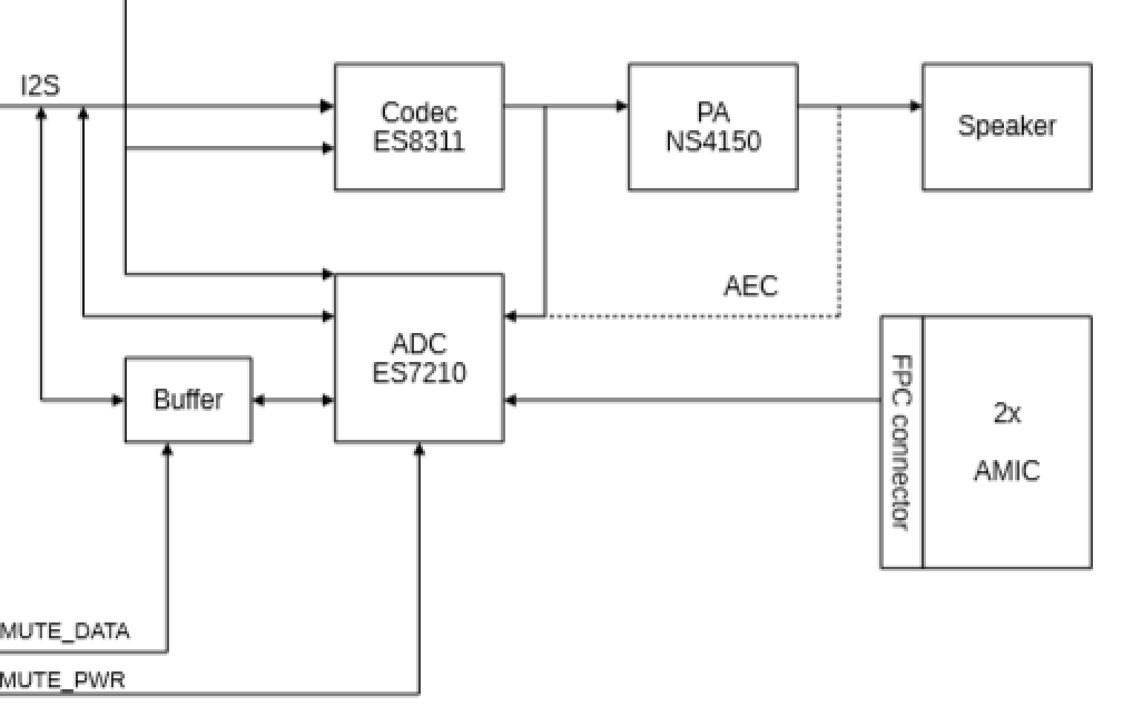

Hi just out of curiosity but why does the ESP32-S3-BOX have 2x analogue mems -> ADC -> I2S whilst I2S mems would seem to cut out the need for an additional ADC?
I actually quite like the idea of the ADC as unidirectional electrets can help with near AEC but curious as it all seems hardwired or do the spare channels on the ADC have traces for alternative input?
Re: ESP-BOX options?
1. Digital microphones can save an ADC chip, but their gain is generally not adjustable.
2. Dual microphones are used for speech recognition, an additional ADC channel is used to capture the output of the DAC (speaker) for echo cancellation (although it is currently not turned on for some reason). the standard I2S protocol cannot capture 3 channels, and As a 4-channel ADC, ES7210 can use TDM mode to expand up to 16 channels, or combine ADC1/3 to left channel and ADC2/4 to right channel.

Thanks Yu_Zhe still confused at the gain as why not software?

But to be honest why its connected to the dac of a signal you have sent to the dac has me even more confused?

1. Since the internal ADC resolution of the digital microphone is fixed, software amplification will cause small signal distortion
2. The output of ES8311 is not only connected to the audio PA, but also connected to the third channel of the audio ADC ES7210 for echo cancellation.
[img][/ESP32-S3-BOX_Block_Diagram.png]
- ESP32-S3-BOX Block Diagram
- ESP32-S3-BOX_Block_Diagram.png (23.07 KiB) Viewed 60691 times

Still slightly confused as usually its the speaker itself that provides most distortion where usually a non-linear alg helps correct things.
I guess it will pick up the distortion of both amp and ADC and my lack of knowledge always made me think that was minimal and not seen before, say if you take a non-linear AEC like speex, where its clock drift and sync that are important which I guess it does also.
I suppose Espressif have never considered doing a ES8311/ES7210 daughter board? The rest of the s3-korvo-2 board for me is redundant cost really with the awkwardness of the fixed mics.
