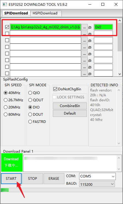

Windows download tool
1. Tool: https://www.espressif.com/zh-hans/suppo ... ther-tools
2. burn address: 0x0
3. burn guide:
