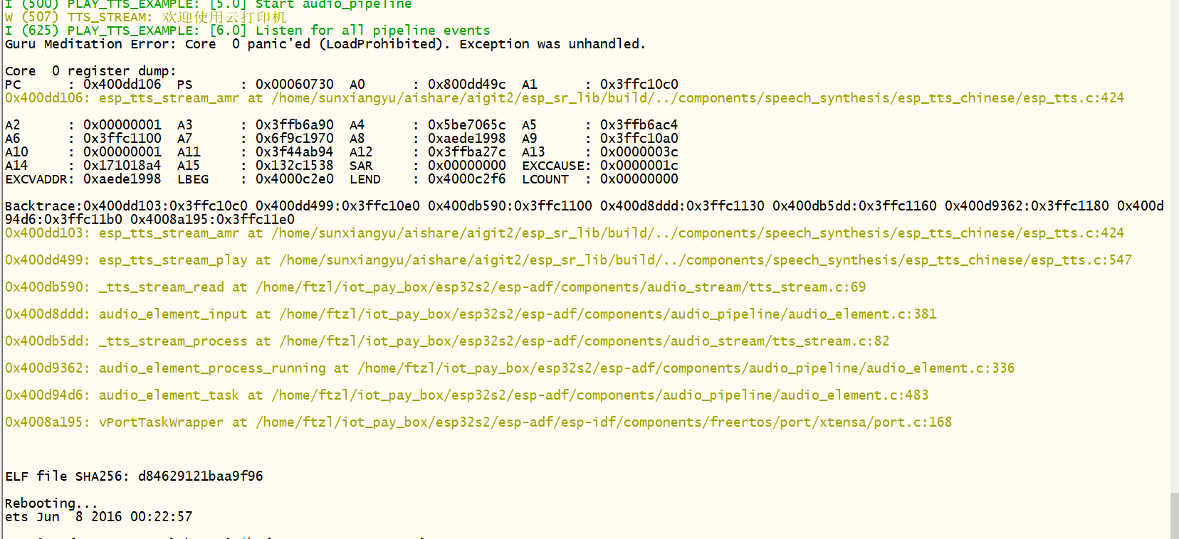

开发板:ESP32-Lyrat-mini -V1.2
SDK版本:adf:V2.2
idf:V4.3
使用例程:
esp-adf\examples\player\pipeline_tts_stream
问题现象:
1)播报短的内容没问题,例如“欢迎使用”
2)播报长的内容,会出现无线重启播报现象,log如下:
W (507) TTS_STREAM: 欢迎使用云打印机
I (625) PLAY_TTS_EXAMPLE: [6.0] Listen for all pipeline events
Guru Meditation Error: Core 0 panic'ed (LoadProhibited). Exception was unhandled.
Core 0 register dump:
PC : 0x400dd106 PS : 0x00060730 A0 : 0x800dd49c A1 : 0x3ffc10c0
0x400dd106: esp_tts_stream_amr at /home/sunxiangyu/aishare/aigit2/esp_sr_lib/build/../components/speech_synthesis/esp_tts_chinese/esp_tts.c:424
A2 : 0x00000001 A3 : 0x3ffb6a90 A4 : 0x5be7065c A5 : 0x3ffb6ac4
A6 : 0x3ffc1100 A7 : 0x6f9c1970 A8 : 0xaede1998 A9 : 0x3ffc10a0
A10 : 0x00000001 A11 : 0x3f44ab94 A12 : 0x3ffba27c A13 : 0x0000003c
A14 : 0x171018a4 A15 : 0x132c1538 SAR : 0x00000000 EXCCAUSE: 0x0000001c
EXCVADDR: 0xaede1998 LBEG : 0x4000c2e0 LEND : 0x4000c2f6 LCOUNT : 0x00000000
Backtrace:0x400dd103:0x3ffc10c0 0x400dd499:0x3ffc10e0 0x400db590:0x3ffc1100 0x400d8ddd:0x3ffc1130 0x400db5dd:0x3ffc1160 0x400d9362:0x3ffc1180 0x400d94d6:0x3ffc11b0 0x4008a195:0x3ffc11e0
0x400dd103: esp_tts_stream_amr at /home/sunxiangyu/aishare/aigit2/esp_sr_lib/build/../components/speech_synthesis/esp_tts_chinese/esp_tts.c:424
0x400dd499: esp_tts_stream_play at /home/sunxiangyu/aishare/aigit2/esp_sr_lib/build/../components/speech_synthesis/esp_tts_chinese/esp_tts.c:547
0x400db590: _tts_stream_read at /home/ftzl/iot_pay_box/esp32s2/esp-adf/components/audio_stream/tts_stream.c:69
0x400d8ddd: audio_element_input at /home/ftzl/iot_pay_box/esp32s2/esp-adf/components/audio_pipeline/audio_element.c:381
0x400db5dd: _tts_stream_process at /home/ftzl/iot_pay_box/esp32s2/esp-adf/components/audio_stream/tts_stream.c:82
0x400d9362: audio_element_process_running at /home/ftzl/iot_pay_box/esp32s2/esp-adf/components/audio_pipeline/audio_element.c:336
0x400d94d6: audio_element_task at /home/ftzl/iot_pay_box/esp32s2/esp-adf/components/audio_pipeline/audio_element.c:483
0x4008a195: vPortTaskWrapper at /home/ftzl/iot_pay_box/esp32s2/esp-adf/esp-idf/components/freertos/port/xtensa/port.c:168
ELF file SHA256: d84629121baa9f96
Rebooting...
ets Jun 8 2016 00:22:57
rst:0xc (SW_CPU_RESET),boot:0x1b (SPI_FAST_FLASH_BOOT)
configsip: 0, SPIWP:0xee
mode:DIO, clock div:1
load:0x3fff0030,len:7524
load:0x40078000,len:15048
load:0x40080400,len:4416
0x40080400: _init at ??:?
望协助check下
