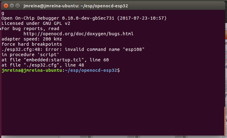

I am getting started on my ESP32 development and have just installed OpenOCD. I can't seem to access to esp108, see attached. What is the issue here, how to resolve? I am guessing it is not built in the OpenOCD directory (~/esp/openocd-esp32/), or it is not on PATH.

Re: OpenOCD installation issues, can't find 'esp108'
Hi justinmreina,
I do not see the command you have used to call OpenOCD. It should look as follows:
You may need to adjust configuration files after "-f" to match your specifc h/w.
If done correctly you should see:
$ src/openocd -s tcl -f interface/ftdi/esp32_devkitj_v1.cfg -f board/esp-wroom-32.cfg

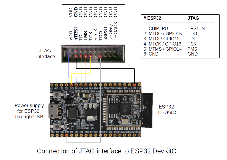

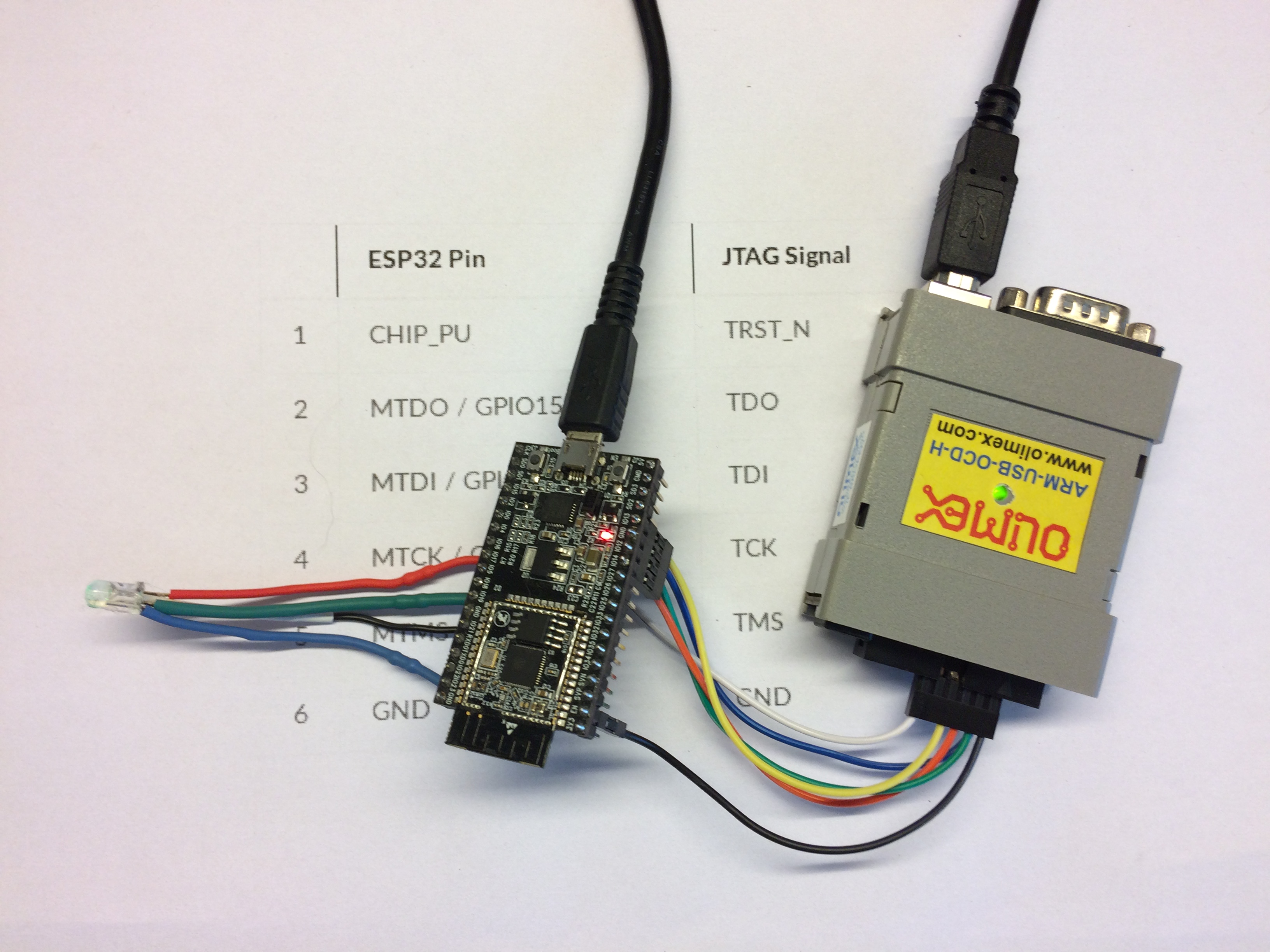

HI justinmreina,
You are clearly almost there.
I am not sure about wiring:
1. I would not connect 3.3V between ESP32 and Segger J-Link. ESP32 should be powered through own USB
2. From the pictures you posted it looks like one of lines is connected to GPIO27 while GPIO12 is not connected
Please see below set-up that I have just tested and works correctly.
All wires are about 10 cm long. In fact in this setup it is working with "adapter_khz" at 26 MHz that is maximum discussed in documentation. I have tested it for about 2h transmitting application traces as described in http://esp-idf.readthedocs.io/en/latest ... trace.html
justinmreina
- Posts: 71
- Joined: Tue Jul 18, 2017 10:39 pm
- Location: Snohomish, WAt
- Contact:
It works now, thank you!! It did require connection of VCC to the JTAG for successful connection, and then ready to go!
That graphic you shared, wow this is good content. I've encapsulated it into my wiring write-up, quite useful here see attached!
