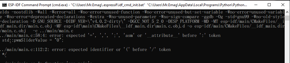

Re: How to use strings in esp idf?
Hello
this don´t work at all:
#include <stdio.h>
std::pwmSliderValue = "0";
I am unable to call these functions.
#include <string>
#include <iostream>
#include <stdio.h>
#include <string>
#include <iostream>
- Capture.PNG (27 KiB) Viewed 26956 times
You are compiling main.c, which is a C source file. You should rename this to main.cpp (and update your CMakeLists.txt or Makefiles accordingly) to have the tools recognize this as a C++ source file and compile it using the C++ compiler.
BTW, it's a lot easier to read the error messages if you cut and paste the text instead of posting a screenshot.
