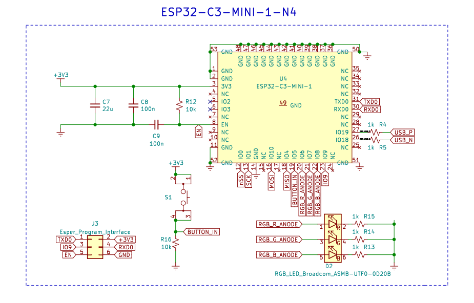

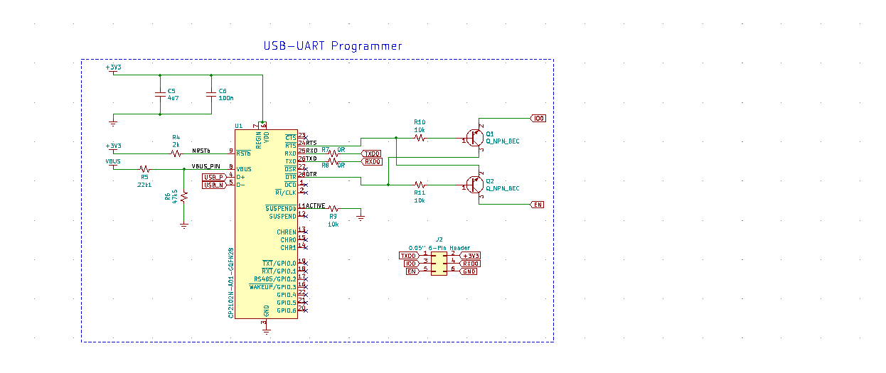

I am trying to program ESP32-C3-MINI-1-N4 using a CP2102N based programmer, and I have failed to program even after using up 7 different modules, and tried quite a lot of things.
- I have used a stencil to put solder paste and used a reflow oven to solder it
- I have also tried hot air gun to solder the module on the PCB
At this point, I am very confident that I have soldered the chip correctly on to the board, and I am also using the reference schematic from the devkitM board for the custom PCB.
My programmer is not able to recognize the ESP32-C3-MINI-N4 module, but when I wire 3V3, GND, GPIO9, EN, RX, TX on DevKitM, it is able to recognize the chip. I have also tried directly soldering the ESP32-C3-MINI-N4 module to the wires of the programmer without a PCB. No luck.
At this point, I feel like I have no other options I can trying out right now, and I want to reach out to the community to see if anybody was able to get the ESP32-C3-Mini-1-N4 working on a custom PCB, and soldering process they used, and has any idea what I am doing wrong. Happy to share schematics and board layout.

I have attached the schematic of the programmer and the esp32-c3-module on the custom PCBleads me to think you may have mis-interpreted something in how to hook up that module, as in, it may not be your soldering process at fault. Can you share your PCB / schematic here?

Re: Not able to program ESP32-C3-MINI-1-N4 on a custom PCB board
I've used an AI Thinker ESP32-C3M module. Ref the AI Thinker datasheet schematic it had IO8 internally pulled up to VCC as bootstrap requirement for spi boot.
You have IO8 going to the LED anode, maybe it is a bootstrap issue.
Thanks for all the responses. I was able to figure out the issue.
@ESP_Sprite based on your recommendation, I used a logic analyzer, and found out that the ESP32-C3 module was "Waiting for USB Download", while I was programming through serial. Thanks @pataga for your recommendation to look into GPIO8, I was able to fix the issue by pulling up GPIO8 with a 10k resistor.
