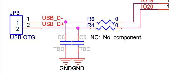

The ESP32-S3 datasheet shows following
Screenshot 2023-03-19 at 19.31.18.png (30.71 KiB) Viewed 8174 times
What should be the values of those registers and capacitors?

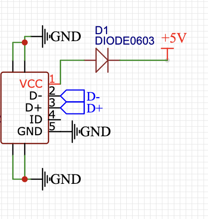

"No device shall supply (source) current on VBUS at its upstream facing port at any time. From VBUS on its upstream facing port, a device may only draw (sink) current. They may not provide power to the pull-up resistor on D+/D− unless VBUS is present. When VBUS is removed, the device must remove power from the D+/D− pull-up resistor within 10 seconds."
For this can I just add a diode like this.
That just looks like placeholders designed in to keep options open for tweaking the pcb if necessary for signal integrity issues. It has nothing to do with the issue I commented about.
"No device shall supply (source) current on VBUS at its upstream facing port at any time. From VBUS on its upstream facing port, a device may only draw (sink) current."
For this can I just add a diode like this.Screenshot 2023-03-19 at 19.41.34.png
A diode will indeed prevent backfeeding power to USB VBUS (whenever your device is powered via alternate means). Of course do be mindful of the voltage drop across the diode when USB is being used to power your device.
