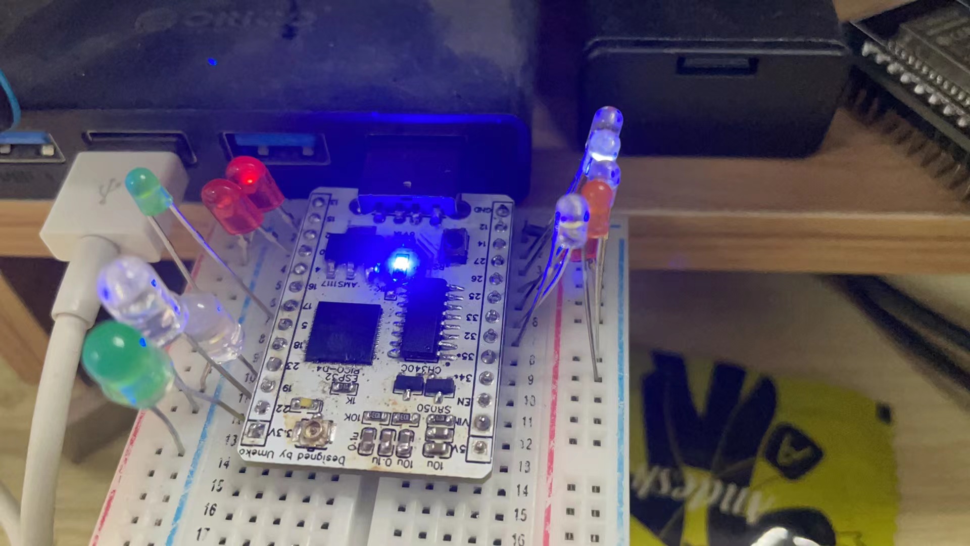

I designed my ESP32 Pico-D4 PCB board days ago. After completed it actually, I tried upload programs and test its functions and seems everything was good, until I used GPIO 17, attached a led with GPIO 17 and GND, The CPU begin to inffinity reboot and logging errors, errors were:

If I disconnect the led it won't reboot. Similar problem happens with GPIO 16, No error logs but led in GPIO 16 won't work.
Otherwise, I tried using UART2 which default Pins are 16 and 17. Then the cpu start to reboot with another errors:
Code: Untitled2.txt Select all
rst:0x7 (TG0WDT_SYS_RESET),boot:0x13 (SPI_FAST_FLASH_BOOT)
flash read err, 1000
ets_main.c 371
If I switch UART2 Pins to 13 and 15, The CPU works normally without any problem.

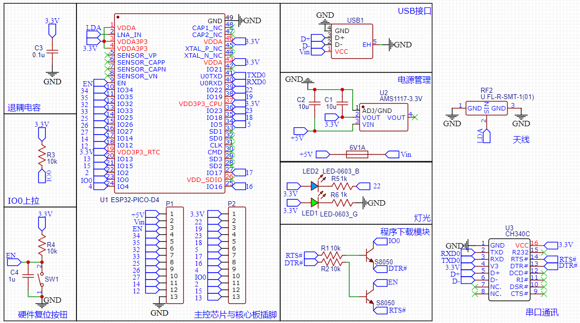

This kind of problem really comfused me ! Have someone encounted same problem?
Here's the blueprint of my PCB and the photo of my board.

Ref PicoD4 datasheet, end of chapter 2.2:
Pins IO16, IO17, CMD, CLK, SD0 and SD1 are used to connect the embedded flash, and can not be used for other purposes. For details, please see Section 6 Schematics.
